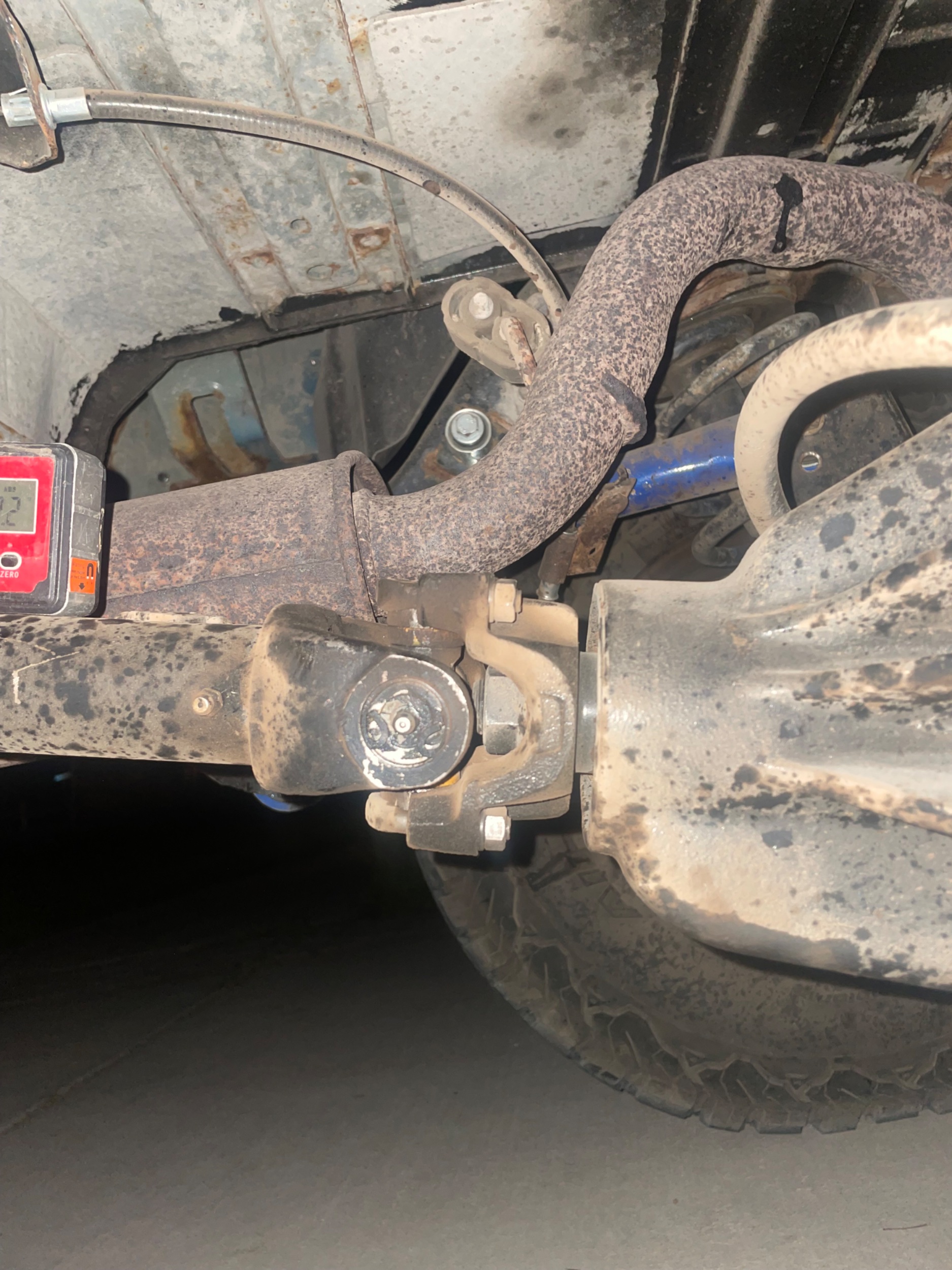

adjusted driveline angles and got it through emissions and safety inspection. I I am at 1 degree nose down on the rear pinion from driveshaft angle one degree up on the front. I need to go a bit more to get it to stop vibrations at 50-70 mph. `220 miles on this transmission and 3rd syncro definitely has a problem, was only grinding downshifting from 4th, now up from second too, not even fast shifts, just a smooth shift.
Took the rear shaft to 3 degrees at ride height and it has less vibration, at full droop it has 5-6, if I fill the tank, put the back seat in I think it will be right at 2. I am going to pull the front shaft to make sure it’s good. I actually like the way the jeep drives and handles. The Durango calipers will lock up the 33’s if I have to panic stop. The atlas is working great. Almost 220 miles on it. 3rd syncro is toast, so almost there. I want to finish dialing in as much as possible before I yank it again.
