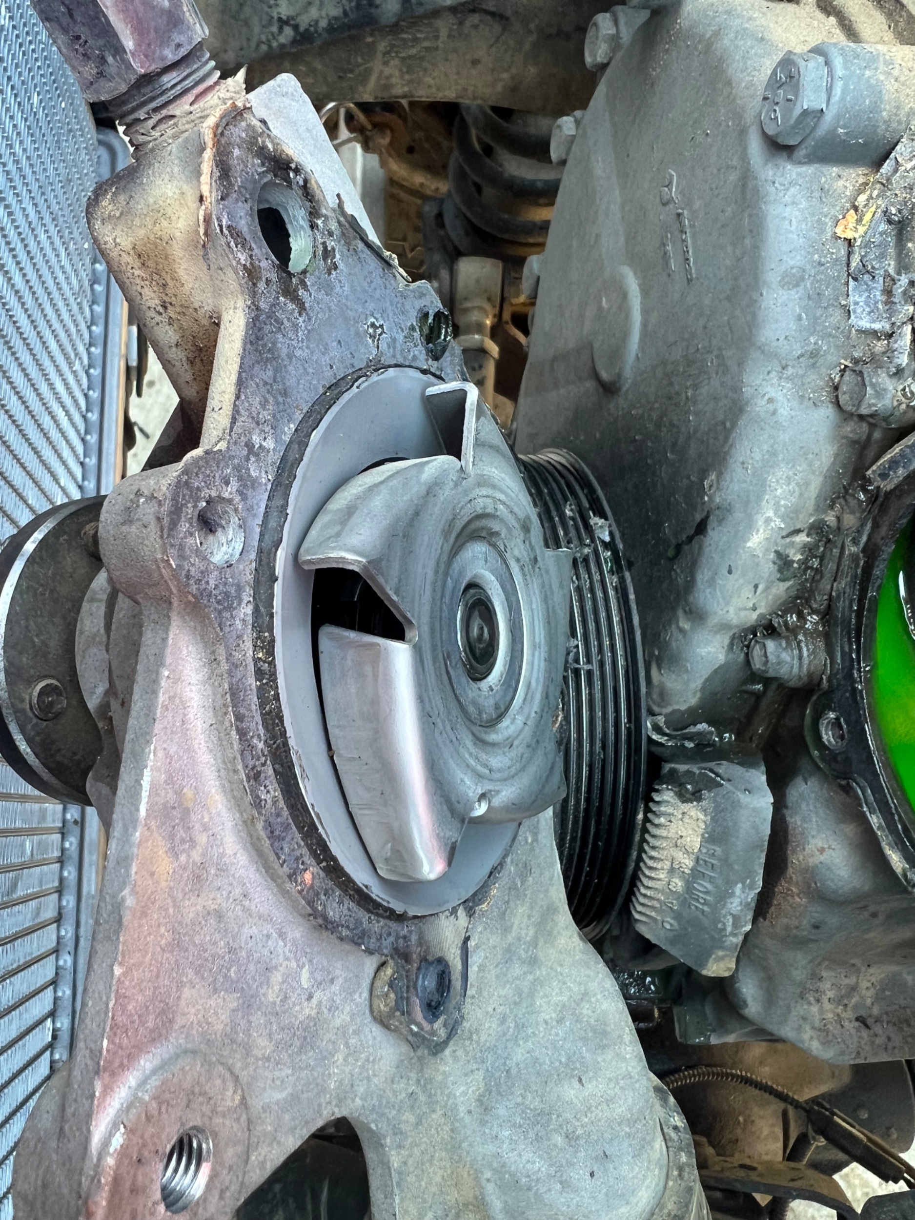

Good call. Just was reading through the overhaul thread on here and someone mentioned that. I guess I’m draining my tank. Bought a cheapo AC Delco water pump to swap in before I spend some big money. Also going to pull the thermostat when I do that tomorrow.

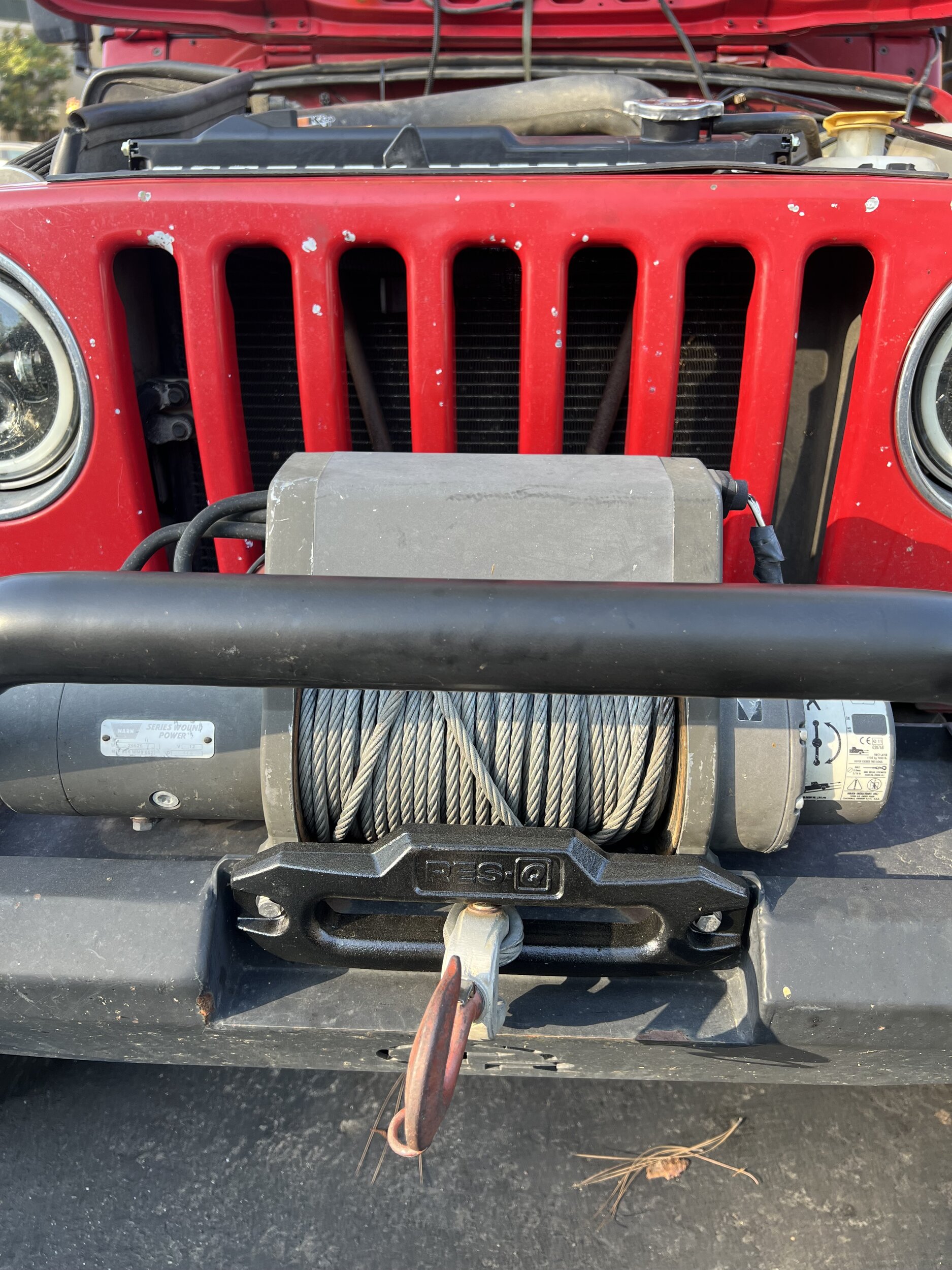

Once again wanted to add more pictures of the winch blocking half of the grill. My mechanic swears this is the issue lol.

Interested to hear what your mechanic said about the no winch test failing since that was a given.

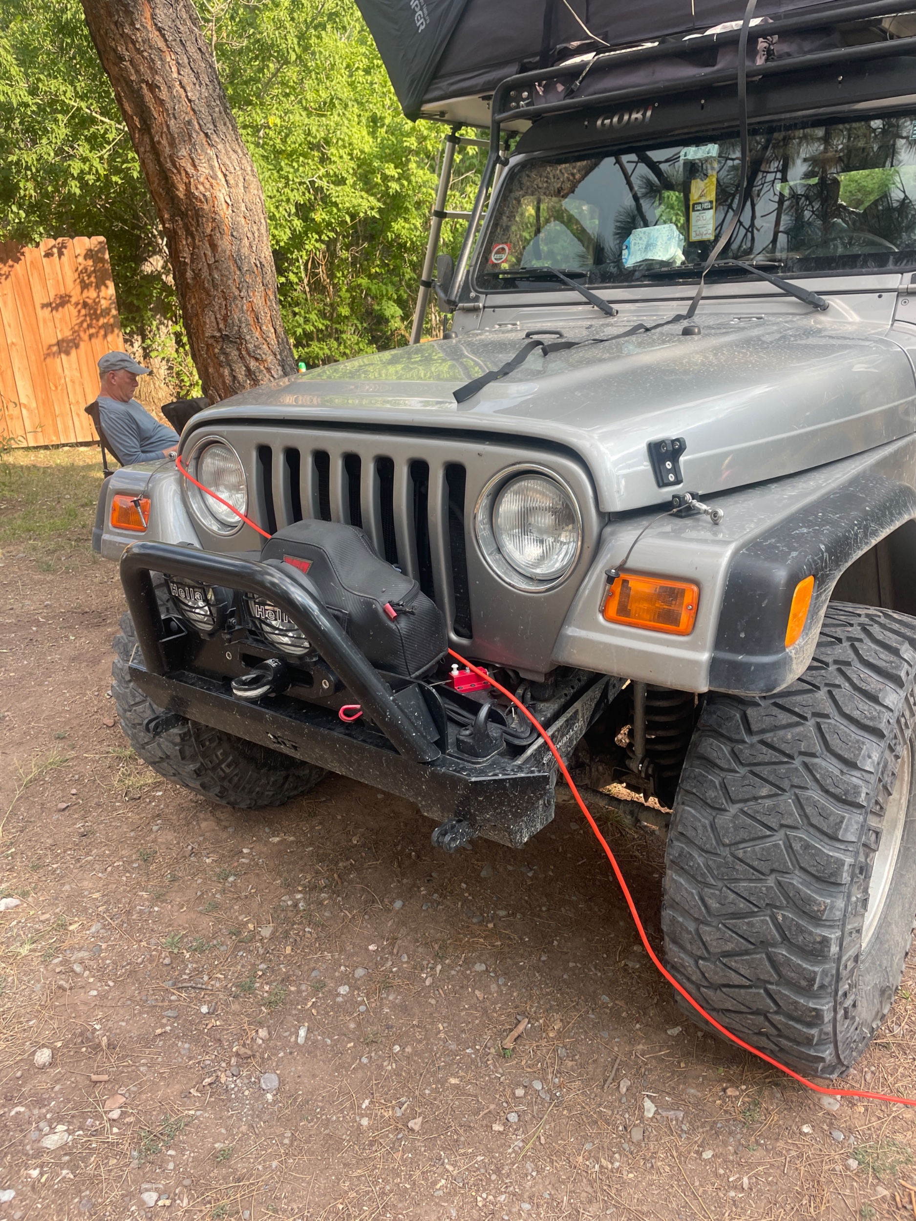

A perfect example of why my winch should have never been the issue my mechanic thought it was…
Yes,and my winch covers more than yours did.I had a car do the exact thing when I was younger,would heat up on hwy,I even ran a 2nd gauge in the head,it was an auto zone thermostat that I had put in (changed to 160) so it would run cooler(lol)went to dealer problem solved.

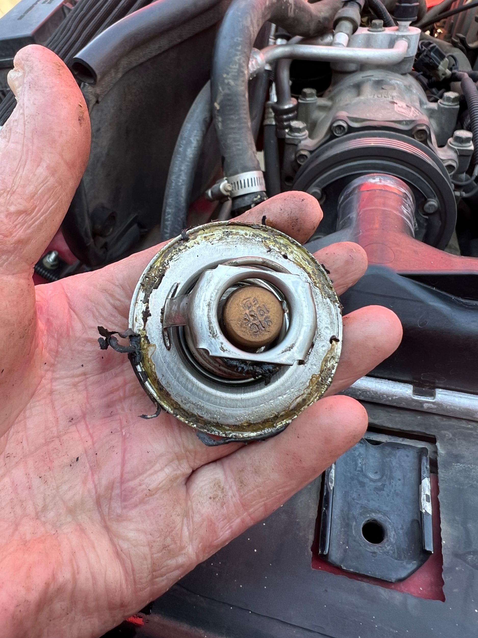

If you are making the effort to change the water pump, then I highly recommend also changing the thermostat. You heated your current thermostat up to temps that caused my thermostat to be stuck closed.
Reactions: Dvaniwaarden11
I have been telling him that for a week(lol)it could be that simple.no sense spending a lot of cash until you try a quality thermostat with the hole at 12.00 o’clock

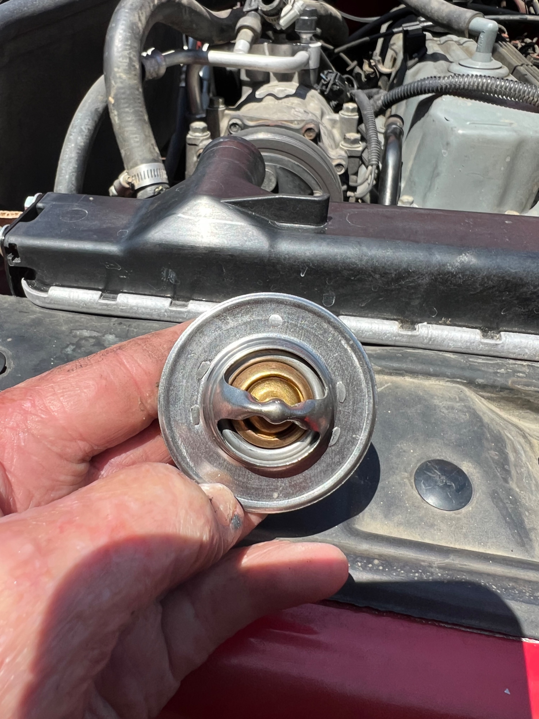

Swapped the thermostat out, drilled the hole as I’ve read about on this forum, replaced the water pump with a AC delco pump. Hooked everything back up the way it was, and burped the lines so I had no air in the system. Took it for a test drive, no leaks but still would run hot.
Clutch fan is new and everything else has been replaced in the last 2 weeks. I flushed the system today too. No gunk behind the old thermostat, no gunk behind the old pump. Everything looked great.
