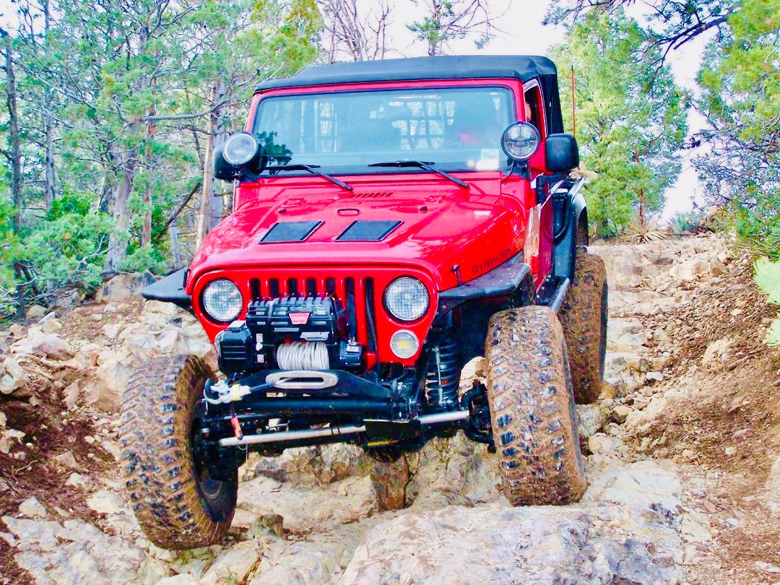

When I did it the only thing I did was the fan blade and the fan clutch. I did not do anything else...no doubt I did have a cheat:
I got a hold of 2 hood vents that came off some car, forgot what it was, some being sold by the big 3 with a Supercharger or maybe a turbo, what ever it was an OEM a current production car.
In the pic you will see the 2 vets I placed over the rear edge of the radiator and extended back over the nose of the 4.0. This was post fan blade/fan clutch because at long idles in off-roading, it began to heat up will into the upper temps.
This solved my problem and did I have one. I was no able to even drive on to the freeway in Phoenix and Scottsdale with harsh pinging...even with higher octane.
I had this setup done and when Warn came out of the PowerPlant winch/air compressor, 4 wheel parts contacted me and asked if I could test the Powerplant winch for overheating. I agreed and spent a lot of time in Phoenix Rush hour traffic, at idle and AC on. Never had an issue and I maintained the normal operating temp. I forwarded the results to 4 wheel and they sent it to Warn.
Sadly I did not get the PowerPlant as a gift but I was able to get a great price on it, 50% off 4 wheel price...I still run that Powerplant today on my F 450 Truck and its still working.
