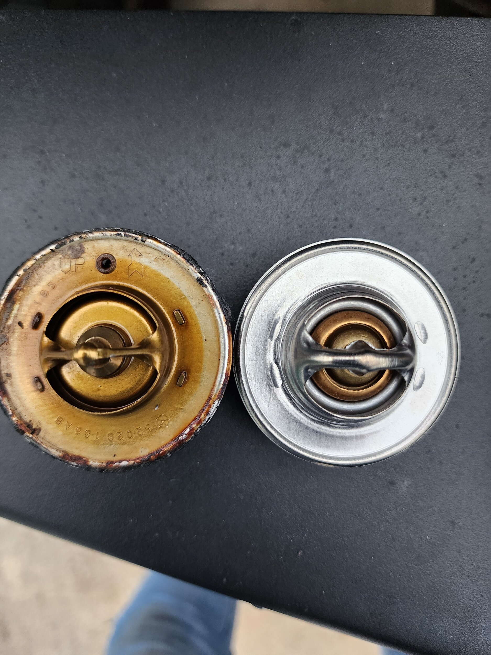

Everywhere but more so on highways, I think the culprit was the thermostat. If you install a new one, open a 1/8 hole just above it. I will attach a photo of when I made my change, where the hole was.
What is the purpose of the drilled hole?
To allow trapped air out.
Not all thermostats need the hole drilled.

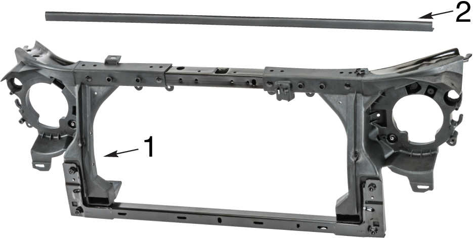

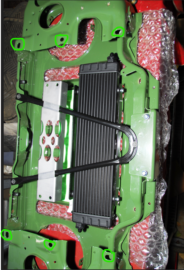

Unfamiliar with the term core support. Are you talking about insulating below the radiator?
The core support is the piece that is behind the grill, The headlights, radiator, and hood safety latch attach to it, Just make sure there are no gaps between it and the radiator, That way all the air going thru the grill is going thru the radiator and not around it.
Nope, in this case, the grill shell is the core support. It is a unitized structure in the TJ. Circled holes are where the radiator mounts.
