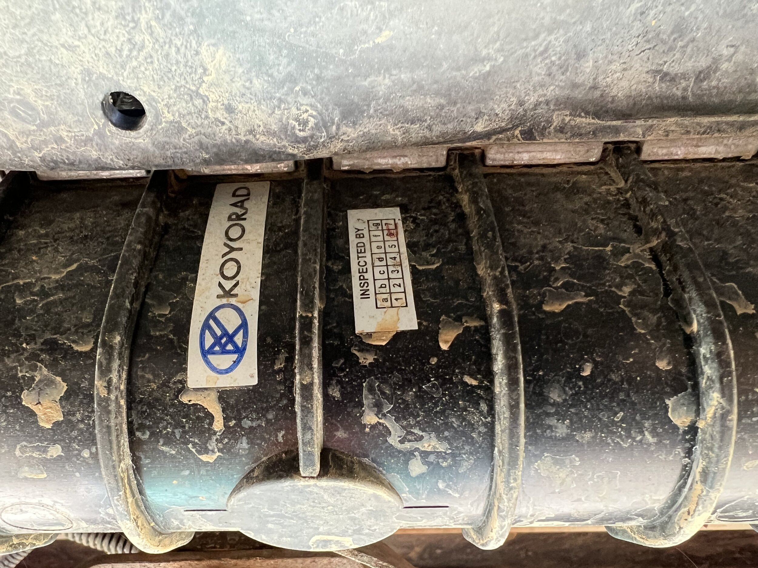

So to update, took my jeep to my mechanic that did the engine swap. Had him put a denso radiator in at no charge to me, but nothing changed. He took it for a test drive and the engine still gets hot under heavy load and moves into the 240 range. Lifting on the freeway allows the temperature to go back down. No overheating on the side streets, no overheating in stop and go traffic.
Overheats on the freeway after 20ish minutes and overheats when trying to climb a long hill. I'm at a complete loss for what to do next. Mechanic has no idea where to go with it and only references the bigger tires and winch blocking grill but this makes no sense to me.
Anyone have any new ideas?
