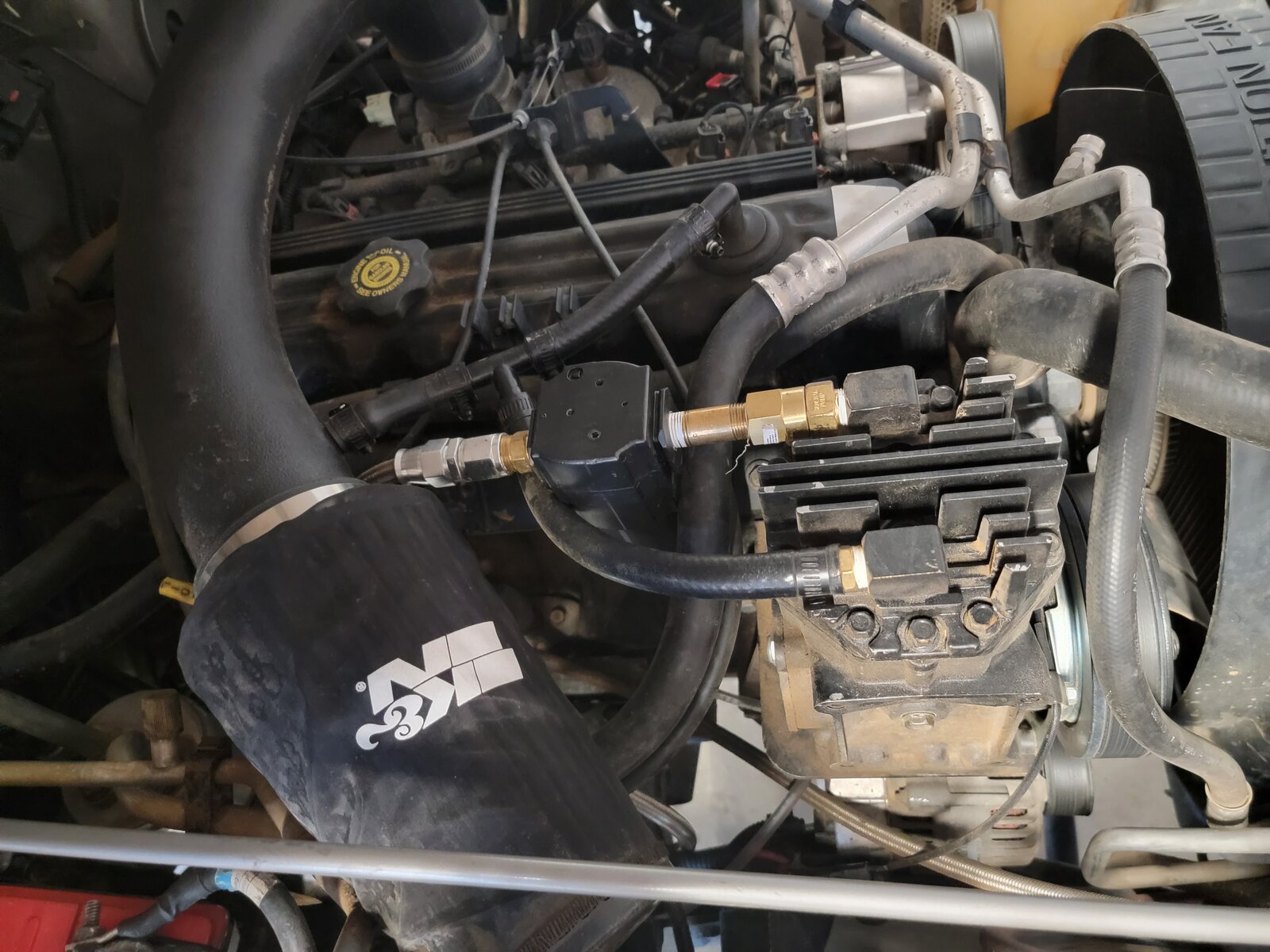

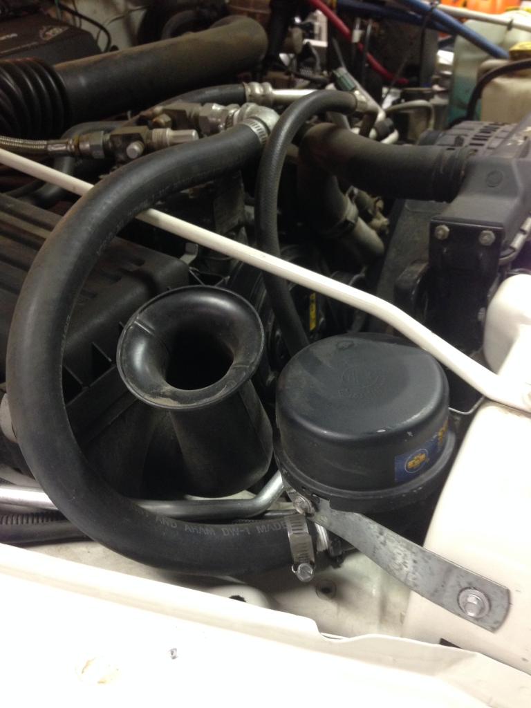

I trimmed my tube and it was a constant diameter. You can see where I put it in the first photo I attached in this thread.

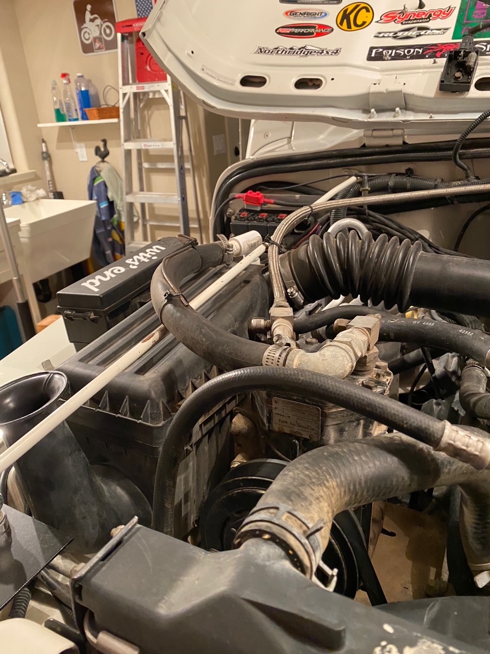

Mine still spits a little oil and it’s one of the newer compressors.
Having two places to fill at is a good idea but I think the front and rear like @Plumber1 is more versatile.

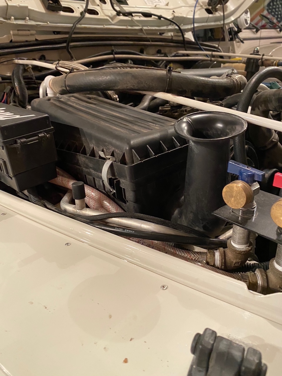

I used the kit as it came but added an oil catch to mine since it was spitting some oil. From there I ran a hose down to the bumper to make a remote fill location.
Did you have to do anything to support the KN intake? In your picture it appears to only be clamped to the throttle body but trimmed too short to be zip tied to the grill support rod. Maybe it is light enough not to need additional support?

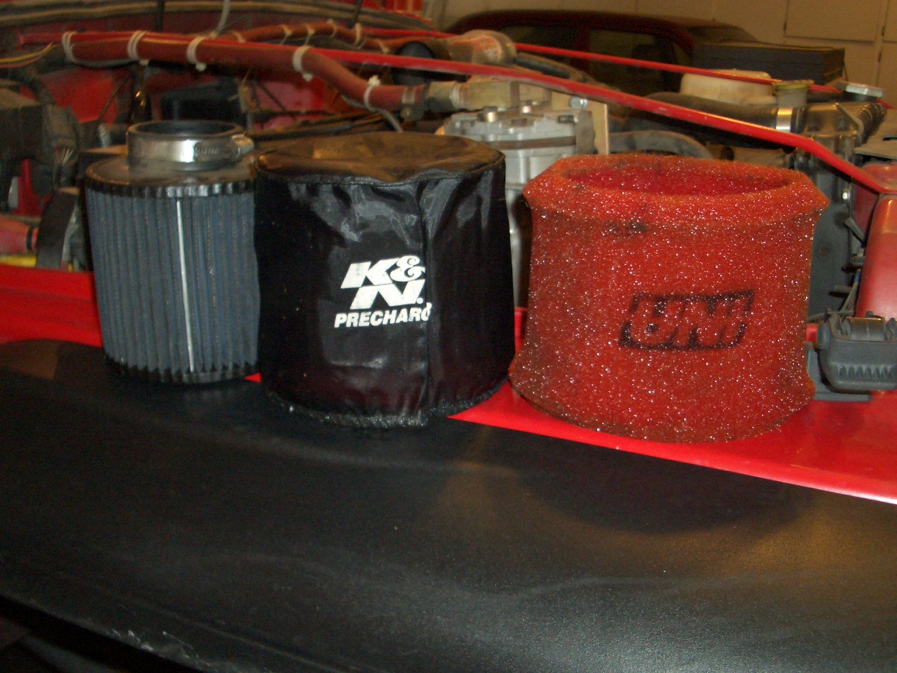

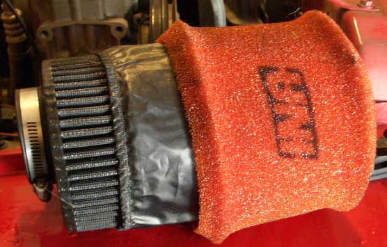

I installed a K&N many years ago and it sat fine on the air intake tube without further support. That said, a K&N air filter is a REALLY shitty air filter, it barely filters at all. I ended up installing TWO pre-filters over the top of the K&N so it would at least do some filtering.
This is what I did to mine, they are pulled up on the K&N so you can see how they are layered. A foam Unifilter covered by a K&N Precharger. I had first installed the K&N Precharger but it was so bad at sealing and keeping the dirt from getting in from the side that I added the Unifilter over the top of it to hold it down.
I did make a support. It's attached to the tube under the worm gear and bolted to the fender (I believe). I'll try to remember to get a shot of it later tonight.

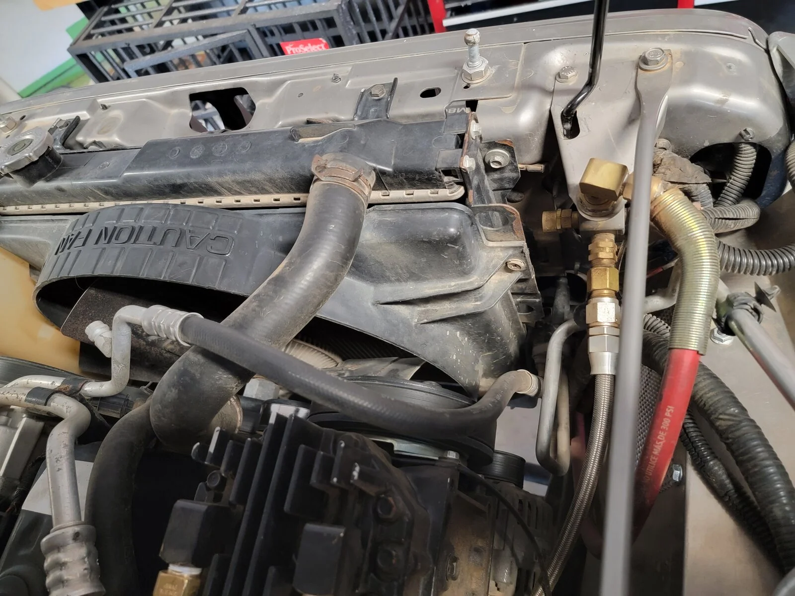

i switched to the windstar intake to have more space for my york and keep my k&n tube and filter for smog tests. i remove the windstar and put the k&n on in the parking lot, smog, then switch back.

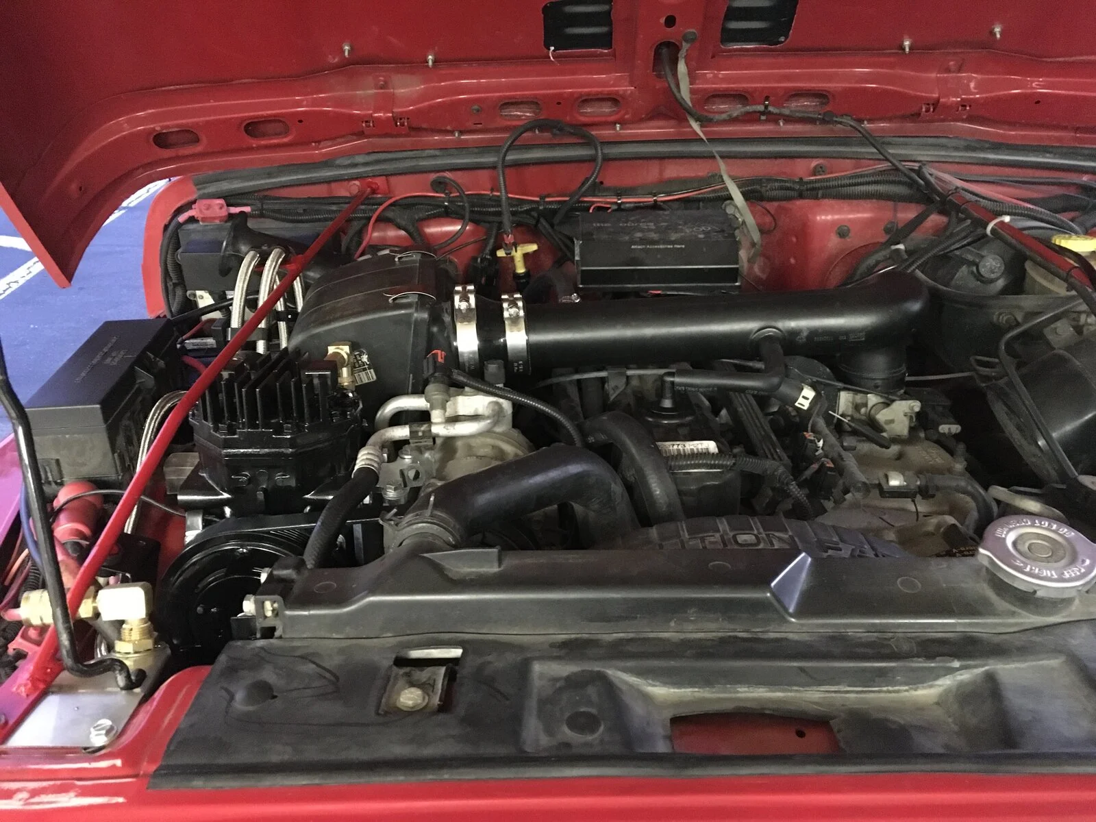

I replaced that K&N with a Buick 3.3 intake off a early 90’s Century and fitted it up to a trimmed stock intake tube.
The install did require trimming the inner fender a bit and making a new grill support rod.

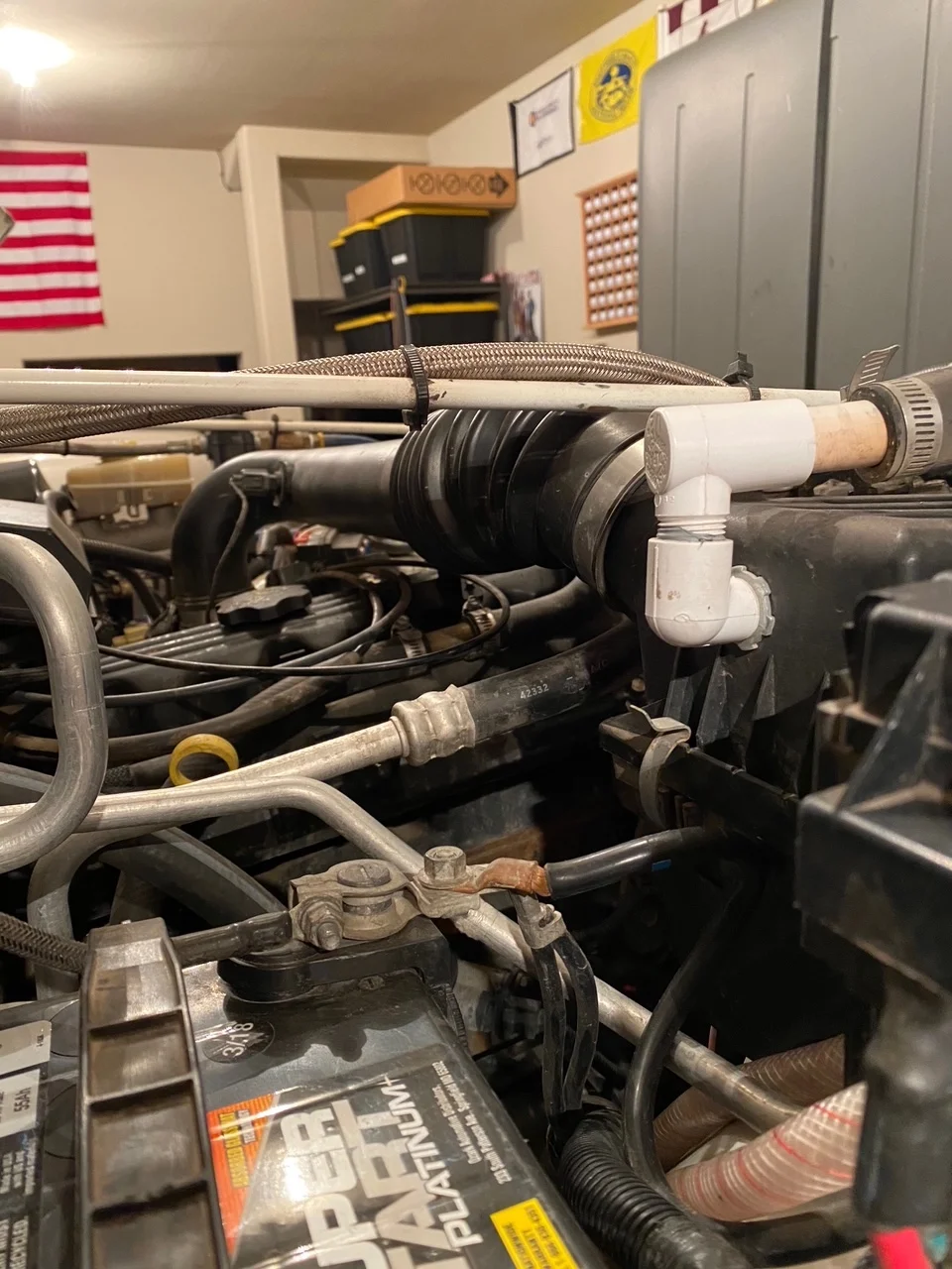

I also run a York I installed an outlet just under the headlight and a second just on the inside the rear driver side near the roll bar. I also added an inlet filter on the passenger side and then after adding my OBS I relocated it my drilling a hole in the engine air box so that filter is doing double duty
