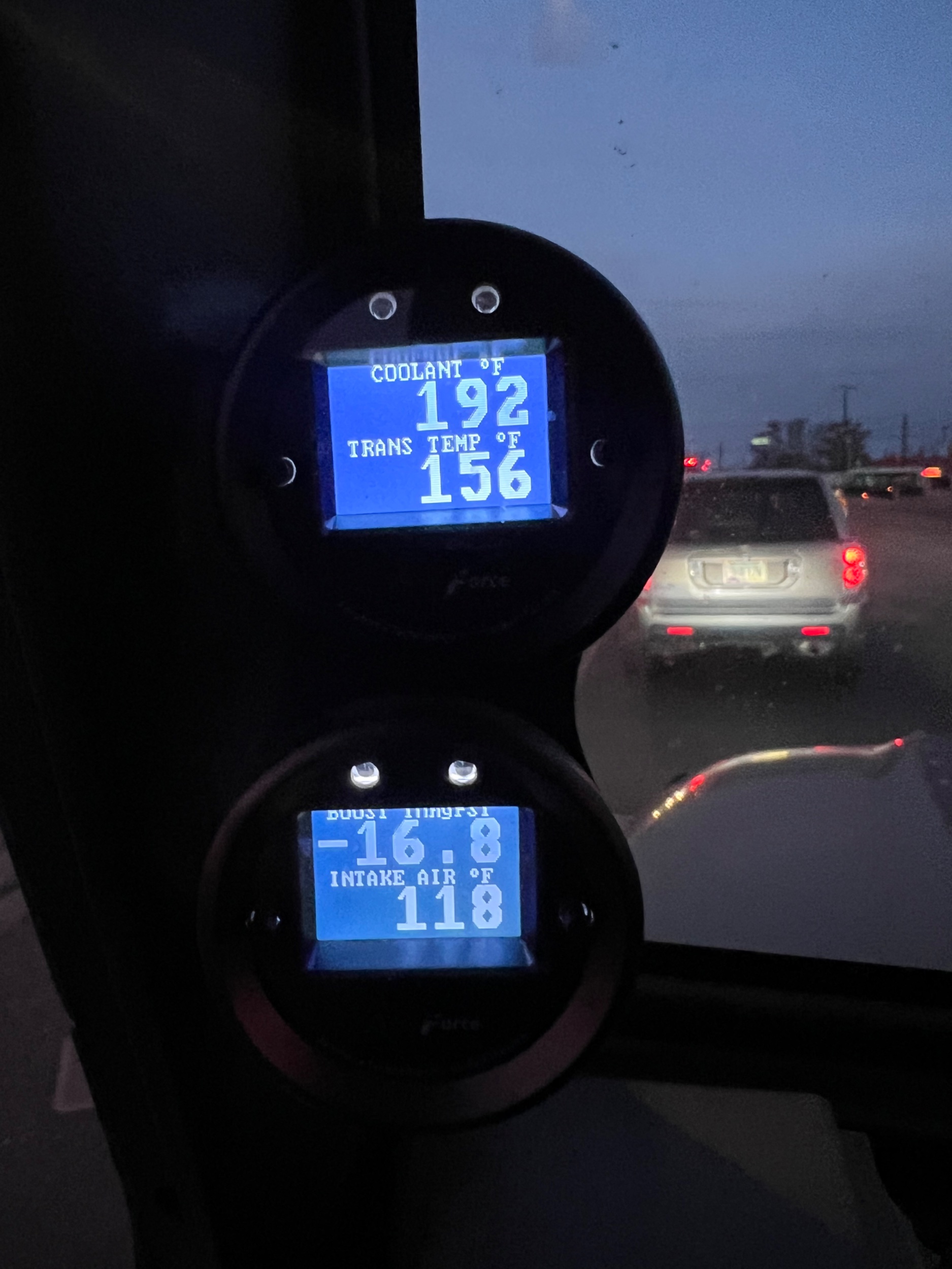

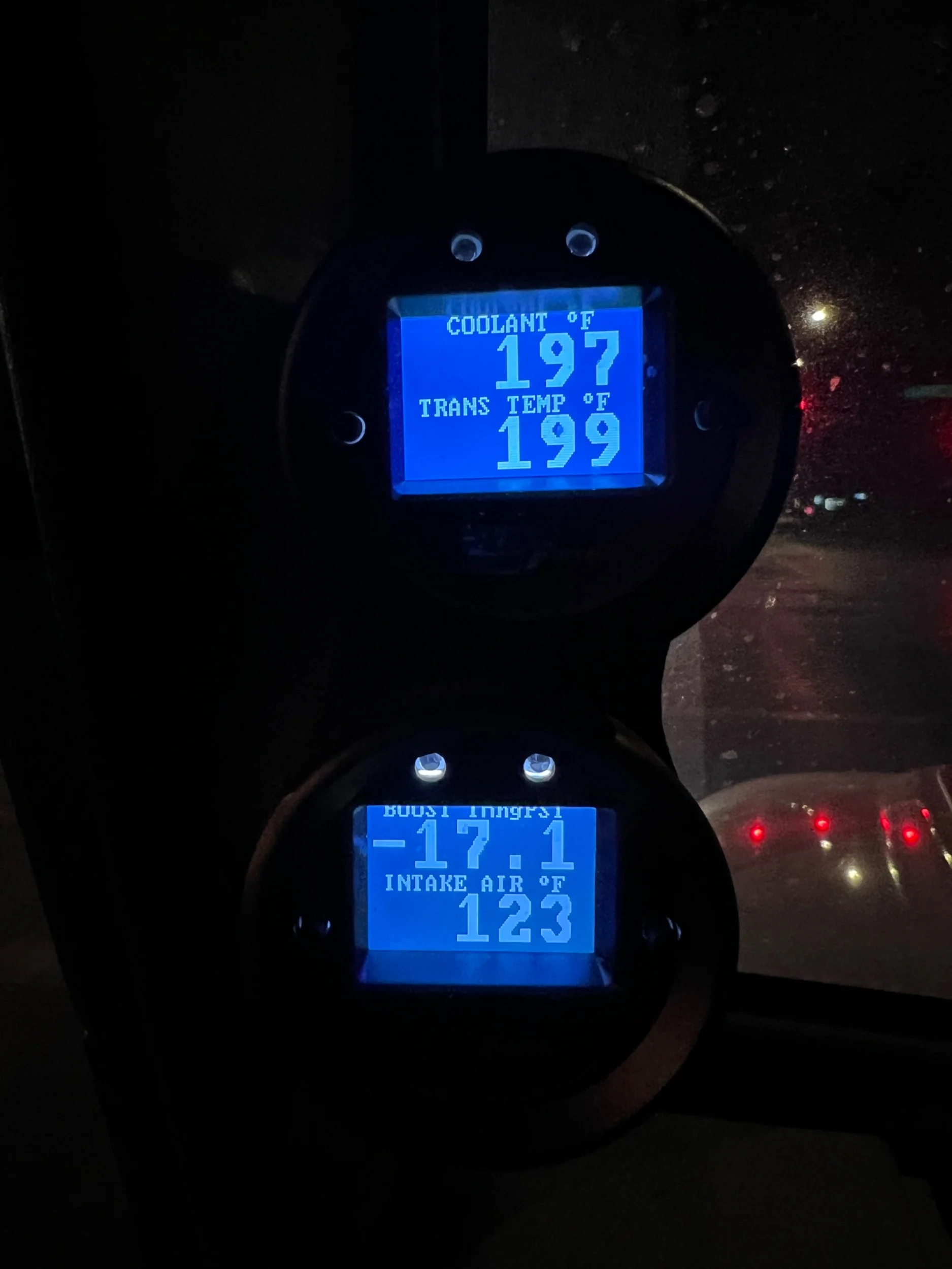

I’m doing a flush right now, so this gave me a chance to share my temps driving through town this evening with the thermostat removed.

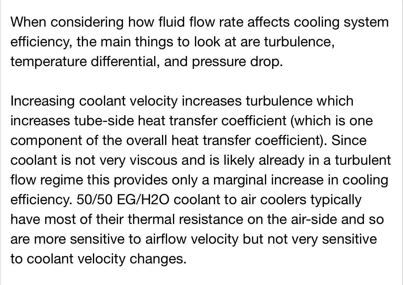

Also, I found an interesting take on the cooling conversation (that is well above my head). The thread also mentioned that dwell time is a myth. I’ve seen similar posts but they used the word effectiveness for the temp differential.
