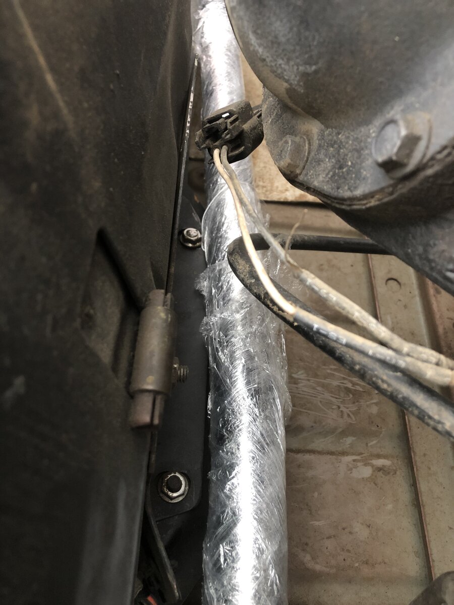

The Core 4x4 is their Tier 4 version. It has JJ on both ends. It is 1.5" OD compared to the Currie at 1.25" OD, so 0.125" wider on each side. It appears well built and the packaging was absolutely wonderful. Nothing could mess it up in transit. Molded foam packaging and bubble wrapped around the bar inside with cellophane holding it together. Pain to get into. 🤣 I got it in charcoal color.

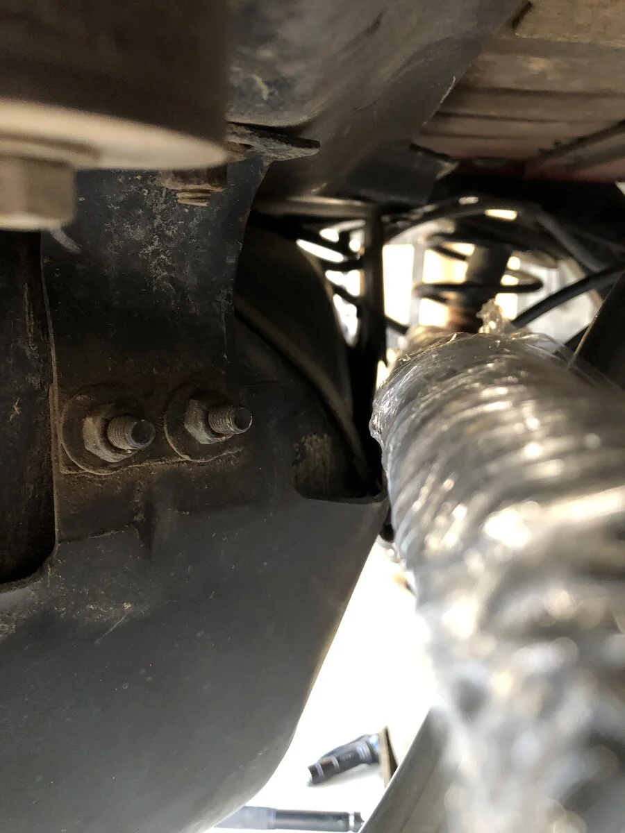

Bend of the bar compared to my JKS and a mocked up version without the bar bend from the end @Wildman gave me to test out.
I pushed my wheelbase out with upper and lower CA's to 93". I'm clearing the gas tank skid at ride height, but I still need to cycle the suspension to see where I am at full bump.

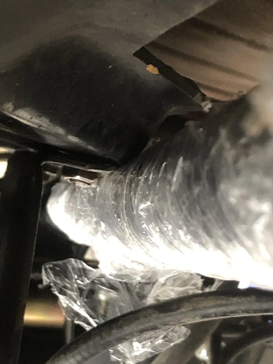

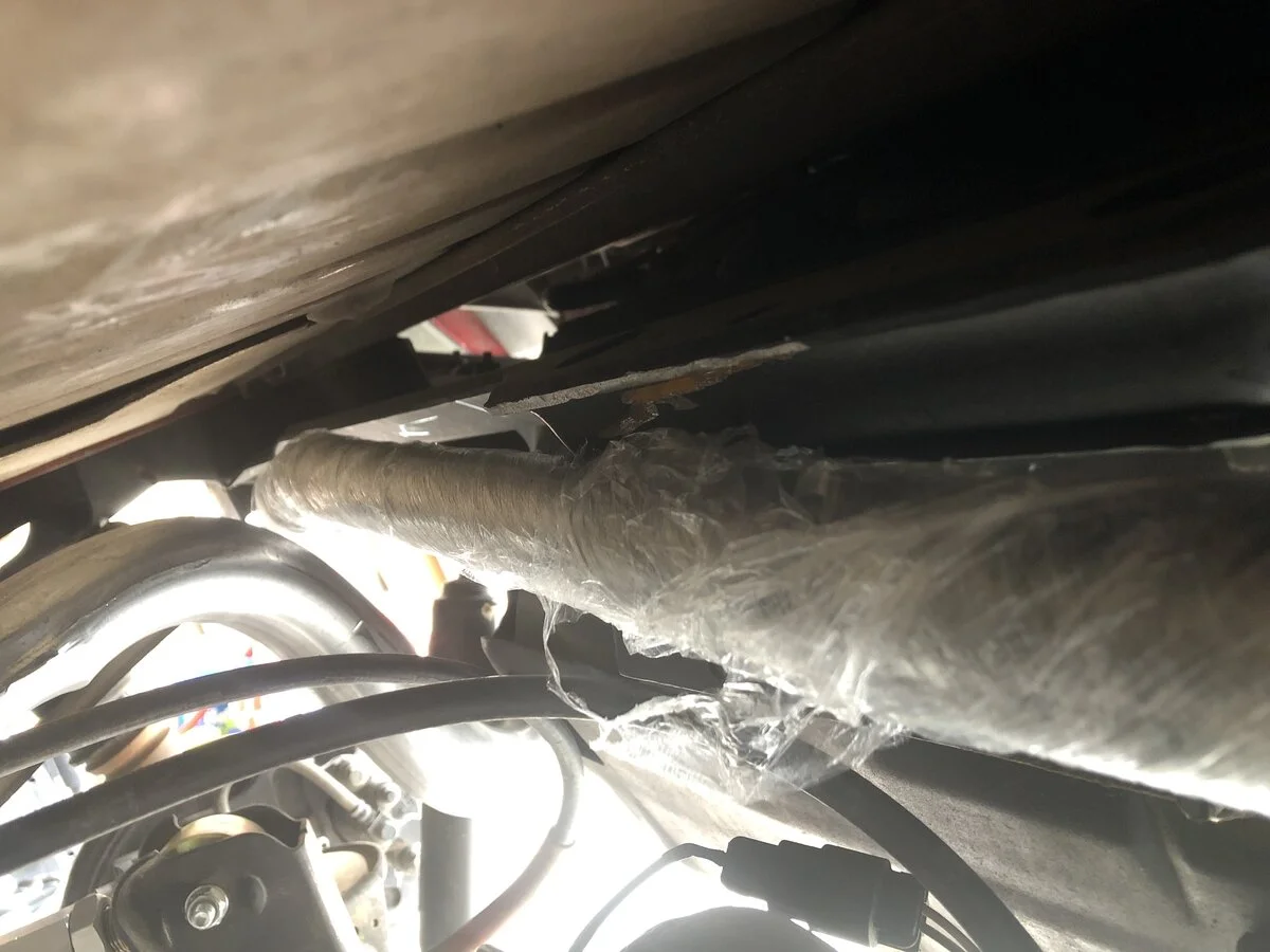

Here’s what I’m looking at at full bump on the driver side. Passenger side clears. Full 93” wheelbase. Do you think I should cut that crossmember?
I think from looking at those pictures of the Savvy tank skid that might be the WHOLE ticket.

Been following as my rear JKS Trackbar (at full 2" bump) hits the savvy bolt (farthest passenger). With the core bar, did it push the bar out past those bolt spots? I don't think I can eliminate any additional bump so it's almost a moot point but don't like the contact.
No, it did not clear that bolt
