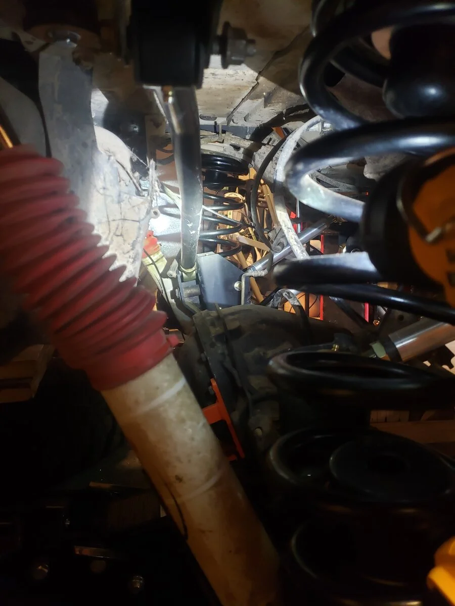

Here is my Currie rear track bar. This is at nearly full droop prior to dialing in pinon so it doesn't carry much valuable info but hope to get it set tomorrow and will post a pic. FWIW the stock bar was up against the tank skid.
What it does show is that the Currie bar is straight as it leaves the angled relocation bracket. That is helpful. The JKS one has a bend toward the gas tank skid.

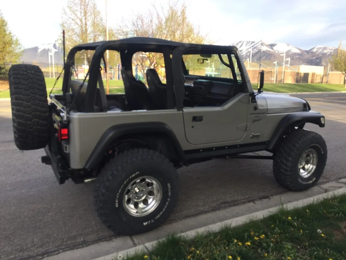

Core4x4 is just down the road from me. Stand-up guys, and a solid product. My wheelbase is a little skewed since I've done a front stretch. IIRC I'm at 96.5" and with my Rokmen Skid and F8.8 W/ Riddler diff cover, I am 1/4" between the diff cover and skid plate. I'll measure tomorrow how far it is back behind the cross member it bolts to. Sorry for the crappy picture, but its the best I have in it's current state.

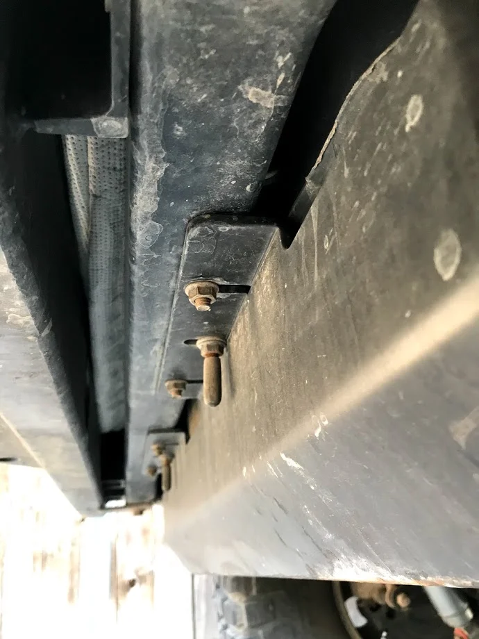

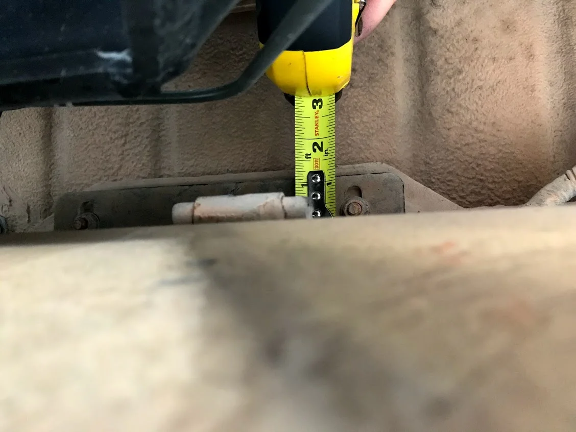

I got under the Jeep and measured the skid plate from behind the cross member. it sits 1.5" behind that crossmember, BUT it is moved forward 1.5" from the rear bumper cross member. If you were to push the whole skid back, I'd expect you could get 3" of clearance. I was not able to because it would be occupying the same real estate as my AntiRock.
