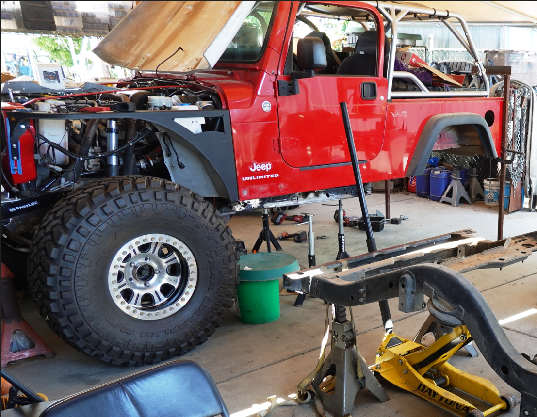

Yep raised body mounts have been sitting around for a while waiting for this. The 4 body mounts in the back will all be custom.Nice project. I’m sure you’ve got raised body mounts in there too or may already be done…looking forward to it all come together.

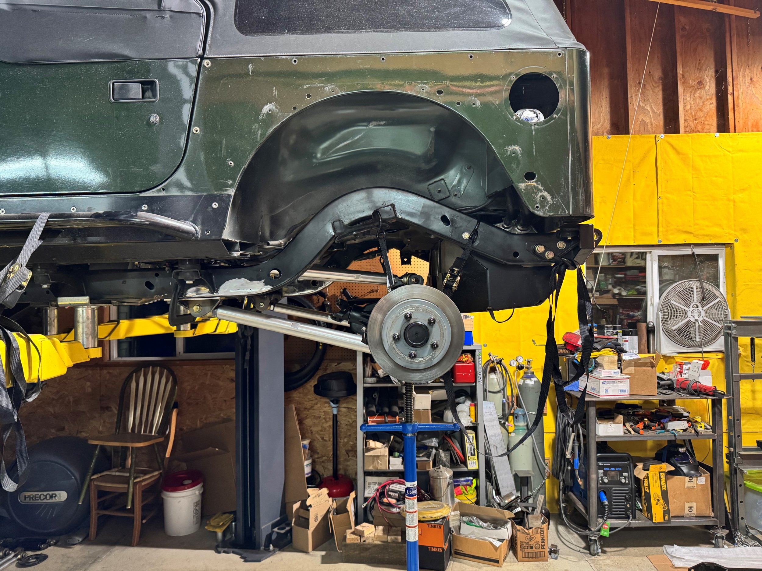

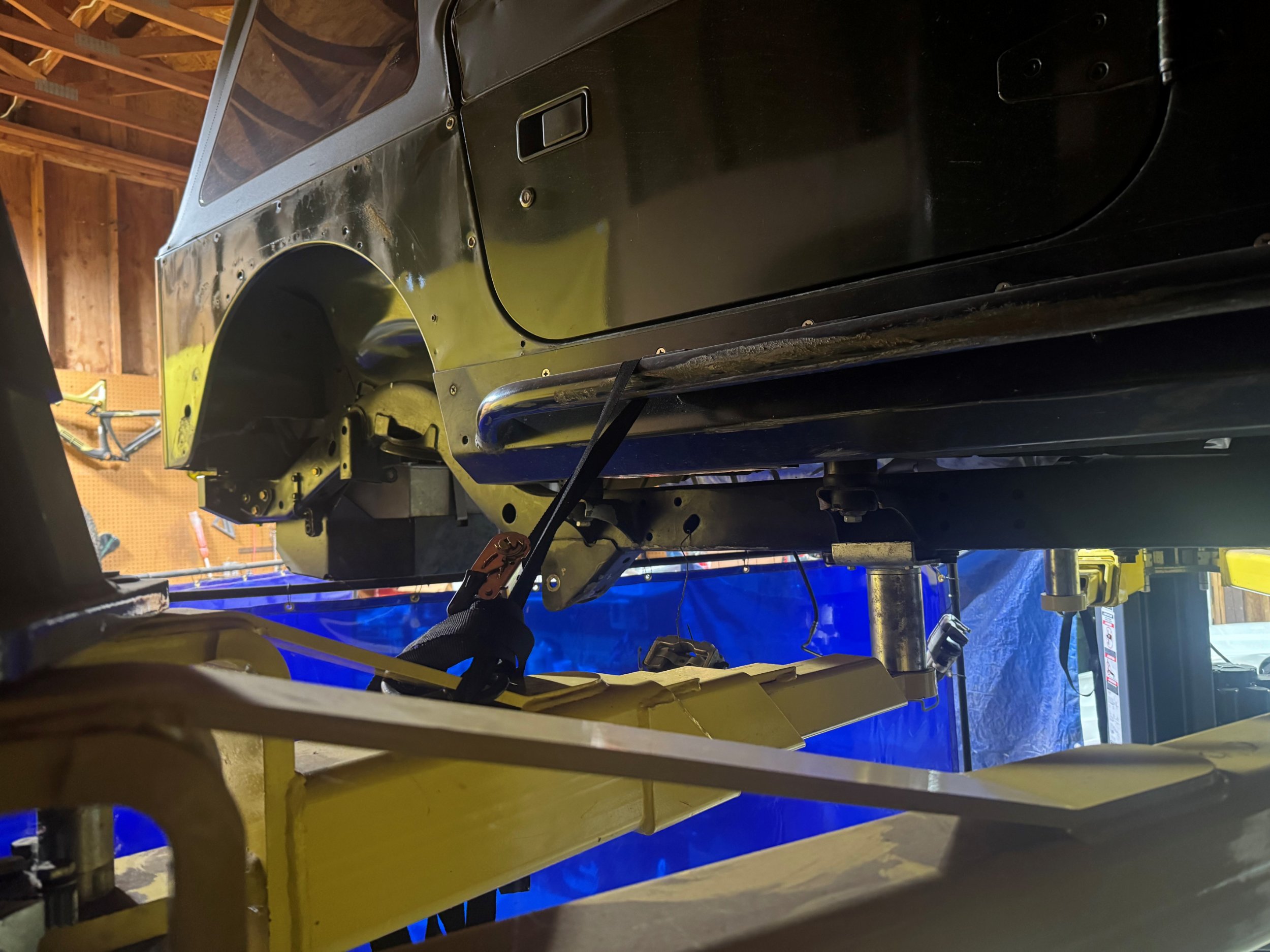

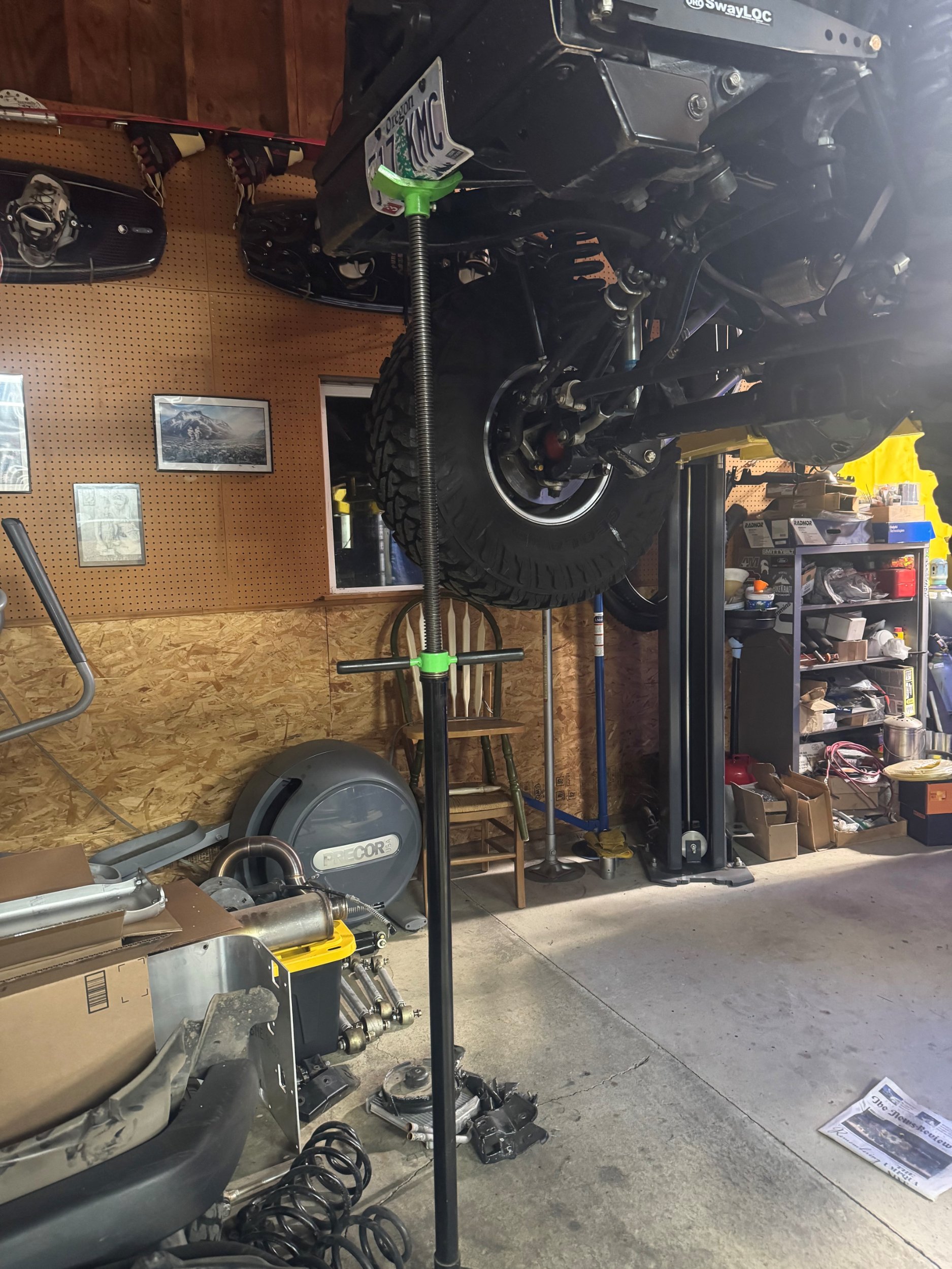

I am sure you probably have it already and I just don't see it but make sure that you have a way to hold the jeep down/up in the front and back while on the lift and everything removed from the back. I had to add an anchor in my floor to hold the front down since I couldn't have any stands aft of basically midpoint of the jeep when I removed the frame. I am very jealous of the lift!
Oh, yeah - this is great, and vital, advice. Woodrow, the lift pads on your lift are different than mine, so it may not work, but I keep a large C-clamp at each pad to lock the LJ to the lift:
The shortness of the TJ (which is even worse than my LJ) demands this because as you cut large, heavy pieces off, it will get "tippy." Having the rig fall off the lift would ruin your day!
{As Victor noted, you may have already considered this, so I apologize if you have and I'm in "Captain Obvious" mode...}
We all have our own sensibilities. Mine are centric to not losing location of components and being able to put stuff back exactly how it was removed after working on it and being able to compress the suspension to the limit for checking clearances.Absolutely. Good tip and I am aware. Without some additional support/tie downs, it would definitely fall forward off the lift. Tying it down was something Blaine mentioned as well. Currently I have a pole jack under the front bumper and two 800# straps from from the lift arms to the rails on my rocker armor. I did something similar when I had everything out a few years ago to clean up and paint the back half of the frame.

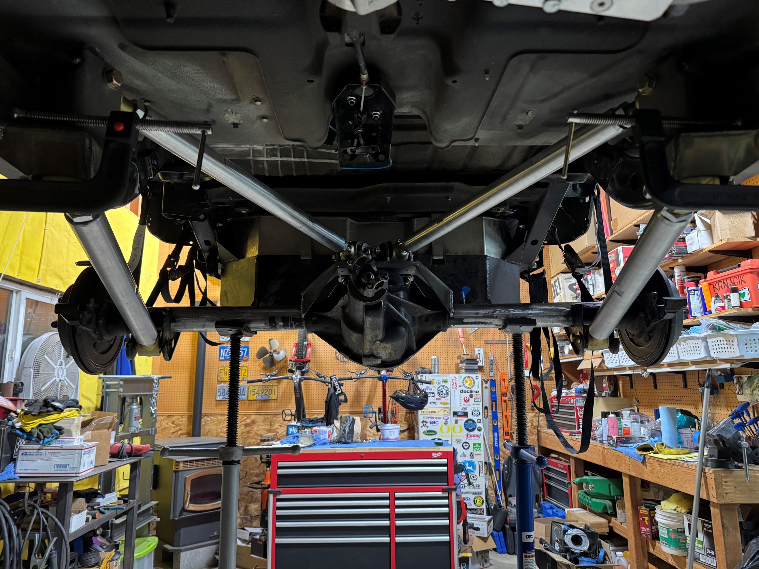

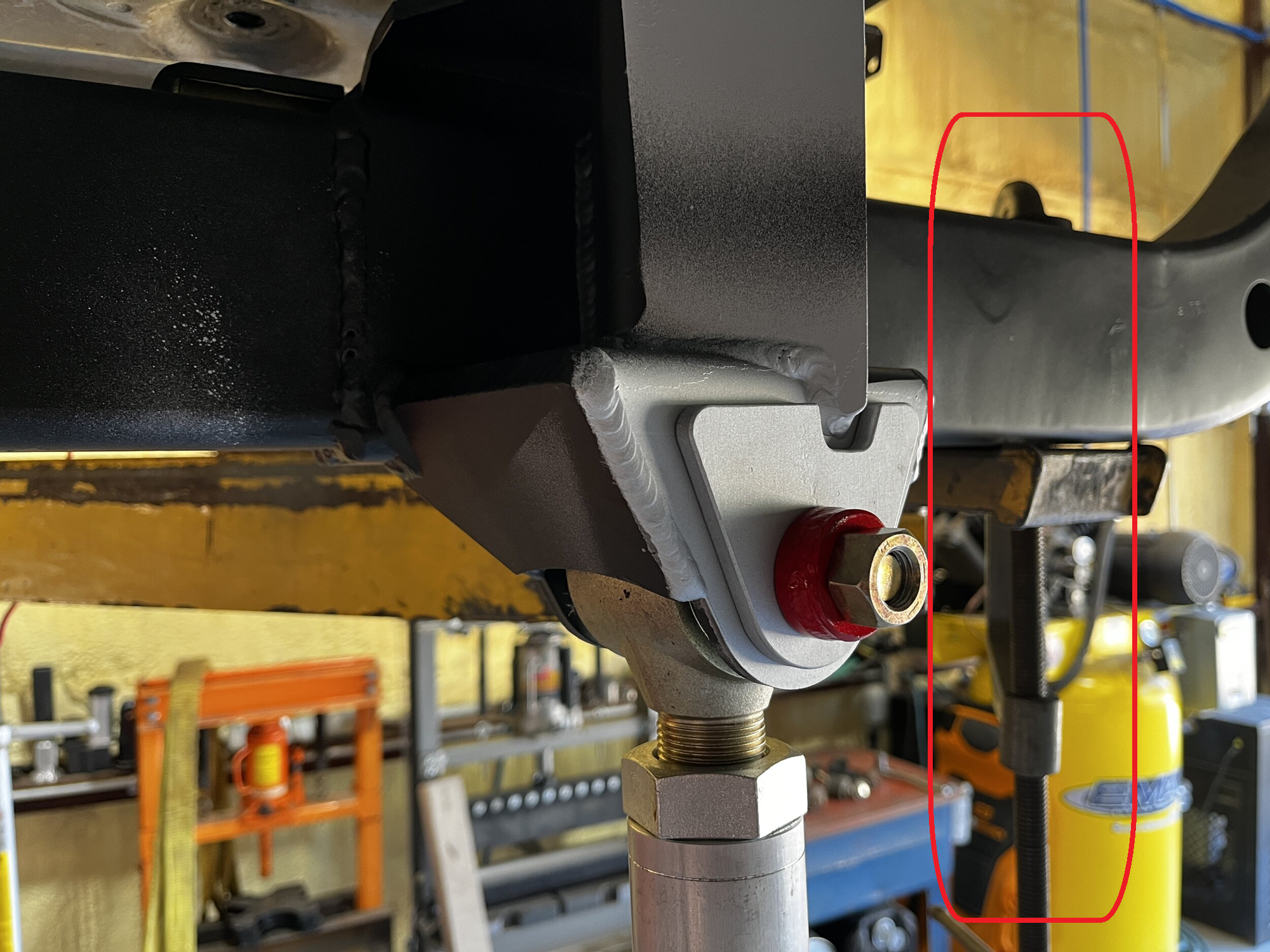

I've had enough mishaps with straps that I'd like to see both hooks in holes or go around the frame and hook them into each other. At least I'm not the only one who needs a cheat sheet to remember how to spell your last name, so good on you for that.I welded the truss on the rear axle and shaved the rear frame side CA brackets and so I could clamp the Savvy brackets onto the frame and start to get an idea of what the next problems to solve are. This is ride height with a 4" lift and about 5" of stretch.
View attachment 659901View attachment 659902
I've got a lot thinking and work to do. Just getting to this point could be a long write up. I should be cutting the rear frame off behind the T-case soon.

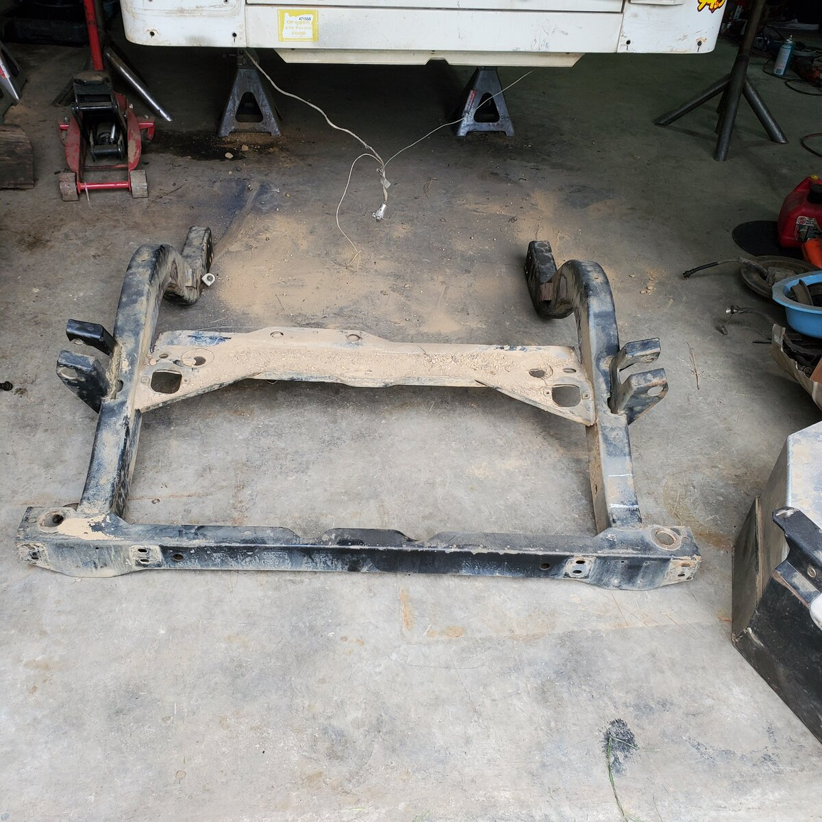

That crossmember and the two body mounts are really the only thing you got to think about. Everything else is pretty much a known. Cut it and then you will (have to) figure it out.I've got a lot thinking and work to do. Just getting to this point could be a long write up. I should be cutting the rear frame off behind the T-case soon.

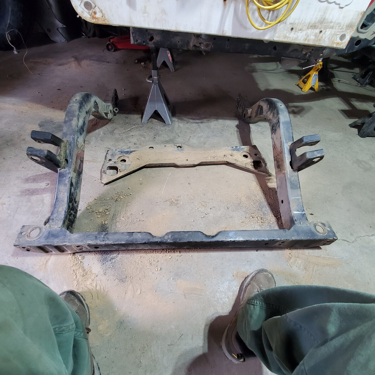

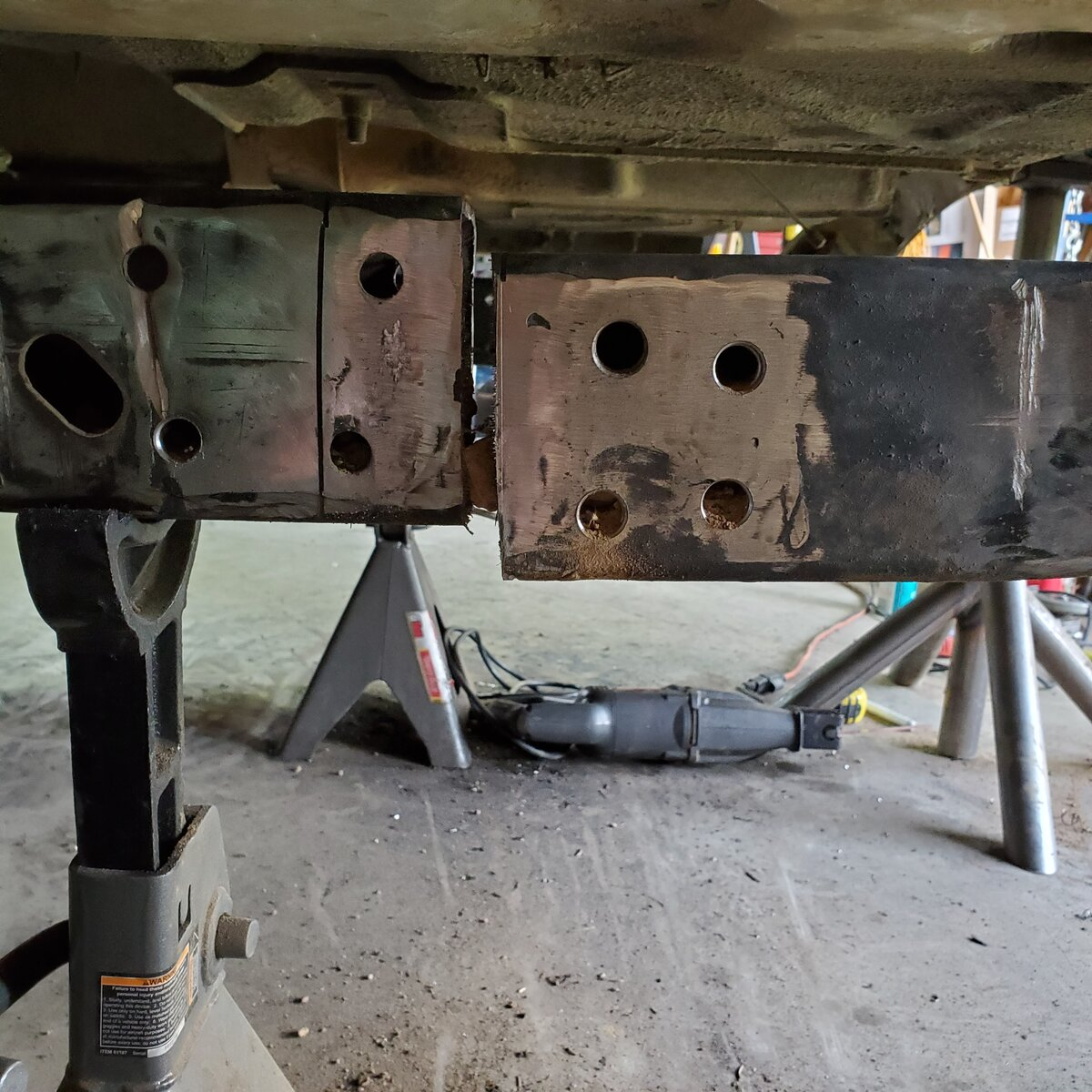

Scary when you do this... But once you get there then it's over with and you move on.
And it was actually lighter than I thought it would be.
I cut the crossmember out and then bolted it in place without any lift pucks then tacked it to the frame and then pulled it back out and fully welded it in place.
