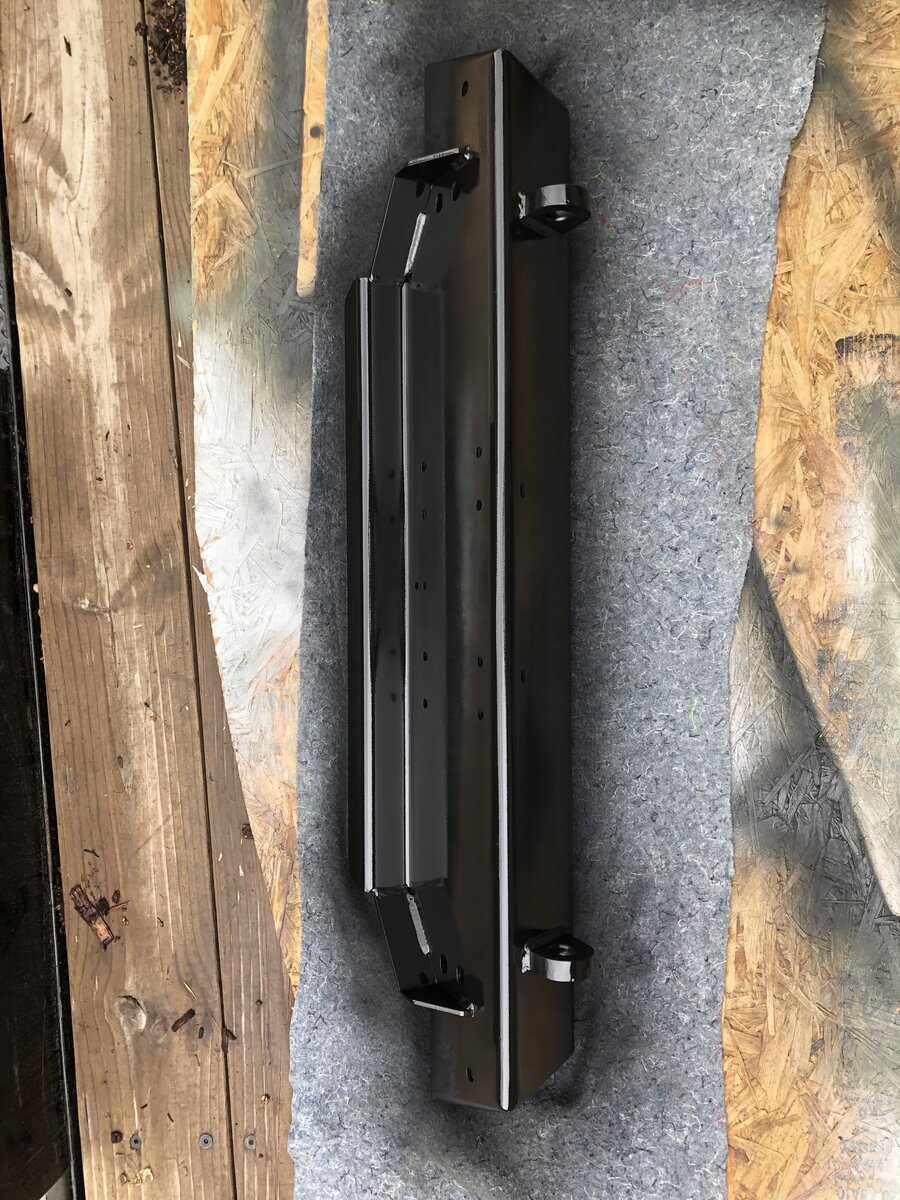

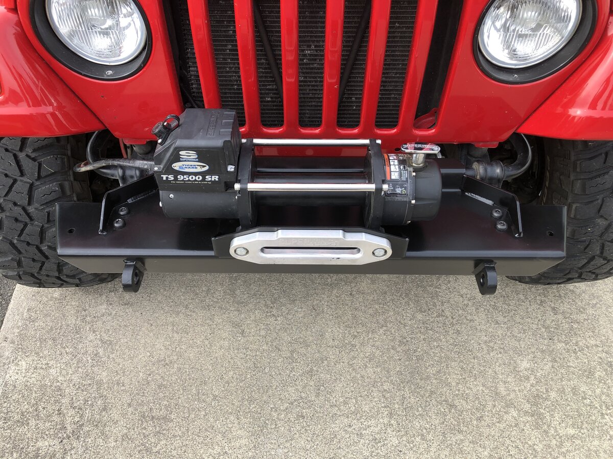

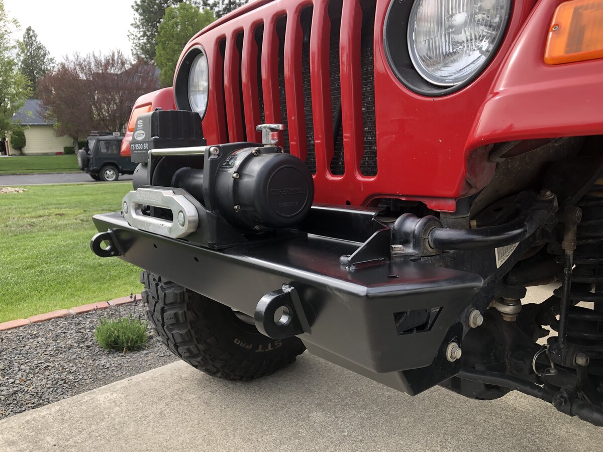

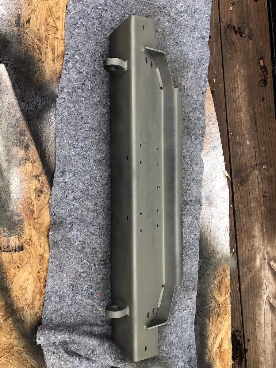

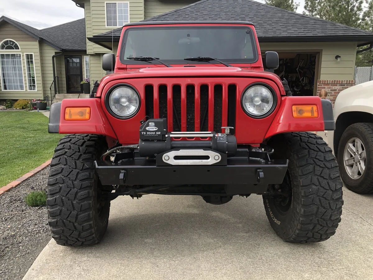

I’ve been working on something on the side recently. @jodomcfrodo contacted me about a front bumper. I was still running the EAG Chinese thing. He was upgrading to a Savvy and getting rid of his Warn Stubby Rock Crawler. He must have known I wanted one to match my rear bumper. Thanks so much to him for helping this happen.
I cleaned it all up, as usual, scratched it up with scotch-brite pads, washed it, alcohol, 2-3 coats of self-etch prime, and 5 coats of black satin enamel top coat. I was able to shave 10lbs. Now I’m one of the cool kids like @ac_ “She’s a beaut Clarke!”
View attachment 161955View attachment 161956View attachment 161957View attachment 161958View attachment 161959View attachment 161960View attachment 161961
That looks awesome!

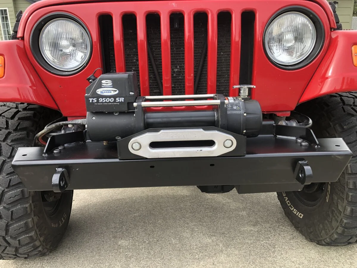

I spent awhile cleaning up the fairlead and making the inner edges perfect. I worked on the edges on the backside too so it is smooth as silk. It was gouged a bit from the hook. I’ll be moving to a TRE synthetic line and safety thimble soon. With my old rope I’ll make some soft shackles..

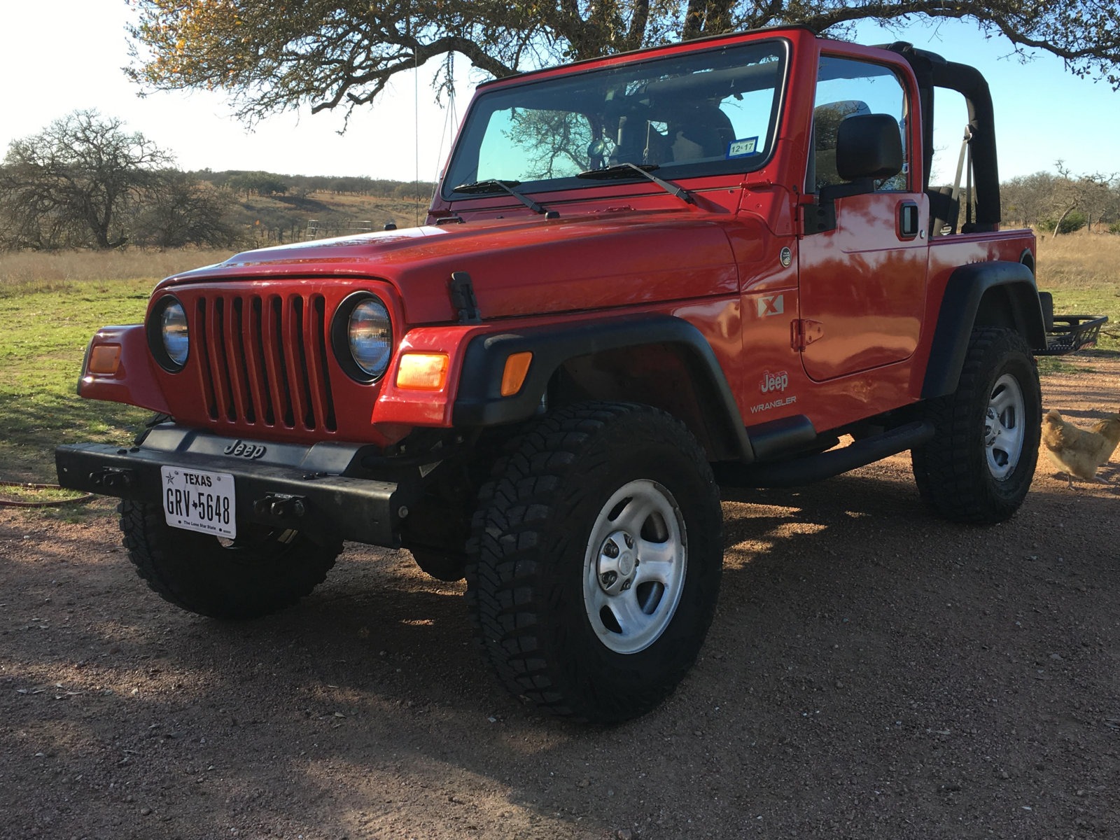

Hey guys,
I'm new to the Jeep world. Oh, I had a 2004 Cherokee once, but got my first Wrangler TJ in December, 2016, and that's a whole new world. I think I am addicted. Anyone else have that problem around here? LOL. Anyway, this Jeep was stock and low miles, 46K. I looked for six months before I happened on it and was the first to call! Anyway, I want to run 33x12.5r17 or r15. I installed a RE BB last week. Great first project. Supposed to be 2" but in reality the front turned out to be 1 1/4" and rear 1 3/4".
That said, I have three questions. First, what is your opinion on 15's vs 17's? I am not planning to do any heavy wheelin, though I do get offroad weekly. I have gravitated to r17's because I think it might look meaner and tire sizes seem to be going away from 15's. The rims I found that I like are 17x9 Pro Comps but I'm sure there are sill some 15's out there I would like.
Second, the person at Quadratec said all I need to do to run 33's is add a flat fender kit such as Bushwacker or Xenon. I asked about a 1.25' body lift and that seemed frowned upon. I was thinking I may not have to do the fenders if I did the body lift, and the body lift is much cheaper. What are your thoughts? And while your at it, what are your thoughts on Bushwacker vs Xenon as well as 4" or 6" width, keeping in mind the 33's coming on 17x9 wheels with backspacing of 4.75"?
Third, should I do the tires and wheels first and see if they can fit under stock flares? Or do the flares or body lift first because if I don't I'll get myself in trouble? I appreciate feedback from all you guys with years of experience. Here's a pic of the Jeep with the 2"BB ...View attachment 11839
