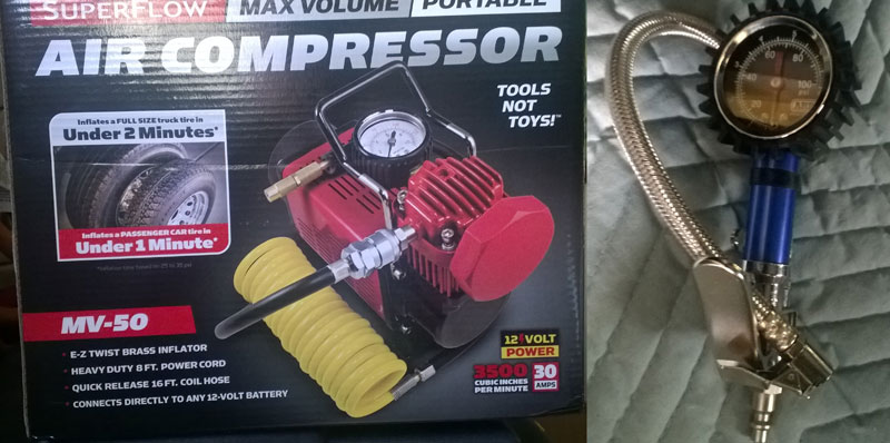

I have always used a cigarette lighter plug in type of air pump for emergencies one for each vehicle we owned. For the jeep I changed to a direct connect to the battery with jumper cable grips as shown below from O'reilly auto parts and the deflator/inflator device on the right. I did buy a longer hose of the same diameter and put female quick disconnect ends on it. I can on the four door reach all four tires without moving the compressor around. Time to reinflate the tires is under two minutes and a little longer to deflate them. The deflator/inflator without the air line hooked will take the tires down using the same lever that inflates the tire when the air line is connected and there is a small button to allow precise pressure when your close to your desired pressure. The deflator I bought at the jeep supply store when they did the free inspection and re torque of the lift kit. The compressor does get warm after four tires but not that bad. I think the compressor was around $80. and the pressure deflator,inflator was around $25. Also the deflator is neat in that when you release the handle you get an accurate pressure reading going up or down on the tire pressure. Sorry this is so long but it works.
