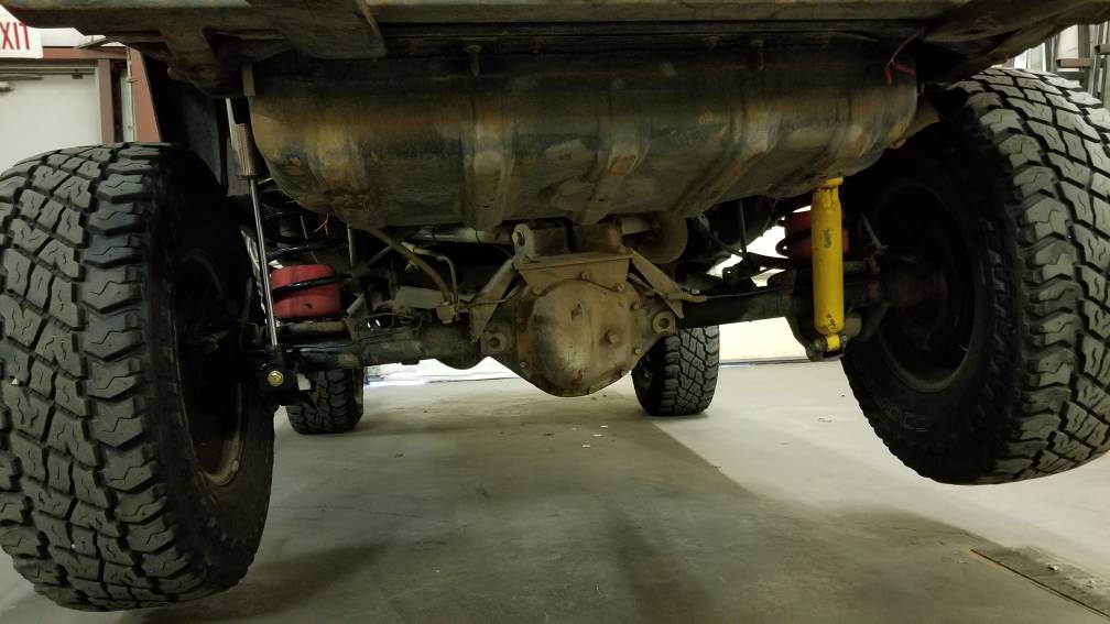

Here is @jjvw comparison
Outboarding allows for a better length shock to maximize the amount of usable travel. This removes the shock as a limiting factor for travel. If you have a 2” lift, you’ll benefit from an increase in down travel by outboarding, not sure if any uptravel gains are to be had by this. In outboarding for a 4” lift, a 12” fox shock can be used, and when used with a resivor provides a significant improvement in ride and capability as these shocks can be tuned and valves by someone such as @pcoplin. Tuning gives you the ability to adjust the ride stiffness, rebound, and compression. For 2” of life I wouldn’t consider outboarding to be worth the cost/effort for the amount of work and money it takes to done right...can you do it? Sure. But to do it right would mean much more work than just placing a tower and a longer shock. You can probably get all the usable travel from a 2” lift with an over the counter Rancho, adjustable ones being my personal favorite as I have ran them on many things. But there’s another level when you go high and need more adjustable parameters. I’ll let some others chime in, just know that @mrblaine invented shock outboarding for TJs, so if he decides to give input here or you read what he’s said on other threads he’s going to be the correct voice. What I will say is that outboarding is a solution to a problem, and if you’re not having a problem then there isn’t anything to be gained. The question to ask is what am I trying to achieve with this modification? Stability and ride can be improved with outboarding but only when done correctly and with that goal in mind when setting it up. As @mrblaine has said on other threads discussing this, you can outboard and severely downgrade the shocks performance if not set up right, it all comes down to your goals and what problems you are trying to solve! Hope this helps.

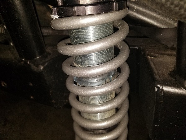

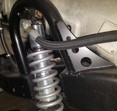

I apologize for the poor pics/lighting but this is mrblaine's work on my LJ (stock width axle, rear 2.0 coilover, no wheel spacers, 3.75 bs wheel and 35x12.5 tires):
It rides better than stock and better than I thought possible considering the tire size and suspension. It puts a smile on my face every time I drive it. To give an idea of the quality of the overall build I feel more comfortable at 80 mph on the freeway with no hands on the wheel than I did with both hands on the wheel when my LJ was stock.
I believe it's just the CO outboards due to the diameter of the CO.
Are those mounts available? Are they one off?
Having seen that Jeep and taken a ride it in person .. that jeep is one of the most special LJs that exist.
Yes, it is one off and I don't think people understand how much work was done to put coilovers on stock axles and have them work perfectly.
