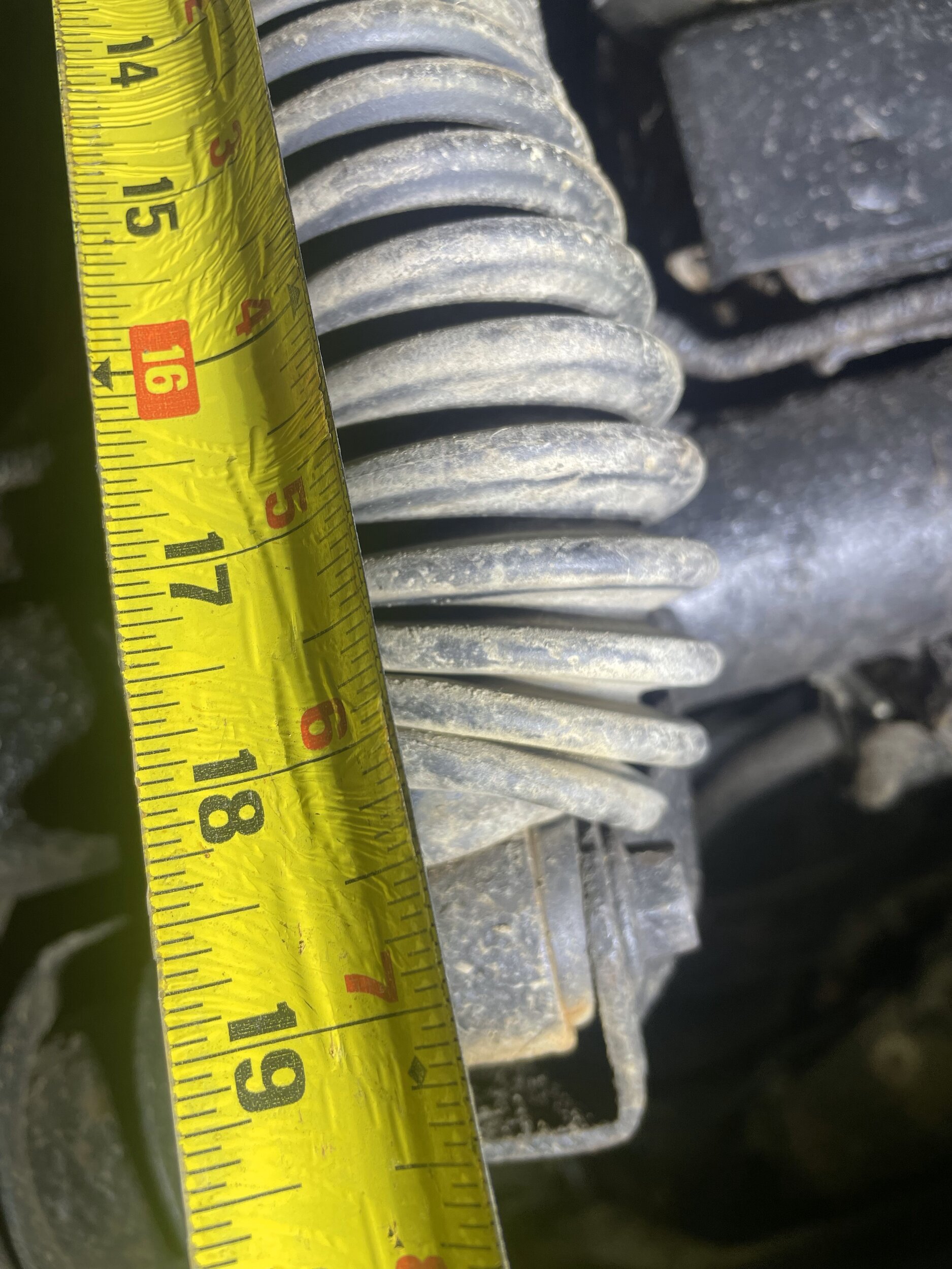

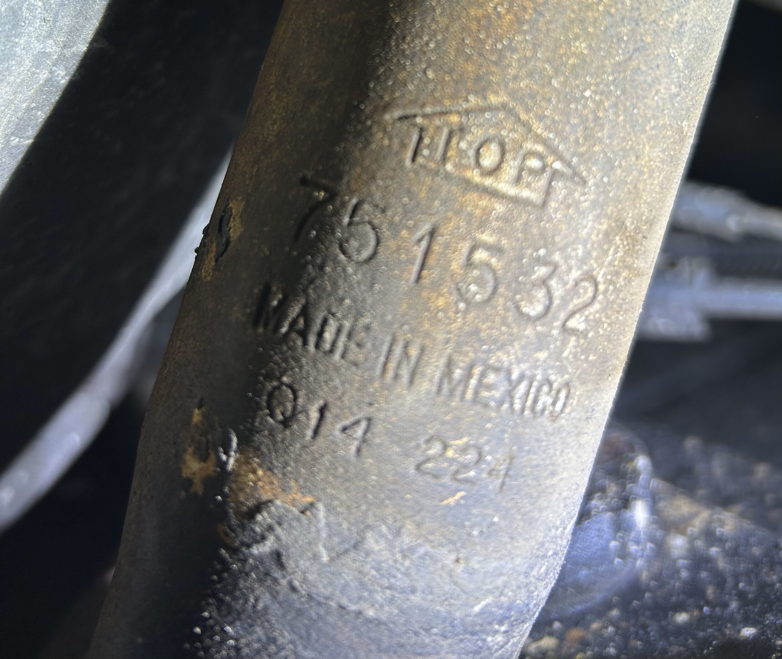

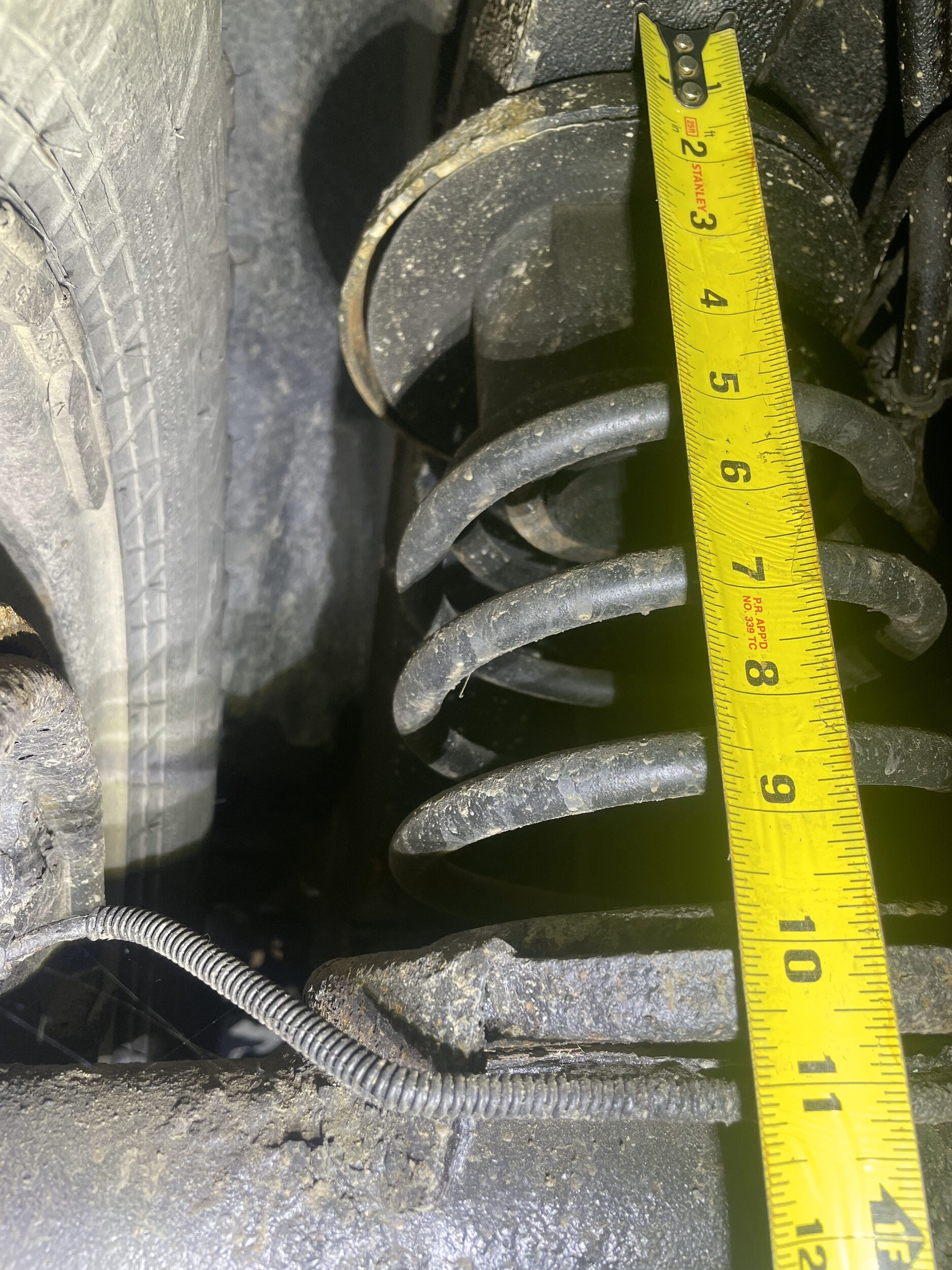

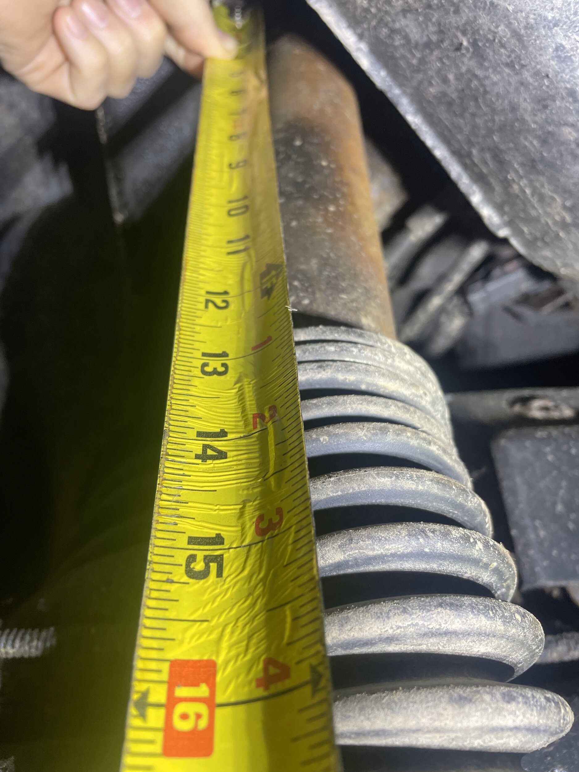

I have done everything that many suggested forums have asked--measured the shocks from mount to mount (call it 19 inches) on a Jeep with a "cheaper" lift that I am not sure of the actual size (I think 3"?). Springs are about 10". I was able to get some part numbers off of the shock, but I cannot figure out the shock brand or overall spread of the shock--I also cannot be certain the shocks are correct for the lift, but I assume they are. Attached are a few pictures that might help the experts here offer me some advice. Also, although we like to think we trail with the Jeep, we really do not much. We love to take the top down and go for drives--if we find a country road to throw up some mud and dust, we jump on it! It is a 98' TJ with the 2.4 engine (the little engine that almost goes). We live up in the Pocono Mountains (beautiful drives up here!). So we are looking for more comfort than stiff, but I also know it is a Wrangler and that is nearly impossible (which again we are fine with).

Rear coils look to be for a 2.5" or 3" lift. Just look around and find shocks in your price range. Just stay away from cheap shocks like pro comp and rough country.

You want a shock that at ride height 50% of the shock shaft is showing. This is the “right” size. If less is showing there is not enough uptravel and you’ll get a rough ride because you’ll be bottoming out on the bumpstop or the shock. That shock is too long. If more is showing then there is not enough downtravel. That shock is too short. Both will ride poor.

Thanks, I did review that info too. Was more asking based upon my lift which shocks would fit properly. I “think” I need something that has an extended length of roughly 23 inches if everything I read is accurate. I hope so, because I ordered some skyjackers yesterday. Lol
