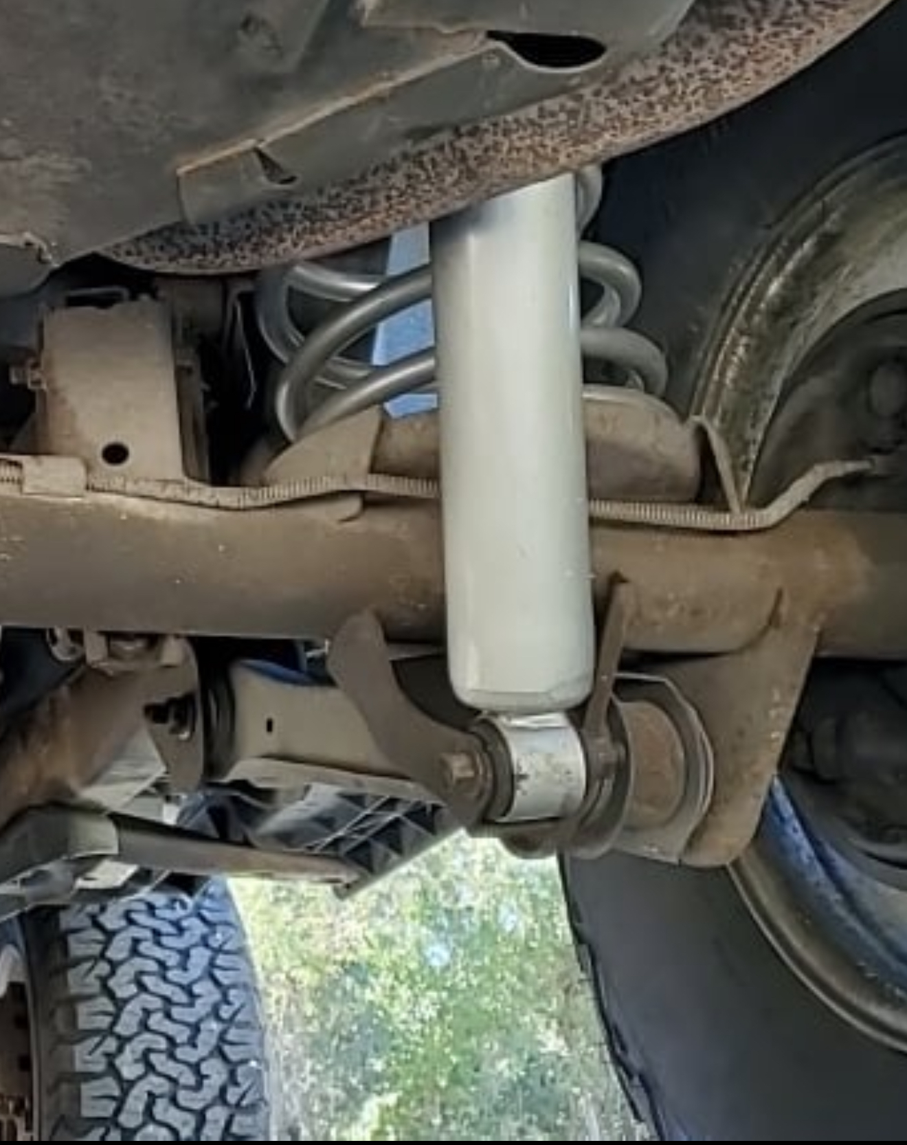

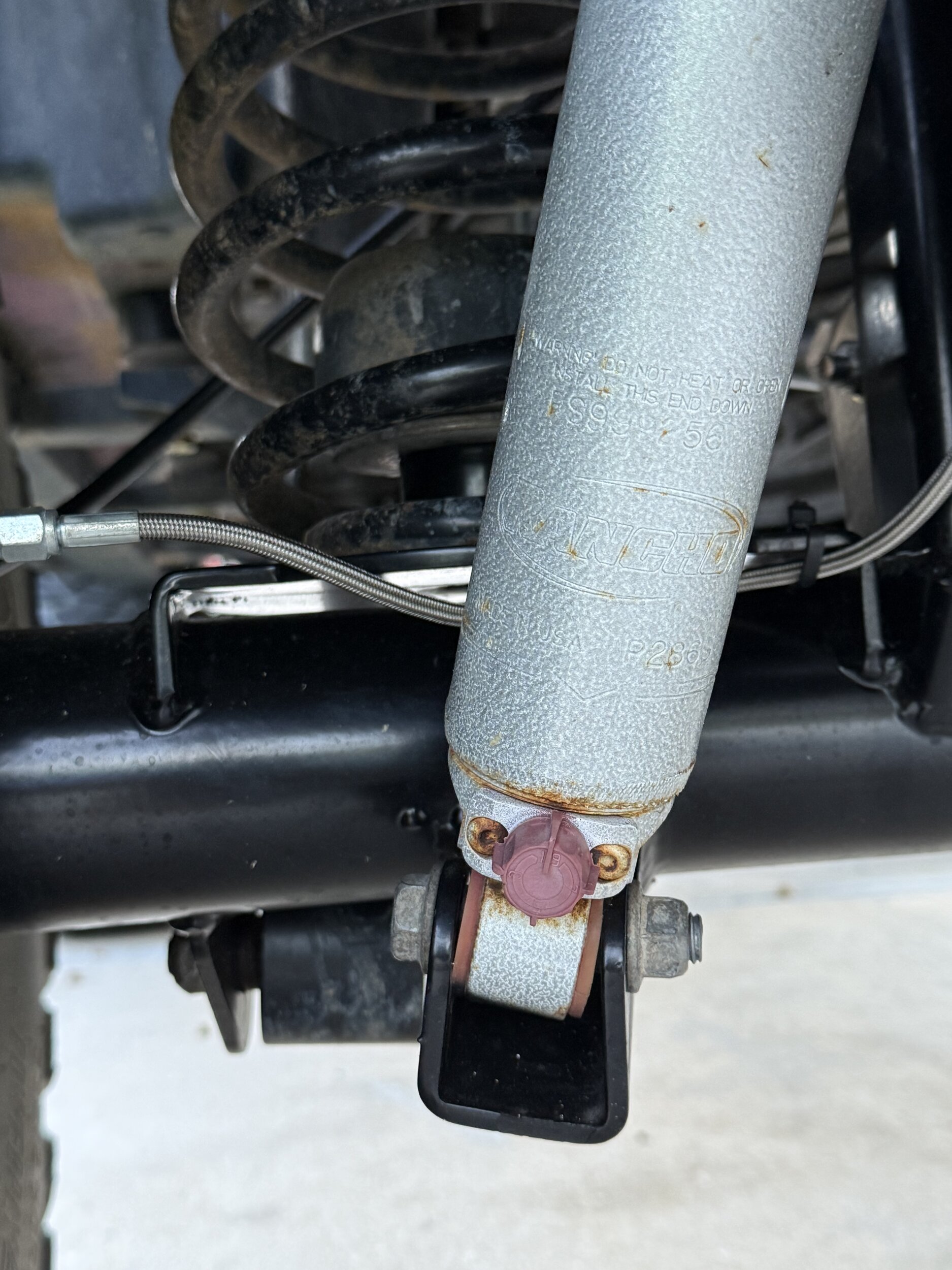

Post up pictures of your axle side shock mounts. I've got a CRD60 rear in my TJ also and am only 61" WMS and outboarded my shocks in 2006.

I’m estimating roughly a $1k for tower install and associated fab work and roughly $2k for a set of tuned Fox shocks.
Teraflex axle
Stock axle
Teraflex axle
Stock axle
Springs look to be roughly in the same spot, but yeah that lower shock mount is raised compared to stock. So, new lower shock mounts that are lower or just save for the outboard and fix it then.
As said by JMT the shock brackets aren't in the same positions. The CRD shock mount is a lot higher than the stock if you compare it in reference to where the control arm brackets are.
I'd put shock extender brackets on or even better would be new shock brackets that centered your current shock travel to be as close to centered as possible.
Then I'd save up for outboarding. But when you do that spend the time & money to have 12" travel shocks in the rear & 11" or 12" travel shocks in the front.
If you're going with Fox tuned shocks then also at a minimum get LSC & if you can swing it DSC on the reservoirs too.

Agreed with the others, your new shock mounts aren't "right" for your current setup. Either way you're going to need to cut them off and get that balance right or add a spacer for the shock mount (lots of us have done this for a period of time).

Some follow up - Spoke to Teraflex today and the axle mount is in fact shifted up by ~1.25 inches. Doing some Google foo it turns out the next size shorter RS9000 at 50/50 is 17.375 inches. I was thrilled to learn this as the current shock length at ride height is 17.5 inches, so I think I have a path forward while I save my pennies for outboard and further poor financial decisions.
