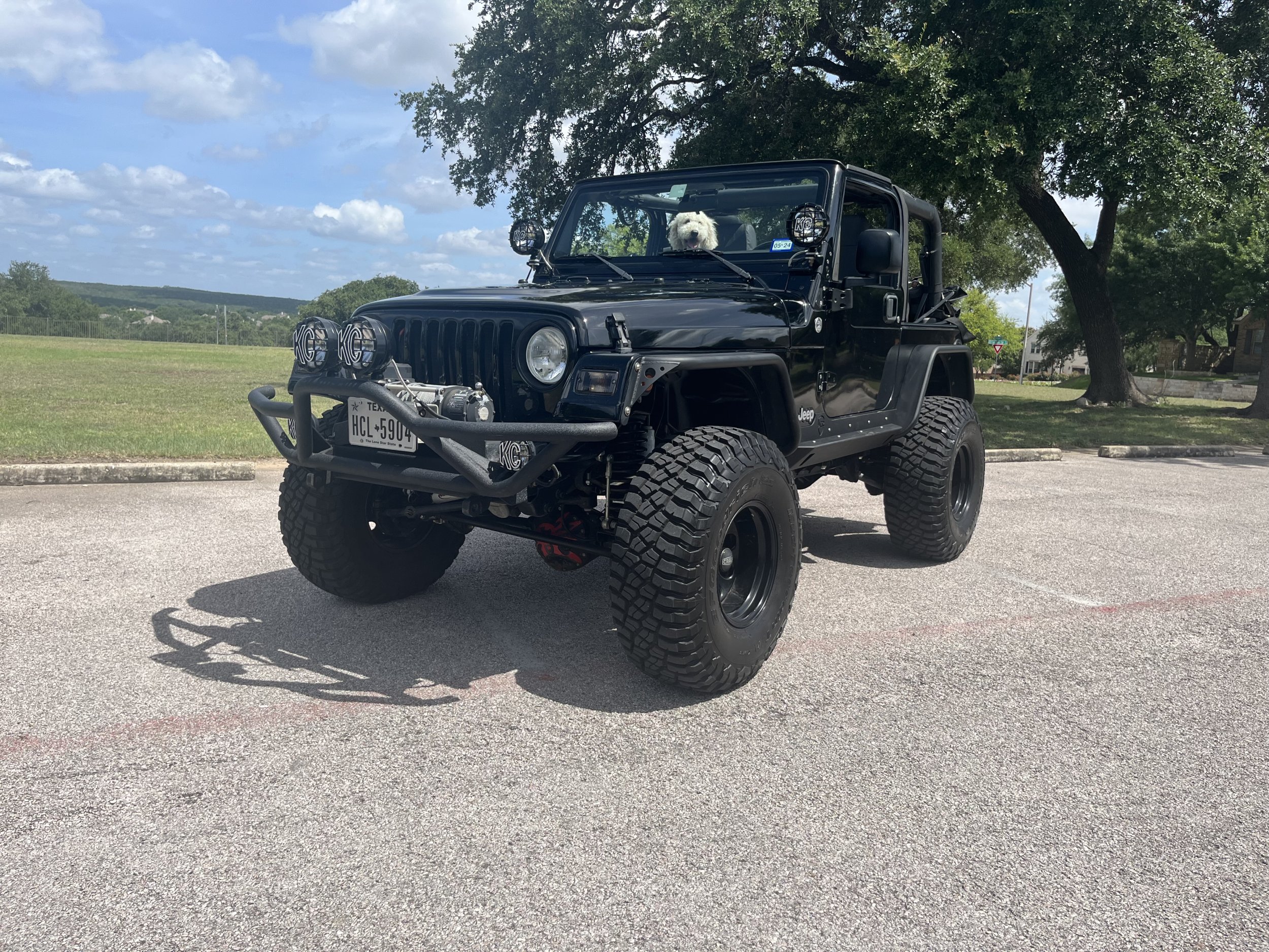

I have just about the exact same setup.
4” Currie/Rock Jock springs
Currie RJ front and rear track bars
Savvy double adjustable arms
JB Conversions SS SYE
Tom Wood’s DS fr and rear
Currie Currectlync Steering
I put Savvy MML and BL
Also Savvy Skids for TC and Engine
Also cable shifter
I used the HealTech SpeedoHealer
Not sure why they make setting it such a formula, but it works perfectly for my TJ with 35’s.
