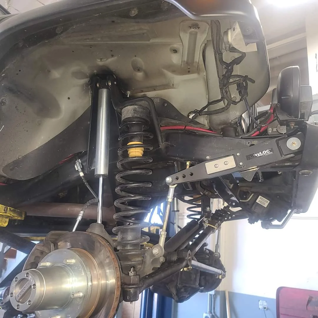

I like my hubs a lot. Only downside is the hub decreases your backspacing by 7/8” on each side. I can’t remember what @mrblaine said is the minimum amount of backspace he will use with a small hub kit but it’s something to think about.
I"m at 3.625 with this wheelset, but plan to move to another sometime later.

How is your front pinion angle? I too fought with my front causing vibrations. I eventually installed a hub kit. After resetting my caster, lowering my front pinion, I can now leave my hubs I and have barely any vibes. If you can experiment with the front. Try lowering the front pinion some. It seemed to have worked for mine after spending over $1k on a hub kit. Lol
