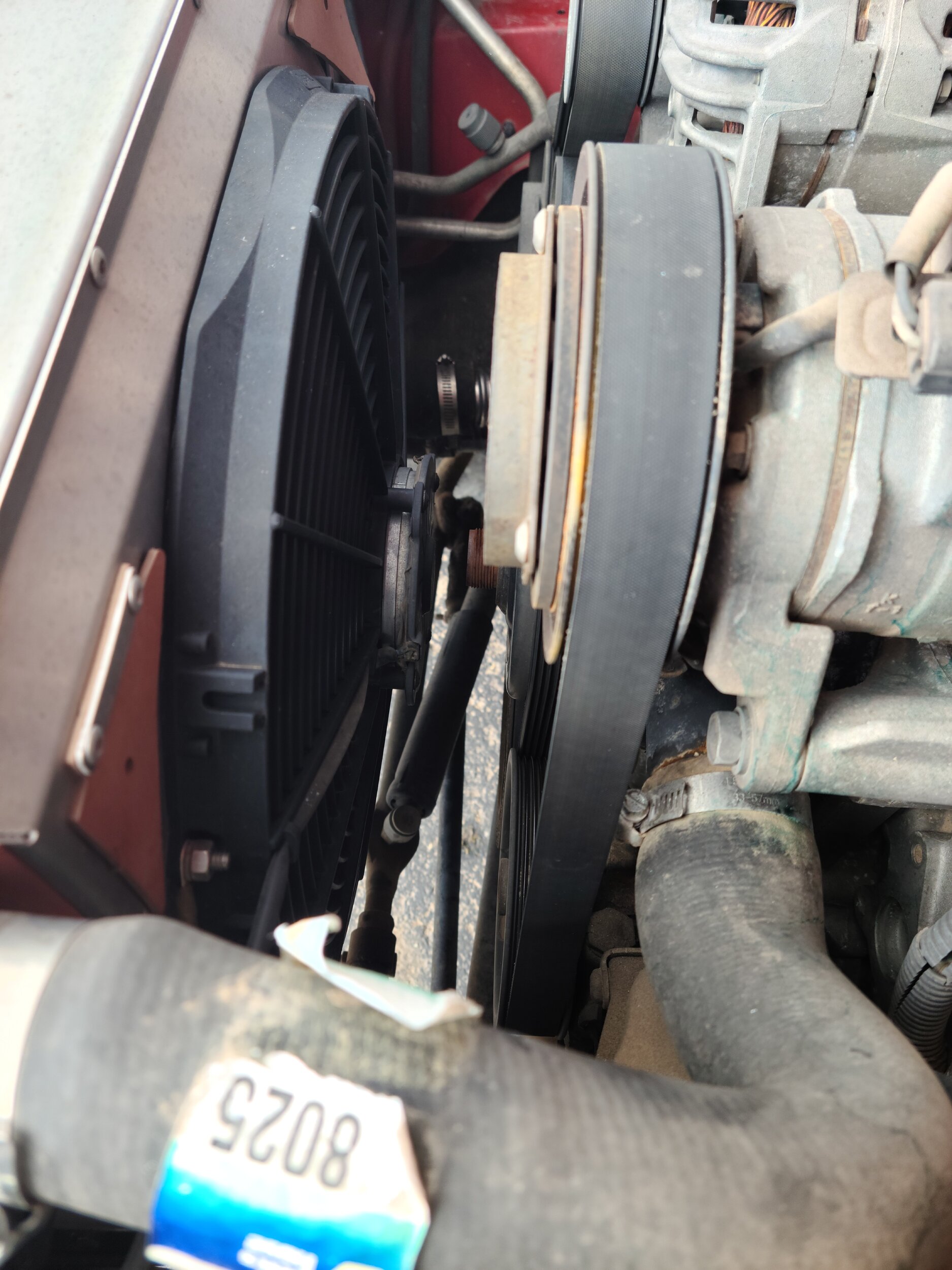

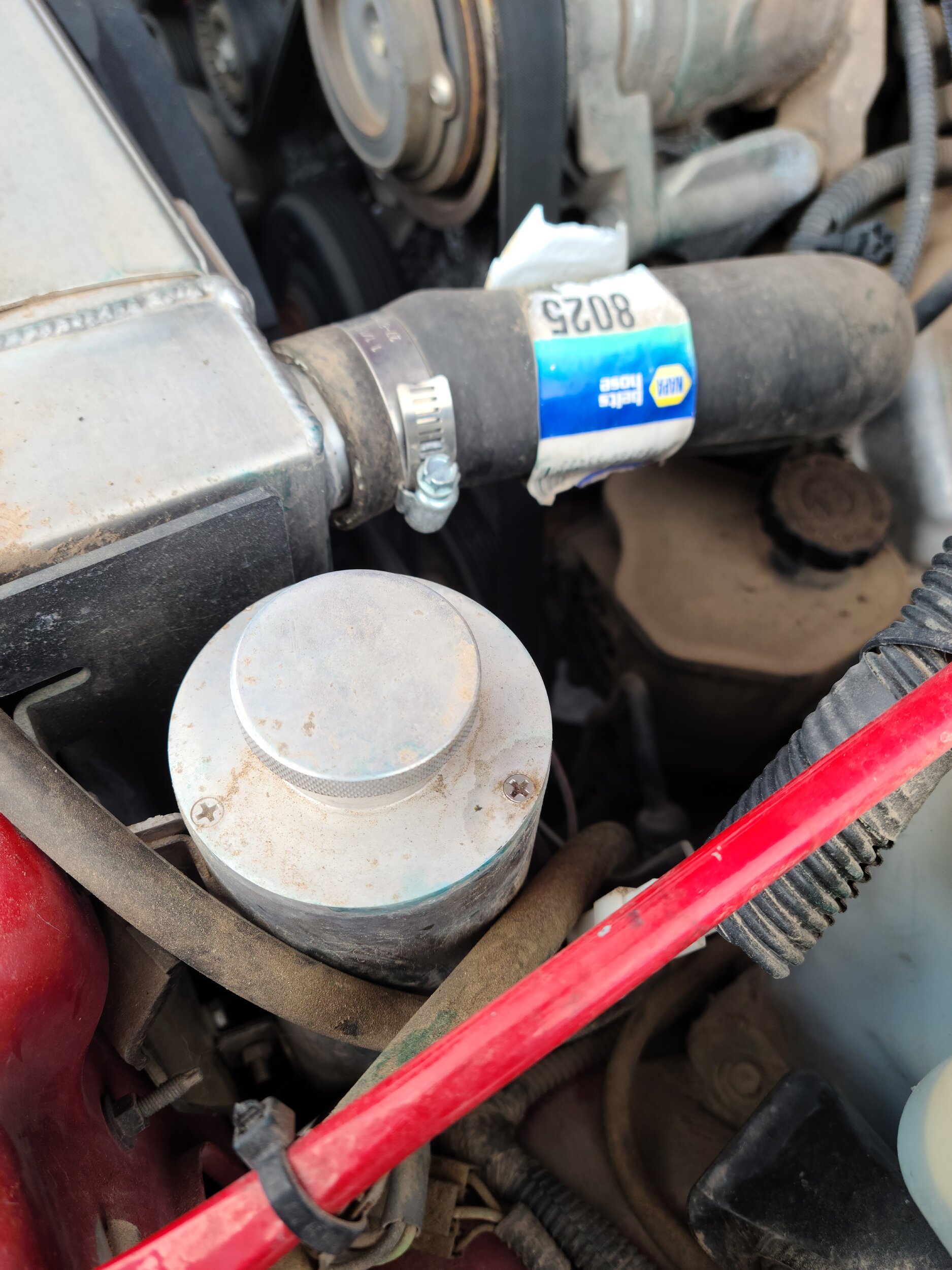

Need Cooling Help for Hemi Swap

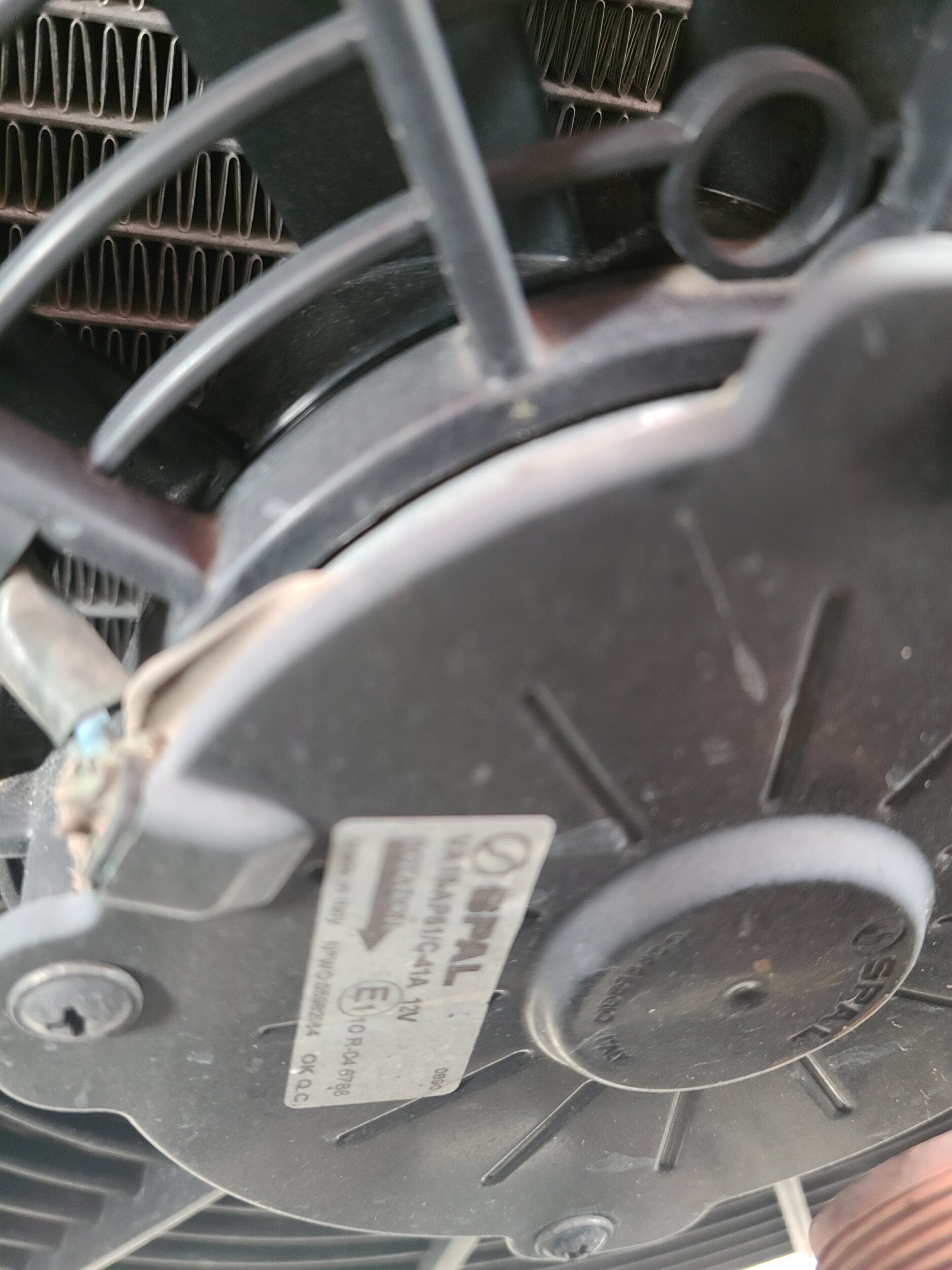

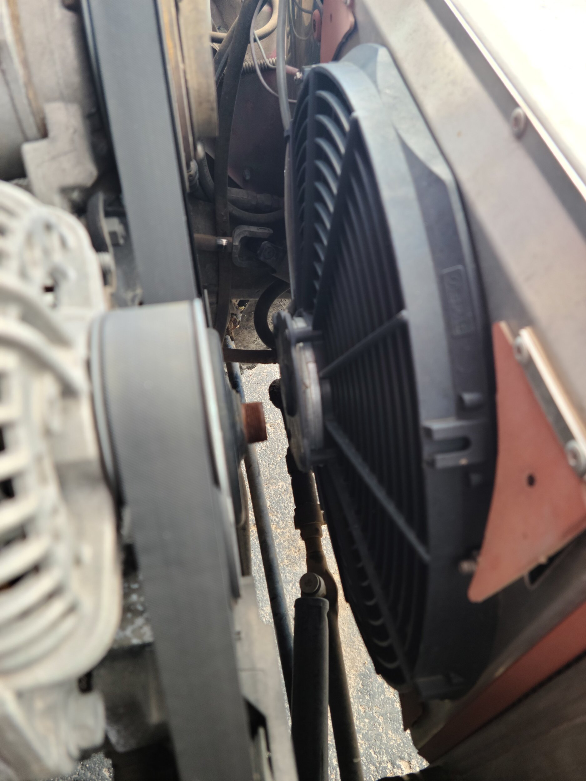

Some more pics. Apologies for the poor focus on the Spal tag....my phone wouldn't focus.
Gonna go with the mechanical setup with OEM shroud, let's see if that's the secret sauce! If that doesn't work, the 850 Amp Camaro fan!
Reactions: John Cooper
That is a older SPAL brushed fan. As has been said before the newer brushless fans are really a lot better. But looking at those pictures I'd think you might fit a mechanical fan in there.
Give me a while and I'll go out and measure my mechanical fan depth for you.
I’m pretty sure the stock TJ clutch is about 4” deep, so if you have at least 5.5” or so between the radiator fins and the base of the threads on the pulley I think you’ll be good.

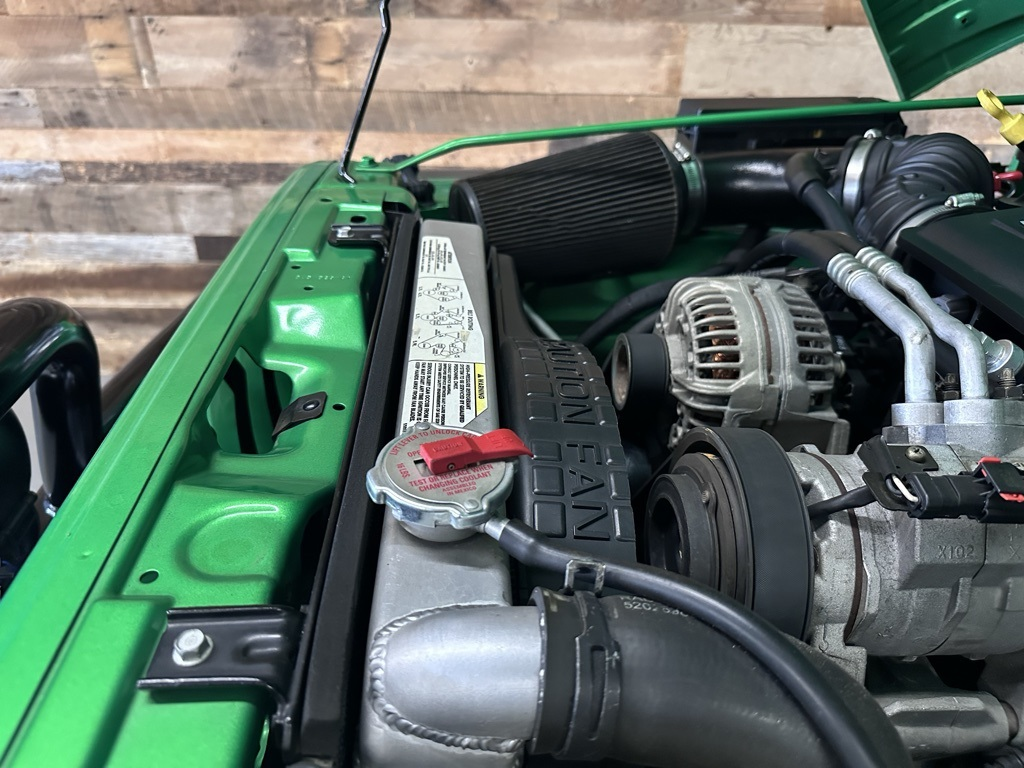

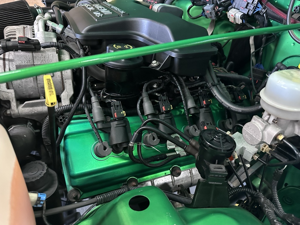

Cross Jeep just posted this rig on Instagram. Wasn't sure about the rules concerning poaching another companies photos, so here's the IG link (is that ok?). Anyhow, the last pic gives a shot of the engine compartment, and it's got the TJ shroud, with what I'm guessing is a mechanical fan. I'm guessing this is the setup they are speaking of when they tell me that they "had the best luck with the mechanical fan, so that was our go to setup as we closed out our TJ builds."
Here's that Jeep, And yes that radiator core is smaller than mine.

I measured the fan clutch I have & it's 3.75" from the face of the clutch to the back of the part that threads onto the water pump. So I'd guess it's about 3.25" off the front of the water pump to the front of the clutch. The fan blades don't stick out past the clutch either. I can take pictures of it tomorrow if you need me to.
Thank you sir! Very much appreciated! I think I have what I need for now, thank you! This thread has been a great deal of help v
