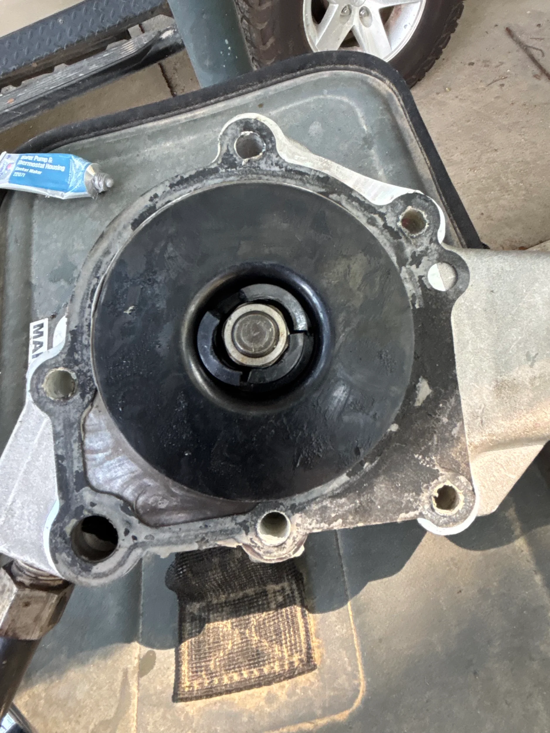

Water Pump - Similar story with the Mopar water pump, but worse. Like I said, I was trying to go back with Mopar just because I had had good luck with the original. The new Mopar water pump that they are selling for this application is the 68382492AA. It supercedes the 5012366AG or earlier models that I was looking for. What the heck, it's a Mopar... it will be OK. Not so. The 68382492AA water pump arrived and I was disappointed that it had a cheap plastic impeller. Not just a plastic impeller, but cheap plastic. You know the feel I'm talking about. I spun it around and it was working so I went ahead with the install. Turns out that the part of the impeller that makes contact with the shaft was damaged but not where it was evident... until later
I buttoned up the whole system, added new Zerex G05 coolant, and started her up. All was well as I was burping the system so after a while, I took it out for a shakedown. I made it about a mile when all the alarms started flashing. I parked it and let it cool off. I got a P0118 code and cleared it. Once it cooled off, I drove it back home. I spent a couple of days with an infrared temp gun trying to figure out the problem. The clincher was that I was getting no hot water to my heater core. It could only the the pump. I drained the system, took off the shroud and fan, then took off the Mopar 68382492AA POS water pump. Right away, I spun it and the impeller didn't spin. I looked and the cheap plastic collar that was supposed to spin the cheap plastic impeller had broken off. Luckily, I found all the pieces in the engine block. I made a trip to my local parts store and got a Gates water pump. It has a metal impeller so that made me feel a little better. It was half the price as the Mopar. I installed everything back, filled her up, and have made a number of shakedown runs and everything seems to be well.
