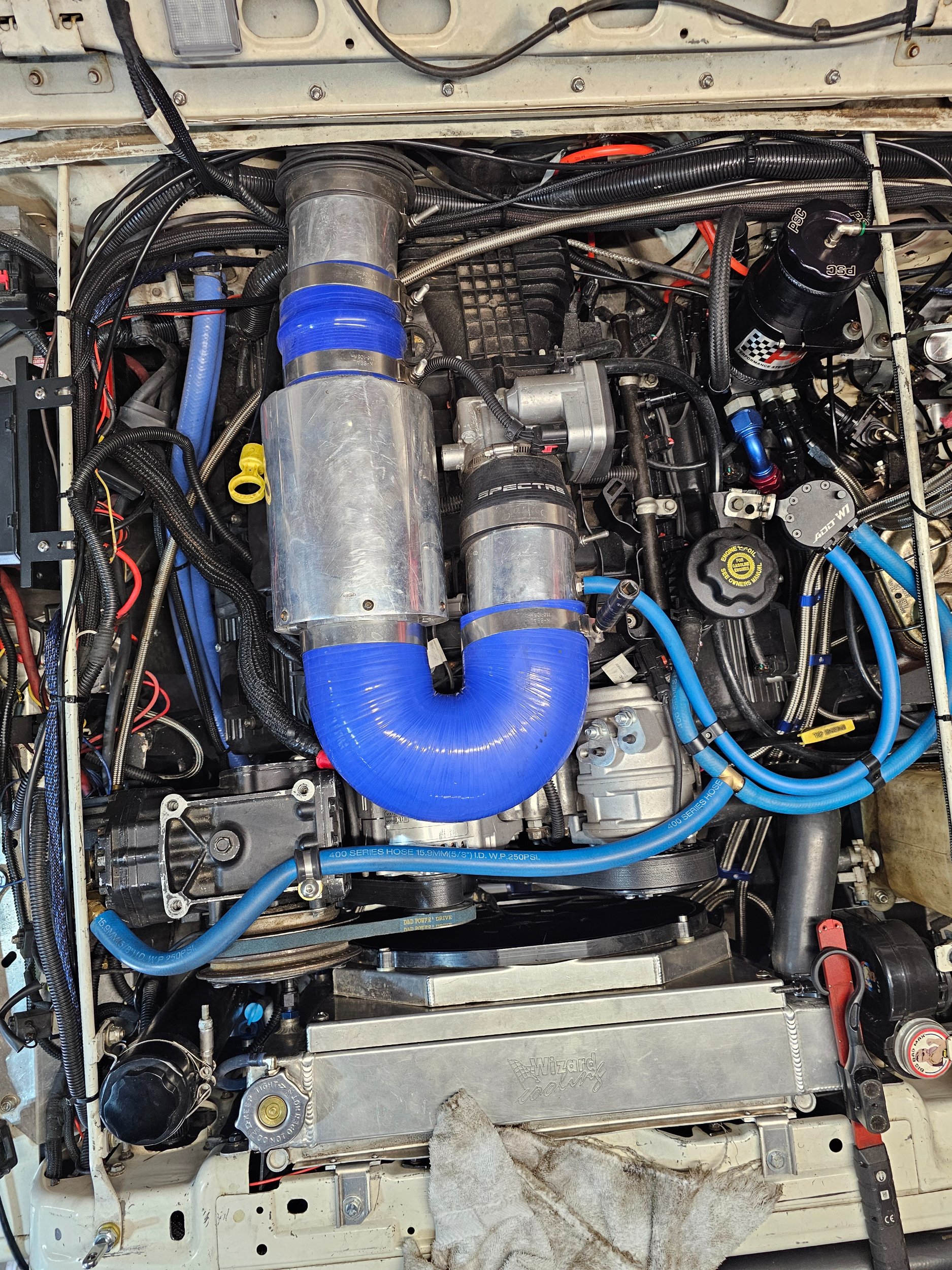

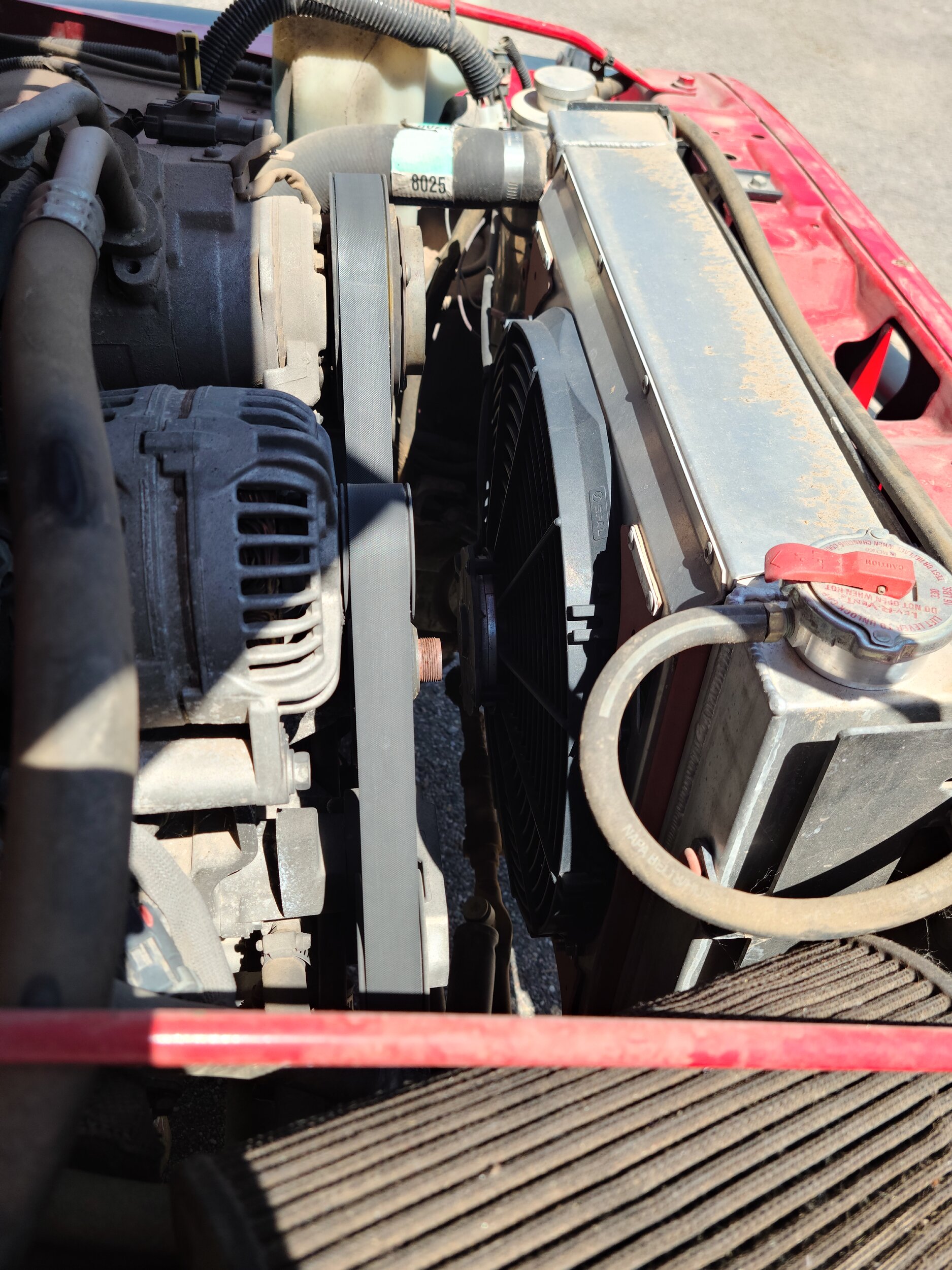

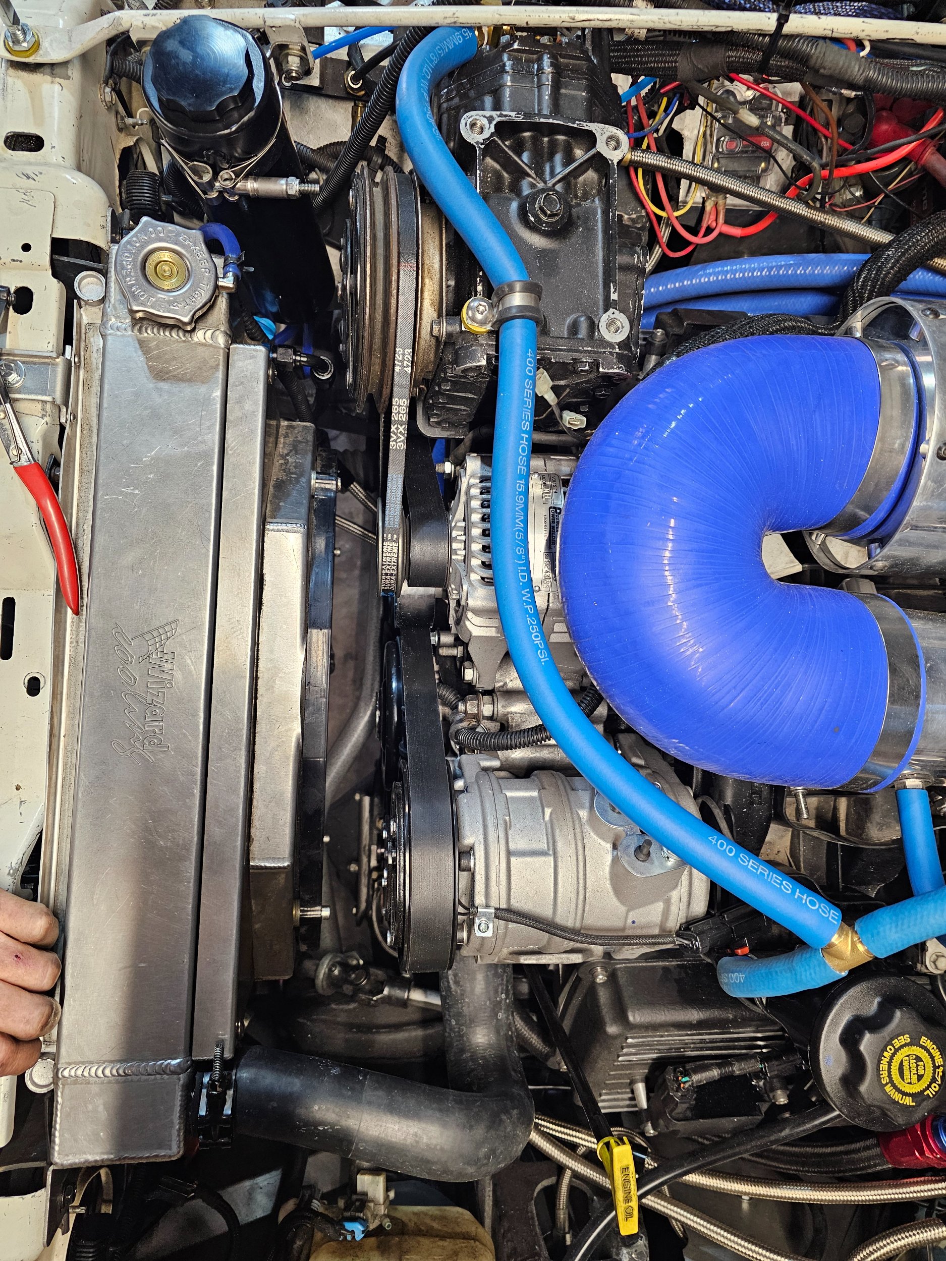

- Cooling - The cooling issues are well addressed in this thread, but I am now realizing it's not a simple answer. Am I going to run a flat belly? Am I going to run a body lift? Am I going to raise the drivetrain, am I going to throw in the towel and just run 33s?
- Electric fan will accommodate angles, raising/not raising the drivetrain, etc. but:
- AEV swears by the mechanical fan setup, with OEM TJ shroud on a custom radiator, with the OEM fan and clutch.....but they didn't run body lifts, even on their 35" tired builds
- AMW's current swap kit uses electric
- Many current and defunct "kits" out there use(d) electric fans....was that out of convenience or performance?
- Daubie's hemi swap, which is as clean and "OEM like" as could be possible seems to be running all OEM cooling components, with mechanical fan and he has ZERO cooling issues. However, I don't believe he's running extensive suspension or body lift?
