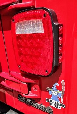

Yea just get any 3 wire leds and ground to the fender for flat fenders. Or 3157 led replacements for stock, just make sure they have distinguishable low-high. The stock side markers give some people issues if led do research on that.
The issue is often not the side markers themselves, it is a result of putting LEDs up front which takes away the ground the side markers need. So people think it is a side marker problem but it is not a side marker problem.
