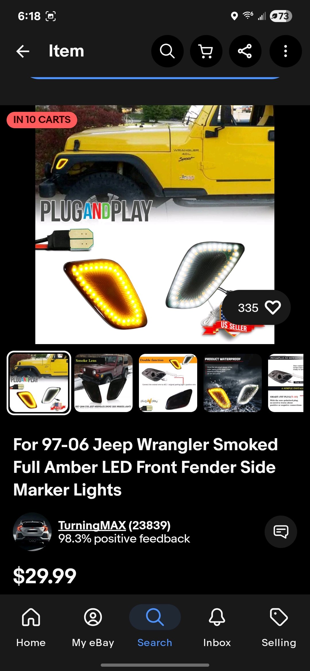

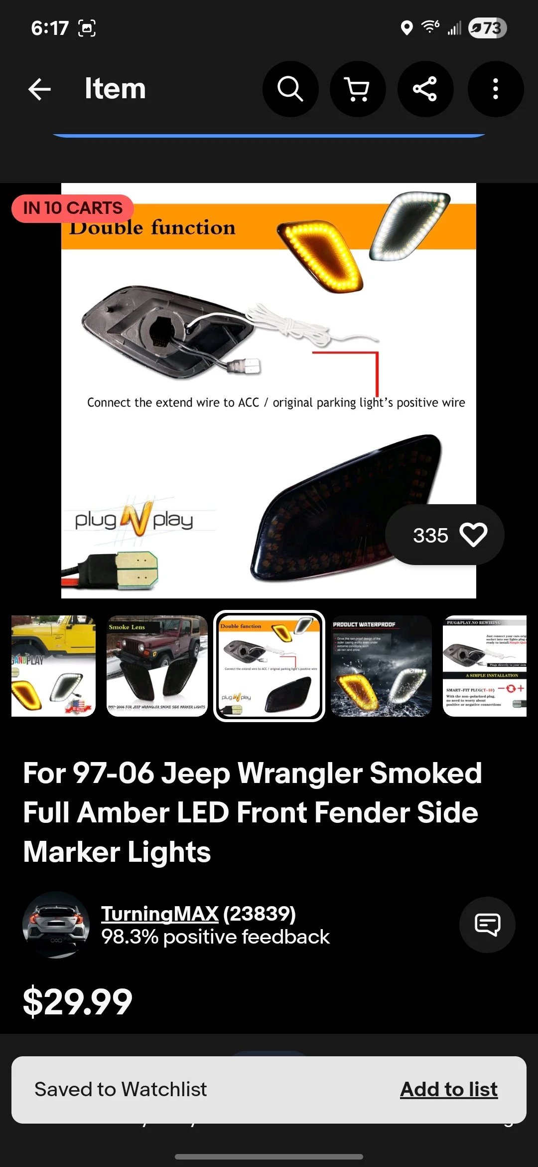

I replaced all my lights to led and got a hyper flash relay. All light function correctly except the front side blinkers .. when headlight and marker light are on they work but when not on t he blinkers are dim and not flash normaly.
The side light is a single hot wire with dule voltage . It acts like low voltage for blinker. If marker lights are on it blinks normal.
