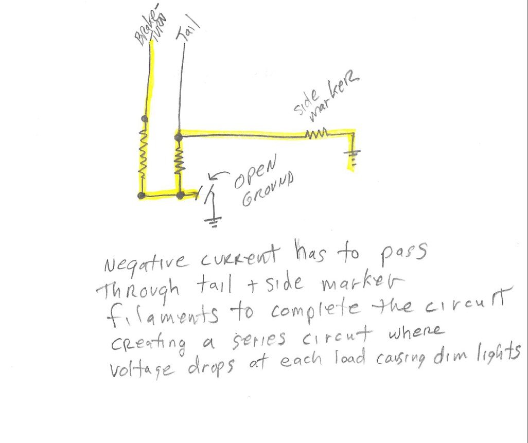

With an open ground on the lighting what happens is a backfeed through the filaments of the lamps that share the same ground path causing them to illuminate dimly as it is now a series circuit. To test this, temporarily wedge a piece of wire between the bulb base and the tail light socket and attach the other end to a good ground. If everything works now it's just a matter of tracing the ground to where it failed.
Here's a crude drawing

Thanks you guys for all your help. upon inspection my grounds looked great but i also noticed my driverside headlight a bit dim. i took the ground off the passenger side radiator support cleaned it all up. I then removed the ground wire completly to my passenger side running lights and ran a new ground. all is well is rustville.. With that out of the way i have a thermostat code , which i orderd a housing and new thermostat. i also have a small evap leak that im going to need to chase.
