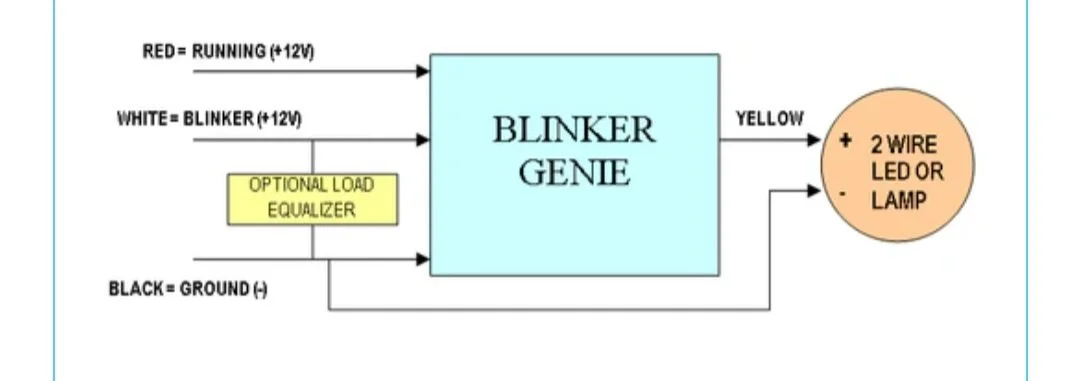

I have done a lot of searching for answers and watching YouTube videos, but hoping someone can provide some quick help. I changed the front facing turn signal/marker light to a Lasfit LED. In doing so, I got the double green arrows permanently on when I turn on the lights. From what I've read, this stems from the 2 wire connection to the side marker light. I purchased the Blinker Genie 2 which turns a 2 wire light into 3. How do I go about wiring this up? I see a brown/tan wire and a black with yellow stripe going to the side marker light. I assume I'll need to cut that off and wire into the blinker genie, but want to avoid messing anything up. Hopefully someone has done the same thing.
Looks pretty straightforward. Just parallel side marker and front marker LEDs to the yellow and black wires. If your lights don't work correctly, reverse the 2 input (red and white) wires.
Or just get 3-wire LEDs designed for this purpose.
Thanks that's what I figured just double checking. Only reason I'm doing it this way is because I am just replacing the bulbs not the whole light assembly.
