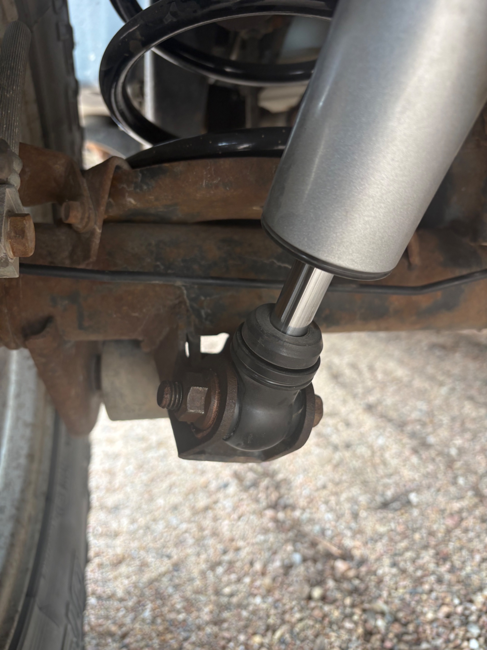

Installed JKS 2" Question
Just wanted to update my post. Rear shock mounts had been replaced and set the shocks up much shorter. I am removing and welding on stock location mounts.
Spreading out the distance between mounts will be good start. When we outboard the shocks, that is one of the things we are doing in order to fit a shock correctly.
