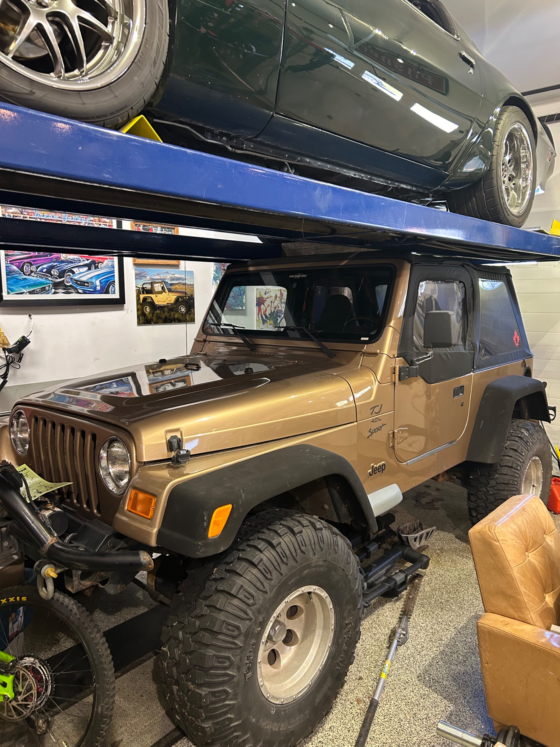

I need to lower it another 0.5” to 1” so that it fits better under the hoist. (Right now it’s aired down 0.5” to get in there and it’s still tight)
I have already removed the 1” body lift.

Right now my compressed spring heights
16.5” front (converts to 4.5” lift)
13.25 rear (converts to 5” lift)
Lots of rake, about 2” higher in the rear
Front left to fender 39.5”
Front pass to fender 39.25”
Rear left to fender 41.5”
rear pass to fender 41”
Low fuel, no tire rack or spare
Bottom of frame to floor 22”
Bottom of door to floor 32.5”
