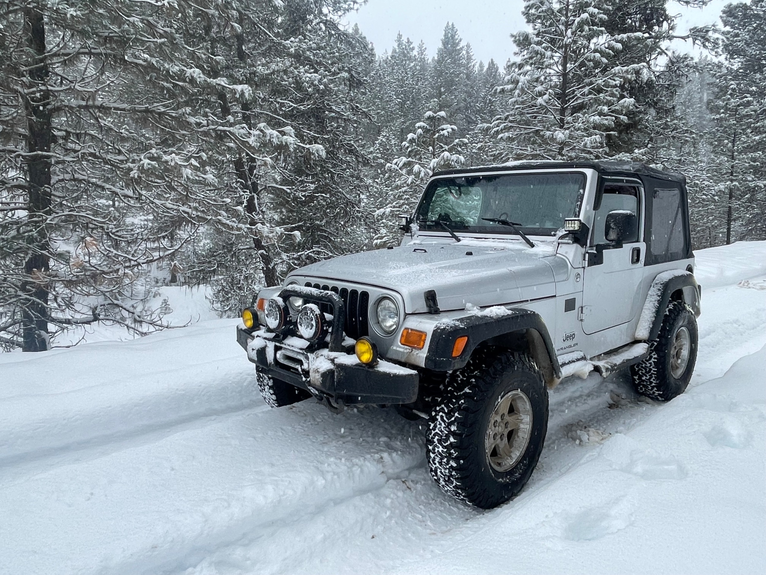

2” JKS springs and Rancho 5000x shocks. Skinny 33’s. My goal was to get to 33’s as low as I could get it. Ease of access for my wife and the taller tire for smoothing out the washboard roads. Nothing else was done and no rubbing. It under $500 for all the suspension

Pretty much what I am going for!
