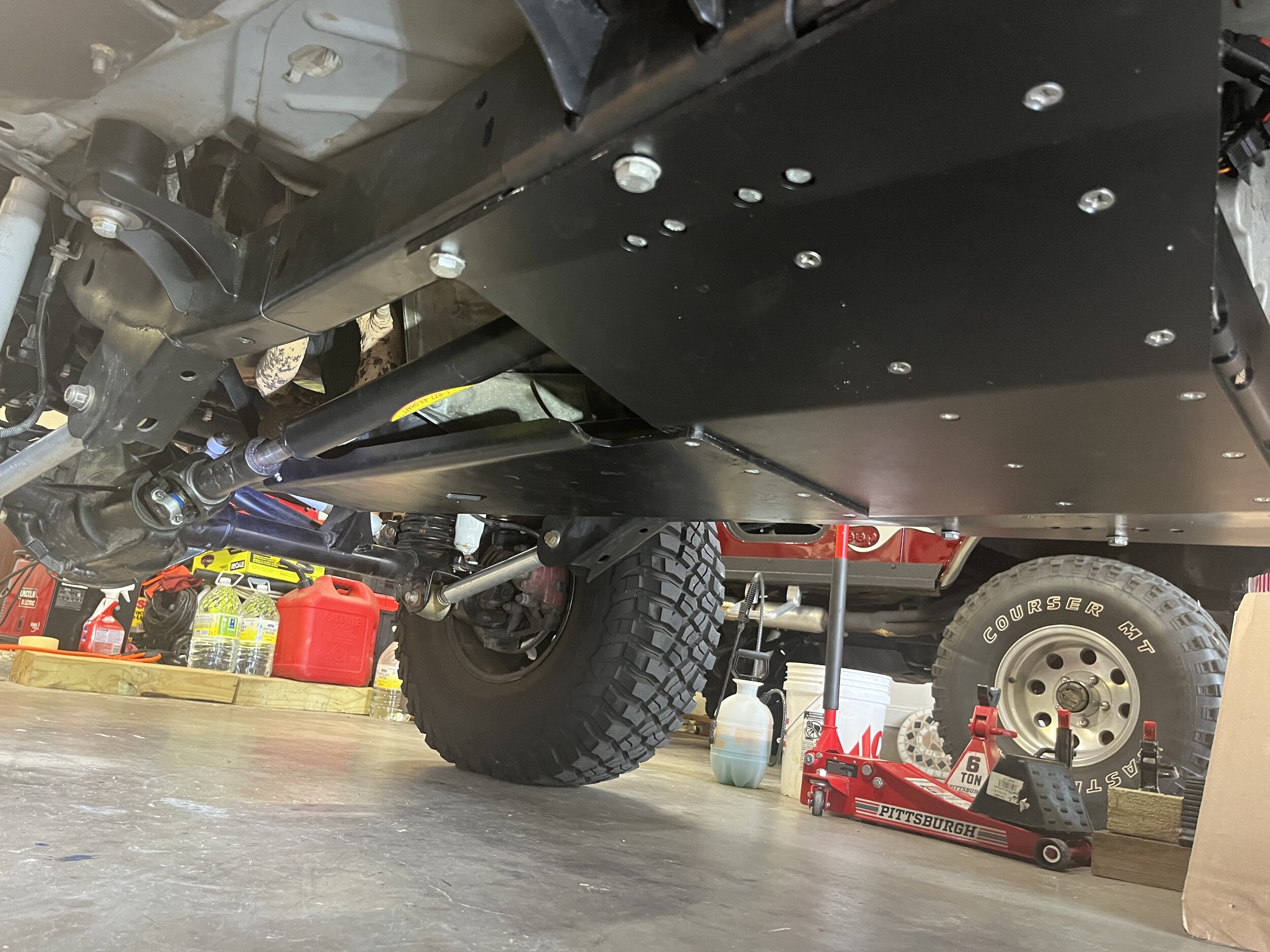

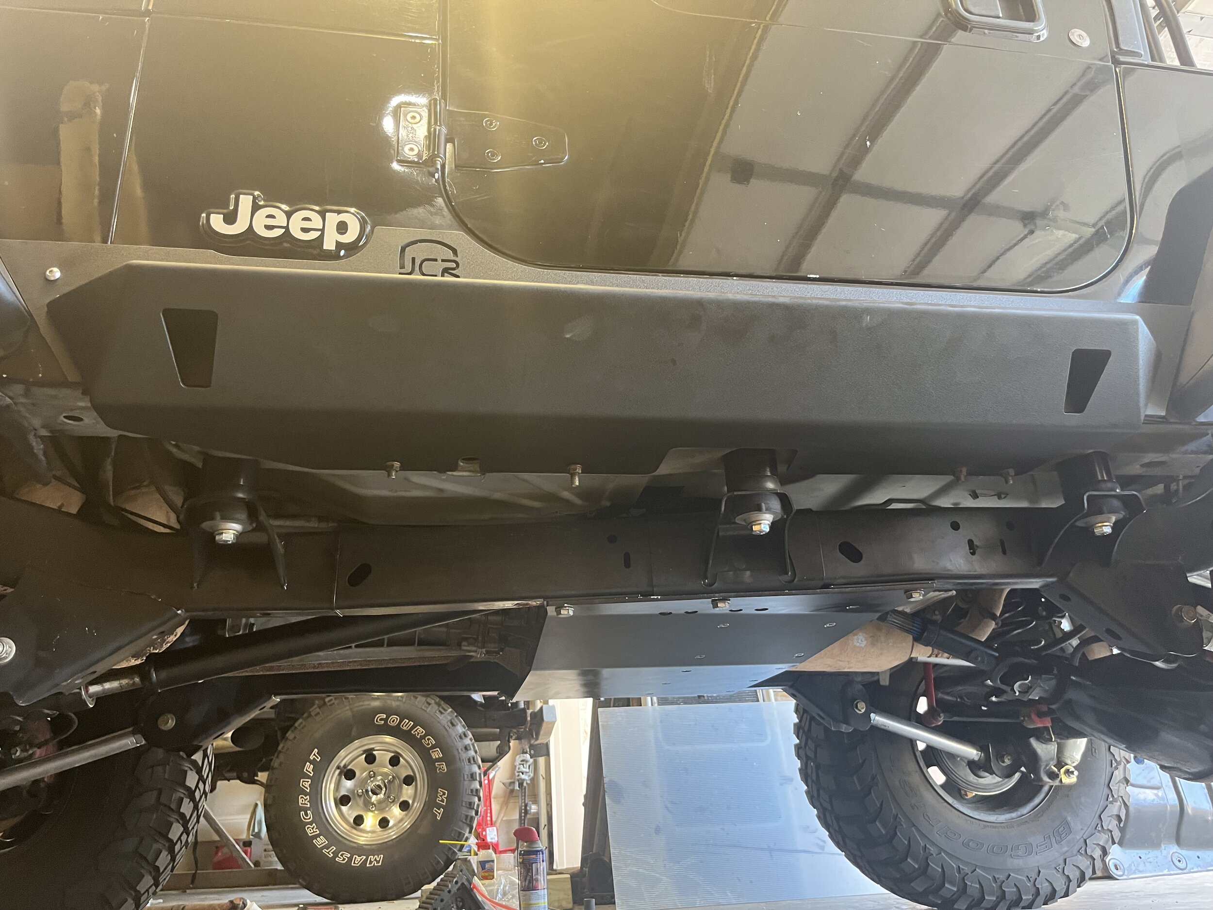

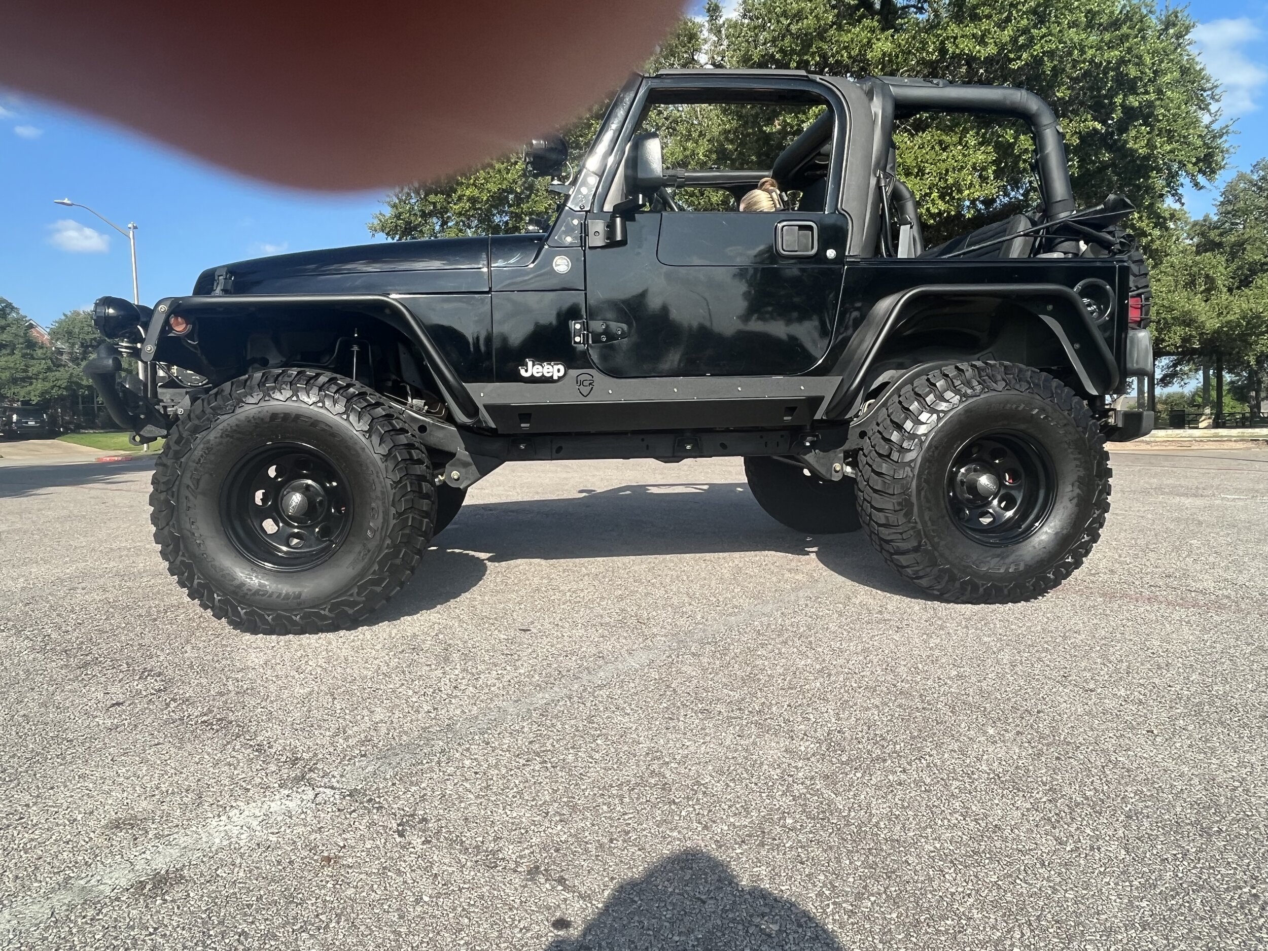

Couple pics, I have 4” Currie springs and Savvy CAs, I had to put a 1.25" BL and MML both from Savvy as well, although I should have gotten the MORE Bomb Proof MM's and 1" lift. Actually, now that I think about it, the grill snubber for the body lift, Blaine sent ones from his BL kit that were better, ha. I'd get the Black Magic BL if I was doing it now, but I bought mine and had it sitting for a year or two before install.
I got a TW DC driveshaft, but mine doesn’t have Rubicon TC, just Rubicon axles.

HA, that was right after install, and I put in Rubicon axles, It was all open, so I flap wheeled anywhere there was rust on the surface (Texas Jeep TJ) so not a lot, and hit it all with Krylon Semi Flat.

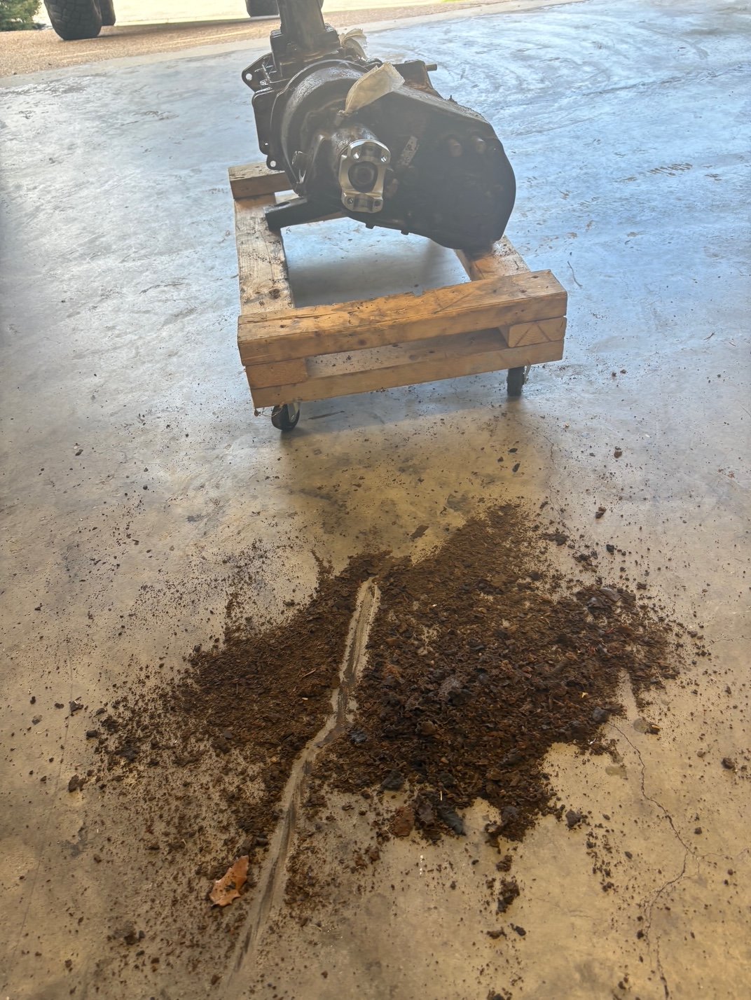

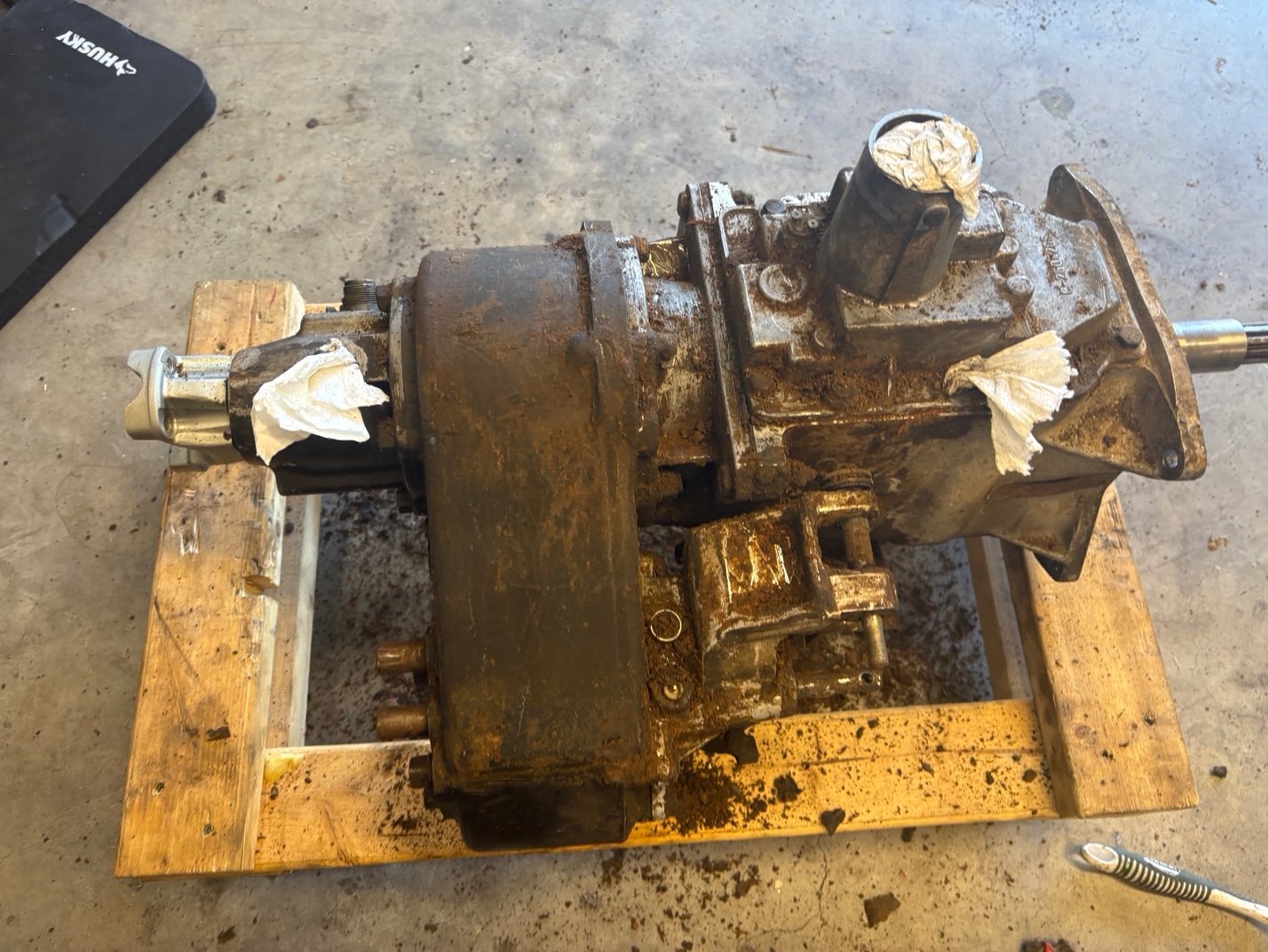

I'm getting a CJ5 up and going again, driveline issues galore, but here's the Transmission and TC, and yes, caked in East Texas red freaking clay/dirt/oil/grease mix. It's even under seal covers and caked in like a motha!
I'd rather drive in the rocks in the hill country and just wash off the dust....scraping caked on crap is getting old, ha.
