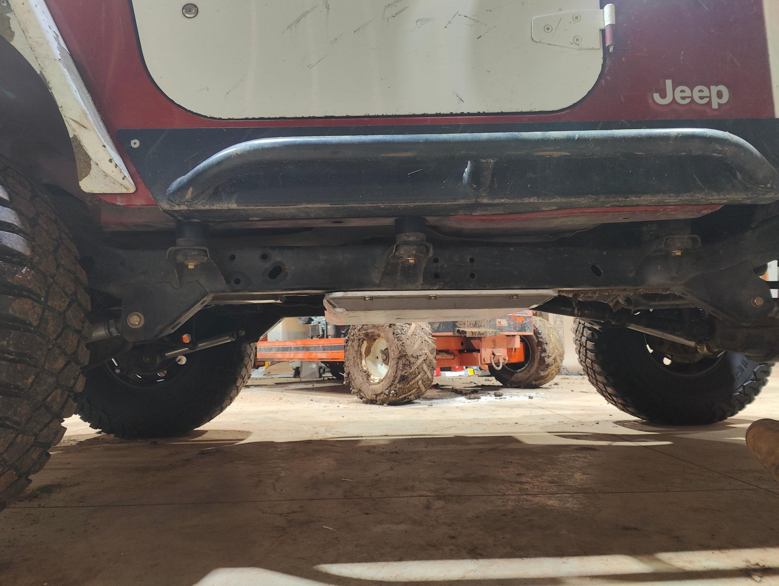

Tummy tuck is when you lift the tranny and transfer case and replace the stock (shovel) skid plate with a high clearance skid plate. The result is better clearance and it looks better
New to Jeeps... Is this caused (or exaggerated) when a lift is installed or does it occur regardless of a lift? If it is "factory" seeing, wondering why this is is set this way? Thanks!!
