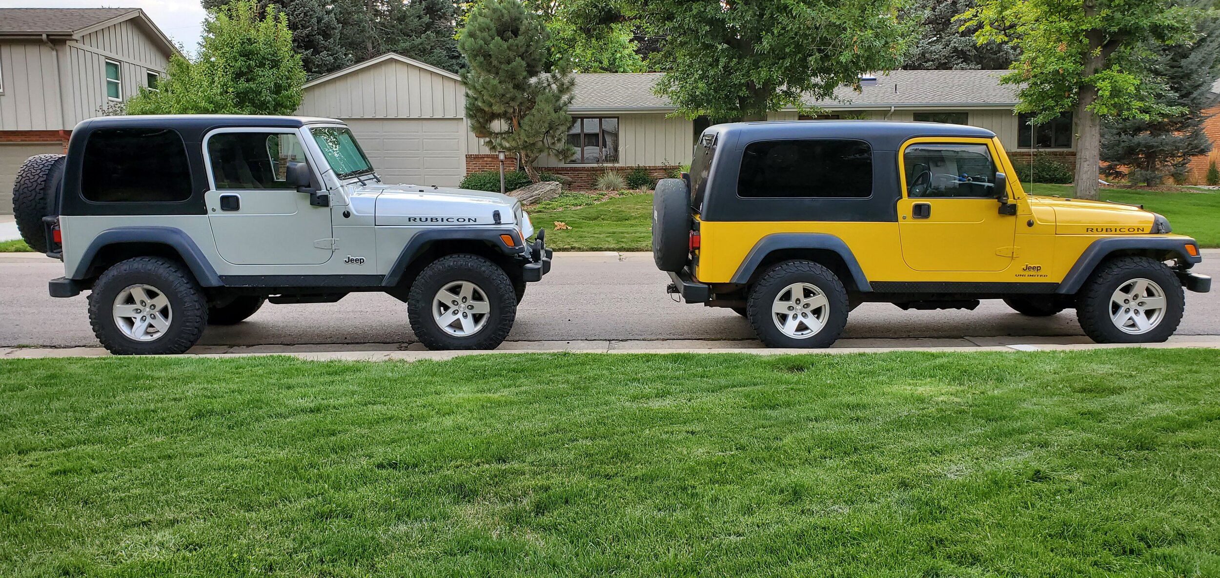

My dad's '06 LJ Rubi 6spd had some 1.75" spring spacers, bump stop extensions and bad shocks that came with it, stock tire size. He was the second owner (bought around '09 from his friend) and he didn't know it had been lifted but loves the jeep. He's in his upper 70s now and my mom is shorter and hated riding in the jeep. We just went the other way for him. Back to stock ride height with fresh spring pads, new RS9000xl shocks for that height and fresh stock style Moog control arms all around. There were some other things that got done including a ZJ v8 tie rod upgrade and a fresh t-case skid to resolve some rust developing at that contact point. His also now rides better than ever. All in the refresh was $1200 including the "new" freshly painted skid, 2k epoxy paint for his faded bumpers and factory rocker skids.
Your Dad has very good taste in color. And wheelbase too...
