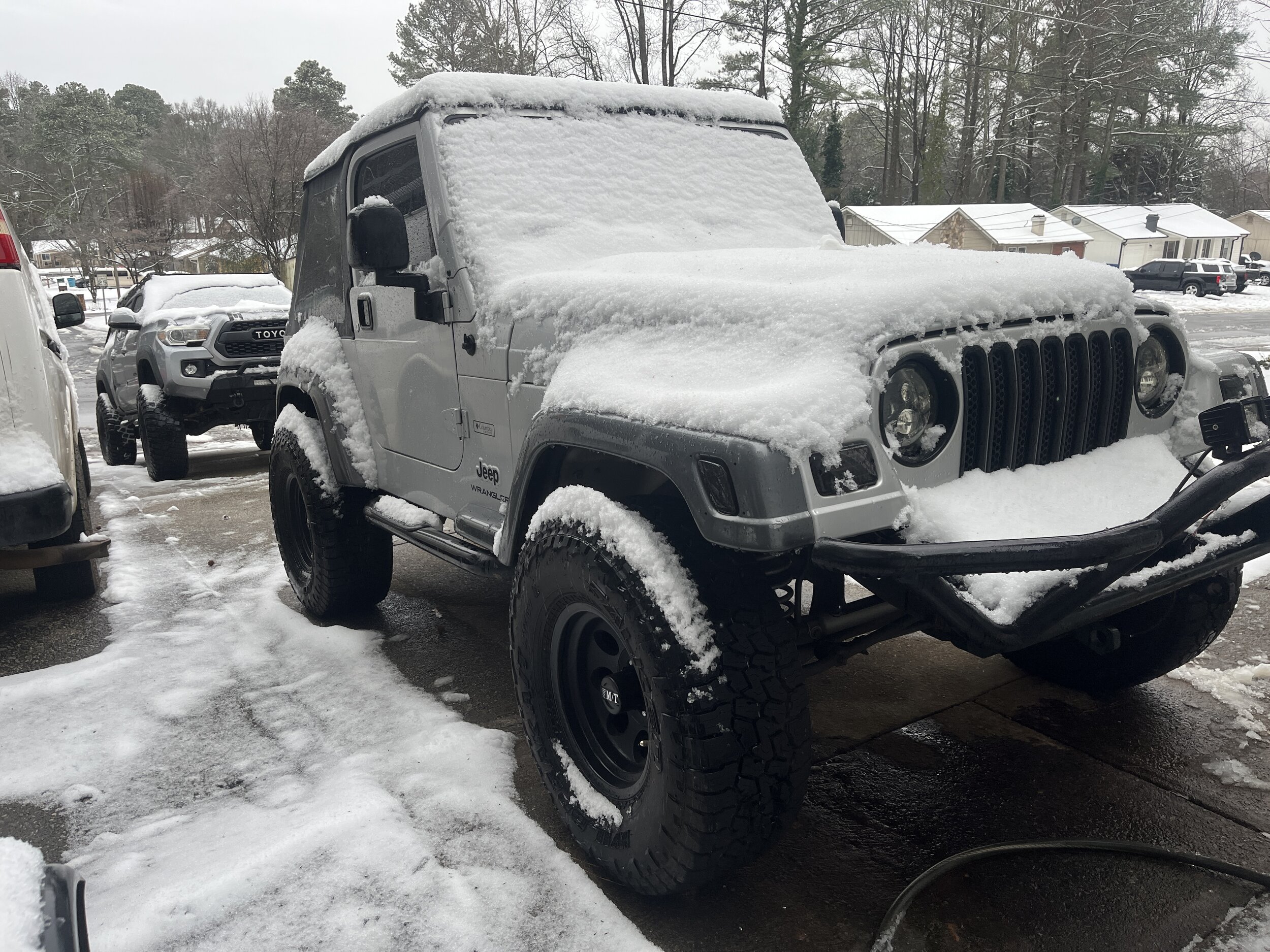

I'm looking to upgrade my suspension to improve highway driving. I'm currently running a 3.25-inch RC lift kit that was on my jeep when I first bought it, but it handles really firm. I'm looking at the ranchos rs5000x 2-3" lift shocks, but can't find a set of springs to go with them. Which springs should I pair the ranchos with, and should I replace any other bushings/rubbers on the suspension?View attachment 633048^picture from when it last snowed in Georgia
You should setup your ride height with springs and spacers and then get appropriate length shocks.
