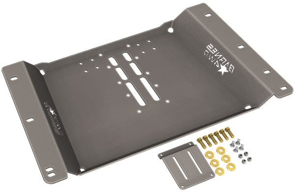

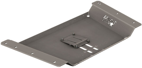

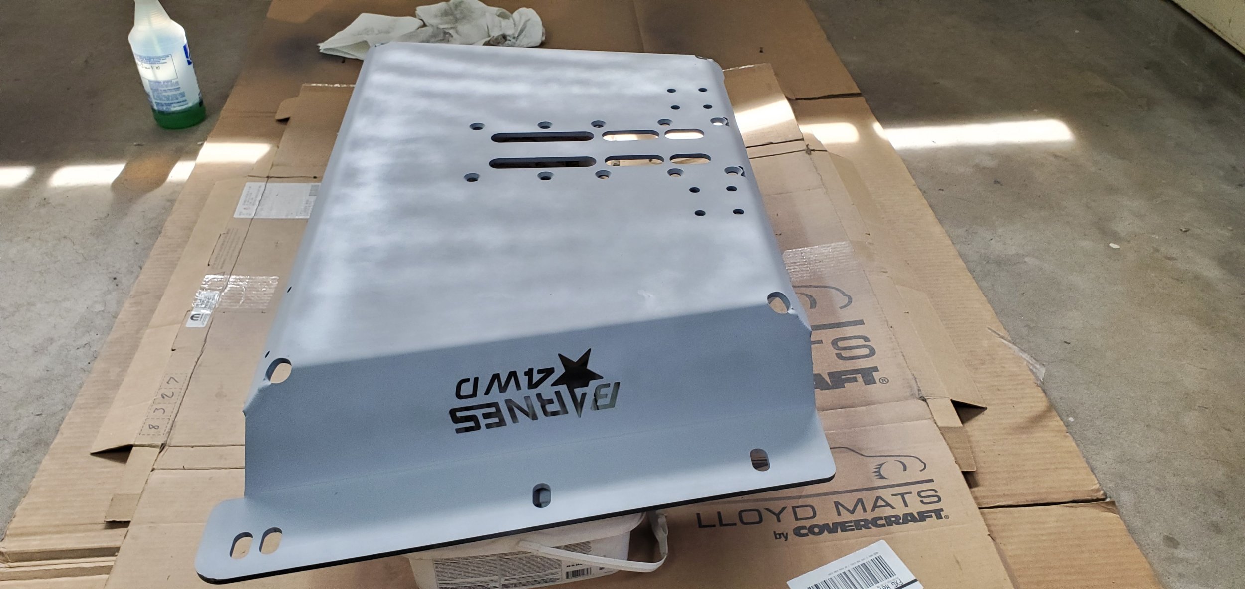

That's basically how the Barnes No-lift "bolt-on" skid works. Not sure why I didn't grab a photo of it on it's own. There is a little wedge piece that the trans mount sits on. Depending on year and transmission, you set the wedge with the set of holes that line everything up. Not sure if this is along the lines of what you are thinking. The transmission mount wedge is available on it's own.
Their photos
My photo of the other side when it was just primer and you could see how the bolts for the wedge are countersunk flush from the underside on their skid.
Their photos

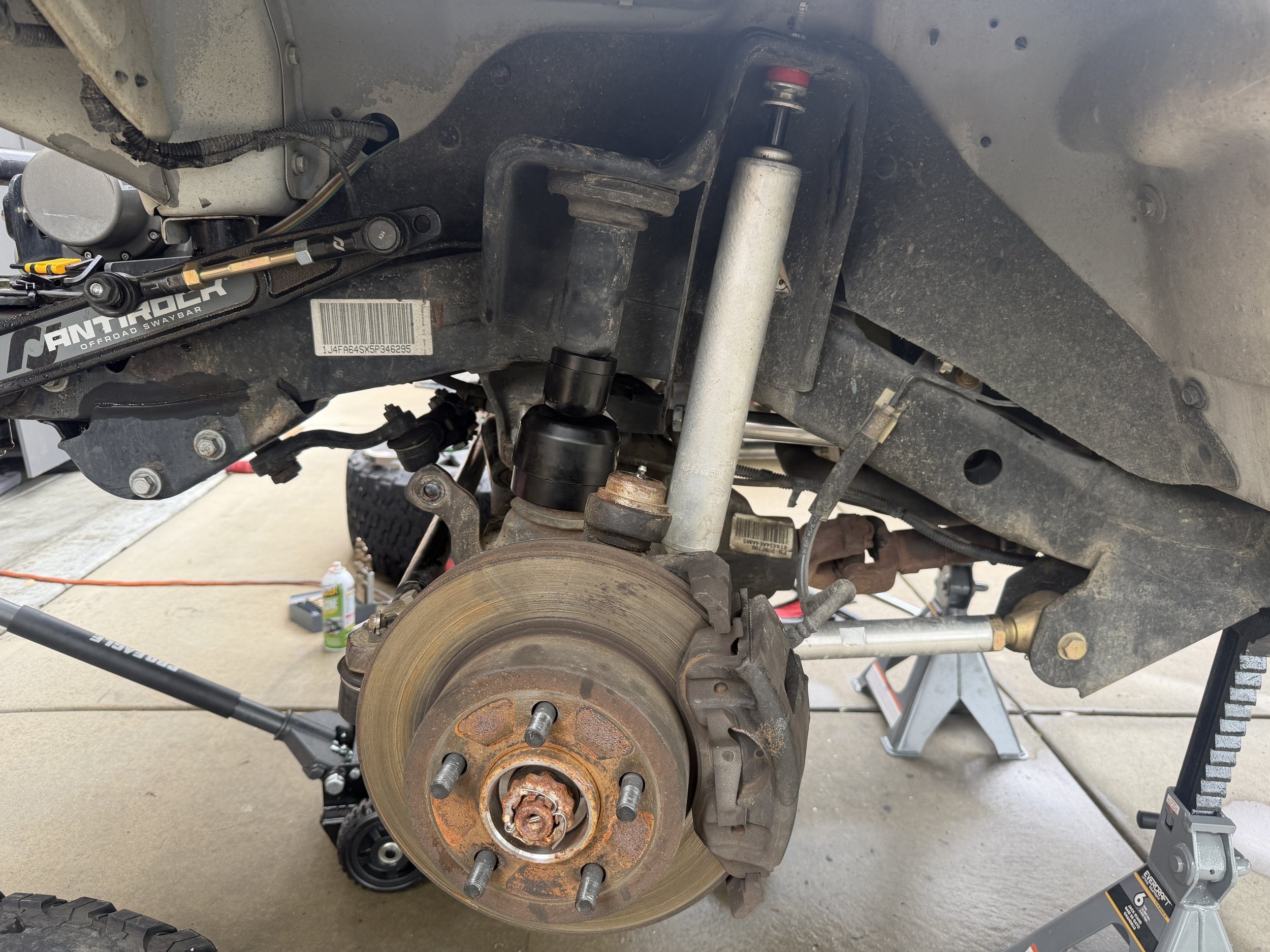

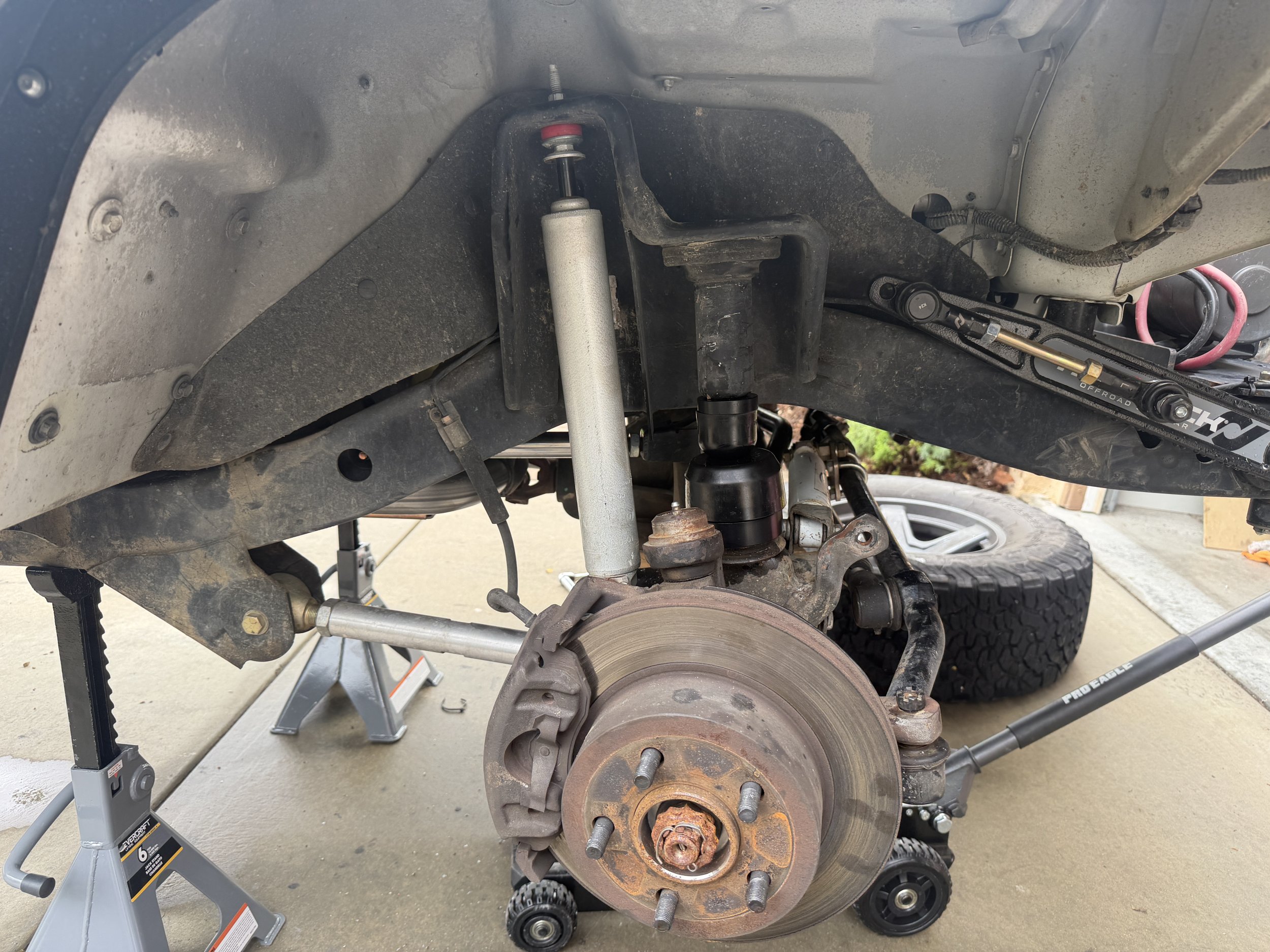

I’m having to change out the front springs after realizing that RockJock gave me the wrong size (3” instead of 4”). I got everything apart only to find out that the replacement springs were also wrong. I did however get the bump stops in, aside from having too much caster and the driveshaft angle being wrong, does this look correct in terms of axle alignment.
