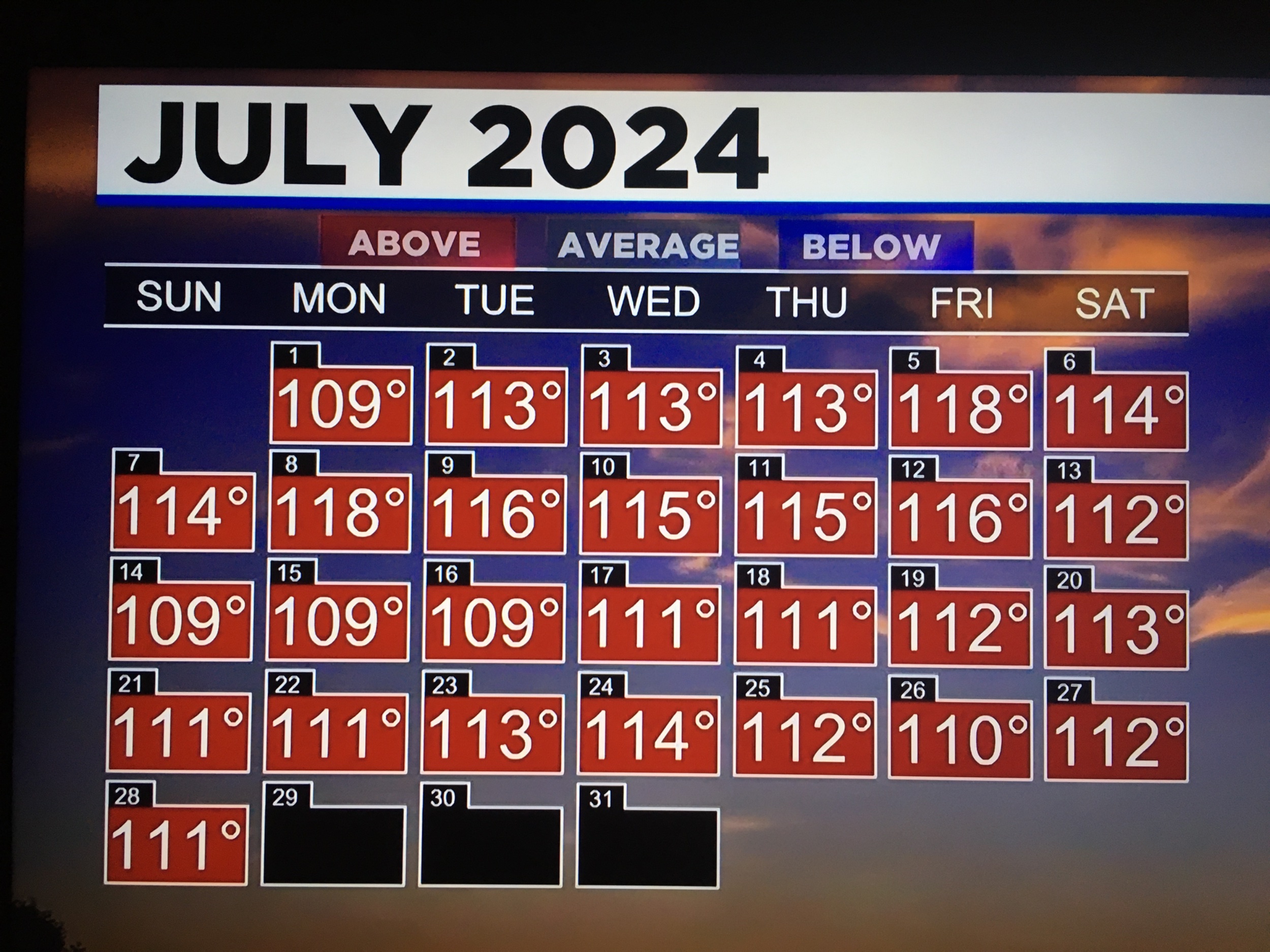

I don’t disagree, but I will take just about anything over our endless string of 115 degree days. I visited my Mom on the Gulf Coast one July and everyone was complaining about the heat and humidity - 95 degrees and 60% humidity. Didn’t feel bad to me as it was 20 degrees cooler than here.
