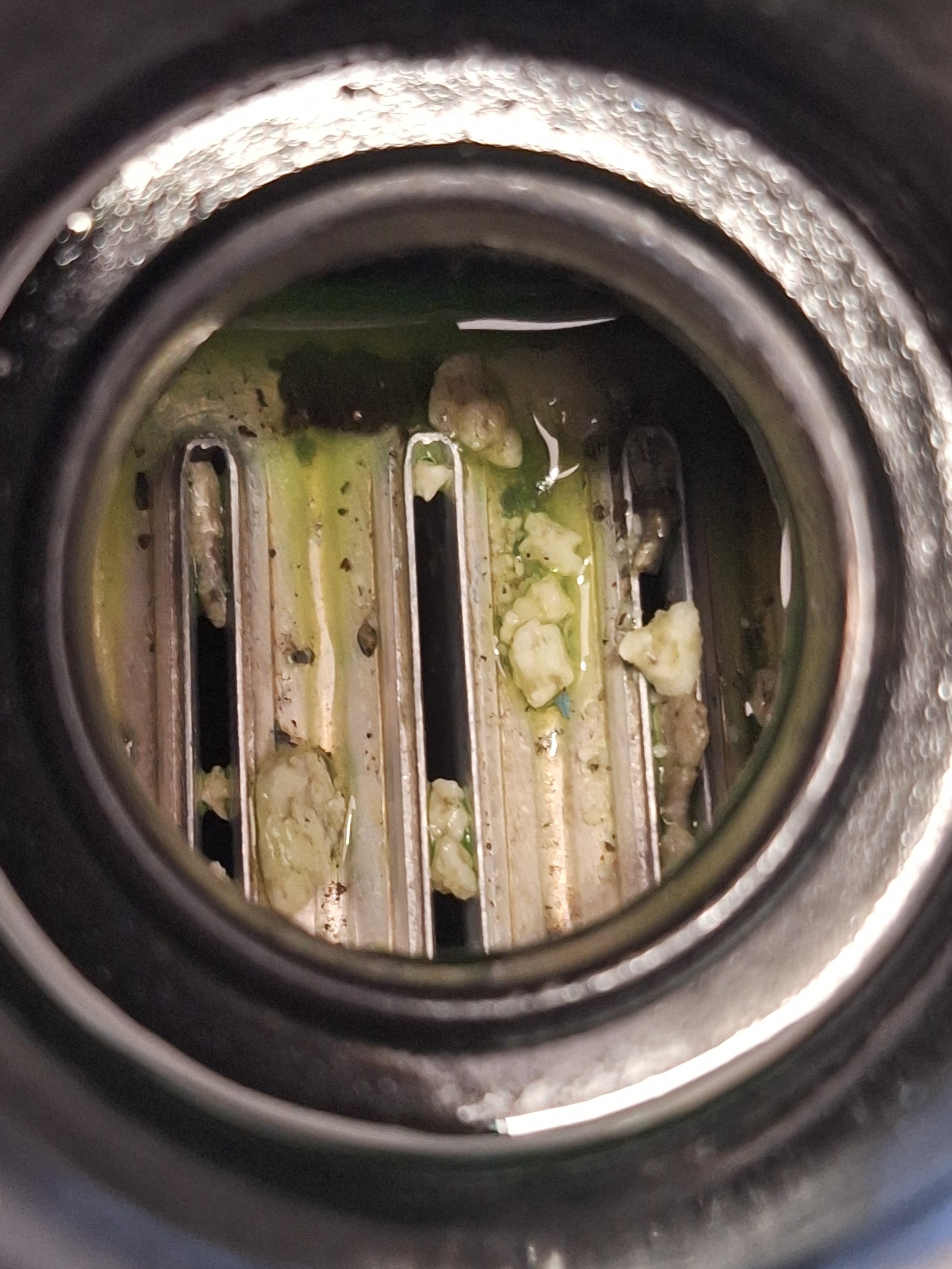

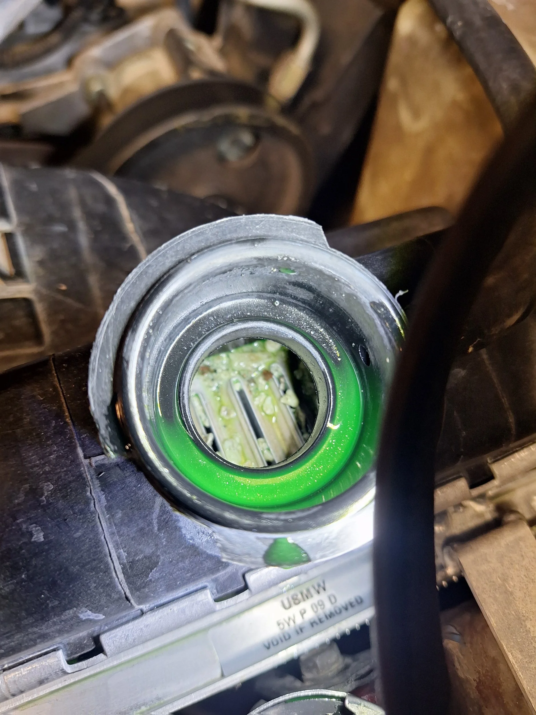

Well well well this is a new radiator lots of debris in this radiator. She is new since January...now I wonder if the shop that fixed my ac did this? Can anyone rationally explain where this all came from?

I highly recommend back flushing the radiator before you add a chemical flush.
I’ve seen chunks like this survive the chemical flush. I’ve also seen chunks slowly break down a pace that I wouldn’t want to deal with again. That’s why I recommend back flushing with a hose first.
Hose flush, chemical flush, distilled water flushes, and then add coolant and distilled water to achieve 50/50 or a bit higher coolant to water ratio. FWIW, I found no penalty for running more coolant than water (greater than 50/50).
Also, if you don’t drain the block at the end, adding one gallon of G05 to begin the final fill will get you to approximately 50/50.
