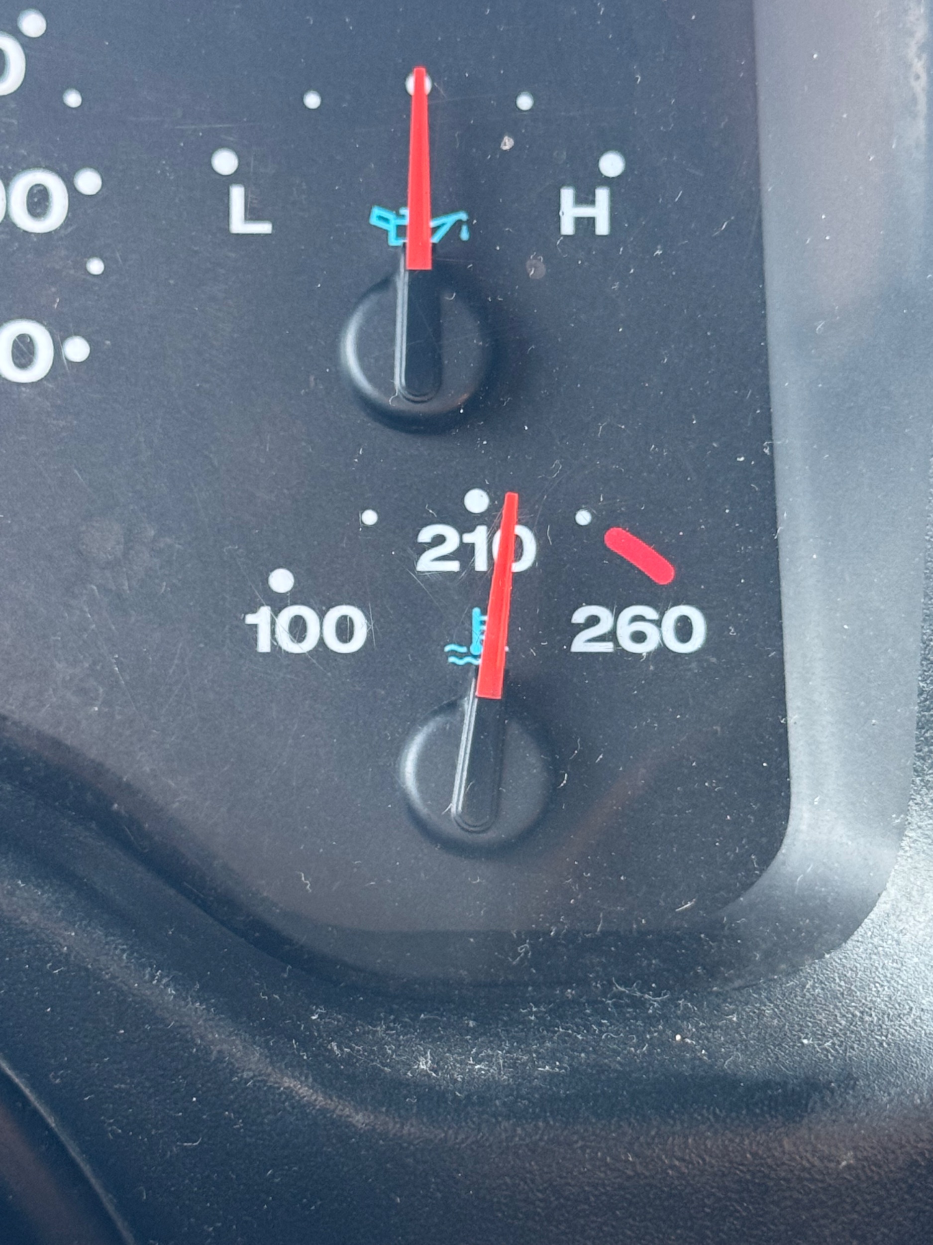

Phoenix Jeeps, where does your temp gauge sit right now?
What radiator cap are you using? Are you using the same radiator that had the crap in it? If not what brand of radiator are you using?
Does your coolant overflow bottle have boiling water in it?
Are you using a high flow pump?
Mopar water pump, I think the radiator cap is from NAPA. I've tried three, same result. No boiling in the coolant overflow bottle. Not the original radiator though, I couldn't find a new Mopar so I think I bought an OE design CSF one from Rockauto that someone on this forum I think had a decent experience with?
I think here's what I'll do. I'm going to just do a couple more chemical flushes and then flush with distilled water till it runs kit. Maybe get one of those flush n fill kits where you put that T shaped thing inline with the heater hose to backflush the system? I'll come back here if it actually makes a difference, or actually I'll update regardless. I have a feeling it won't, but I'm just going to rule out the possibility of junk in the system.
If it does nothing, I'm calling it normal.

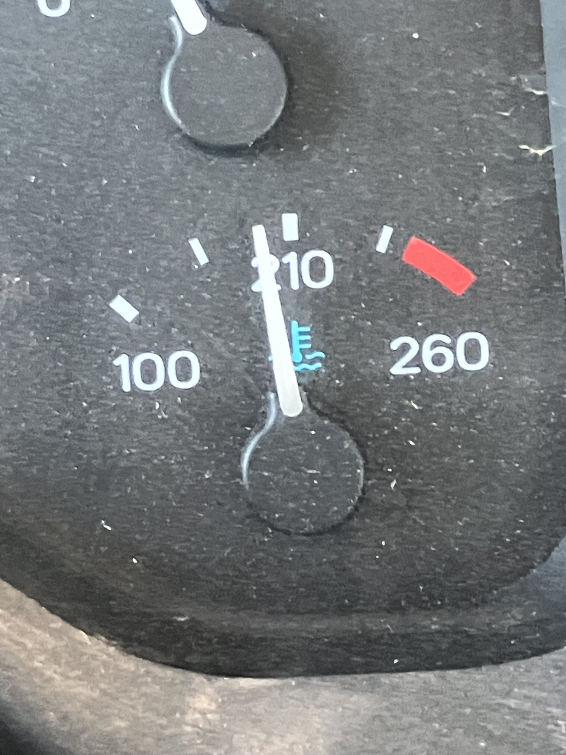

I am having the same issue!! My gauge rises at idle with the ac on. And I bought a stupid OBD2 scanner with the torque pro app and FML.. you thought you were always looking at the gauges before. So my dash gauge with shore just last the 210 like yours. But my torque dash will show the temp at 230-2450. But there will be no hissing or boiling. So I'm starting to think I've dumped all this money because of a darkness app. It's 3am in mesa now and I have been out at the jeep all night. And I went to Rolls OHV last weekend with the ac on and it did fine. ACTUALLY!!! I had the hood up while airing up for 40 minutes with the ac on full blast at 3pm and it never hit over 205. So I'm thinking maybe my exhaust gasket is bad and it's pouring more heat into the engine bay. So I bought a hood louver Monday. It doesn't jump up as fast so that's why I'm out tonight I guess I'm just gonna try the gasket. I'll be here if anyone wants to help lol
It’s not boiling over bc your coolant and radiator cap raise the boiling temp.
I would not assume you need an exhaust manifold gasket just because your ECTs are up with the AC on. In fact, I wouldn’t pursue it for that reason unless it’s so bad that you should be doing it for other reasons.
You can do a pressurized smoke test at the tail pipe and see where your exhaust leaks are. It could simply be the heat of the exhaust manifold maybe. I can’t explain why your temps dropped since I don’t have all the details.
However, I did my gasket because it was leaking and it didn’t change the ECTs climbing in idle with the AC (nor did I expect it would when idling around 800 rpm).
My AC made my ECTs high in idle and the only thing that changed it for me was installing a more aggressive fan setup. I had zero issues when the AC was off. I can’t say what you need but I wouldn’t change the exhaust manifold gasket unless you know it needs to be done. Don’t expect it to reduce a ton of heat unless it’s really pouring in the engine bay.
I’ve been able to hold my hood at any time of the year since installing the louver. I used to scold myself before which wasn’t very fun, and that was before the turbo added more heat.

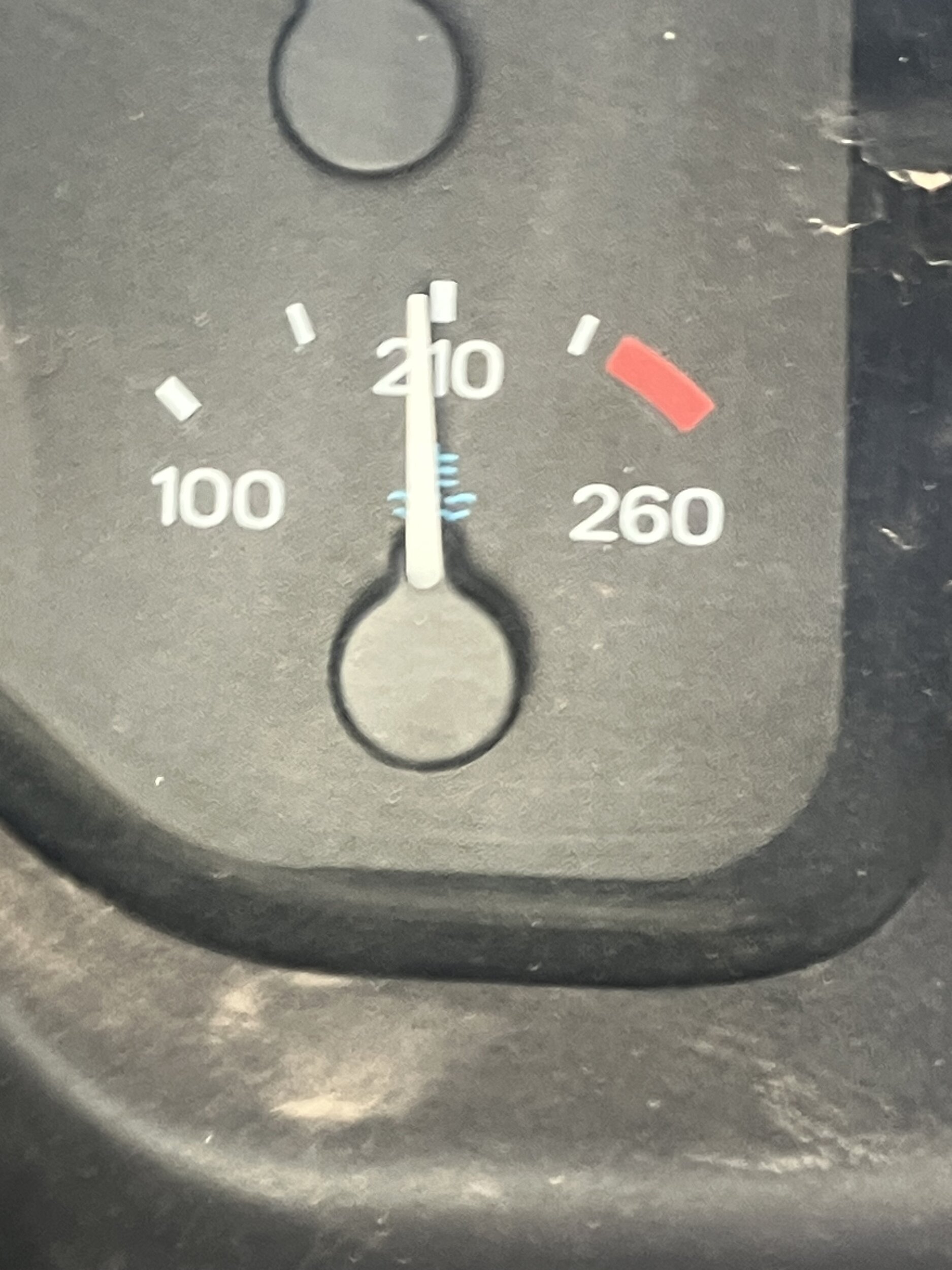

Honestly, I think this might just be normal. I did a little digging through the service manual and it says that the needle on the coolant temp gauge, atleast for my 06, will not move into the red until the temperature exceeds 261 Fahrenheit. If you do find a fix though, if there even is an issue, please update us! It would be nice to atleast have slightly colder A/C even if the temps at idle are okay.
