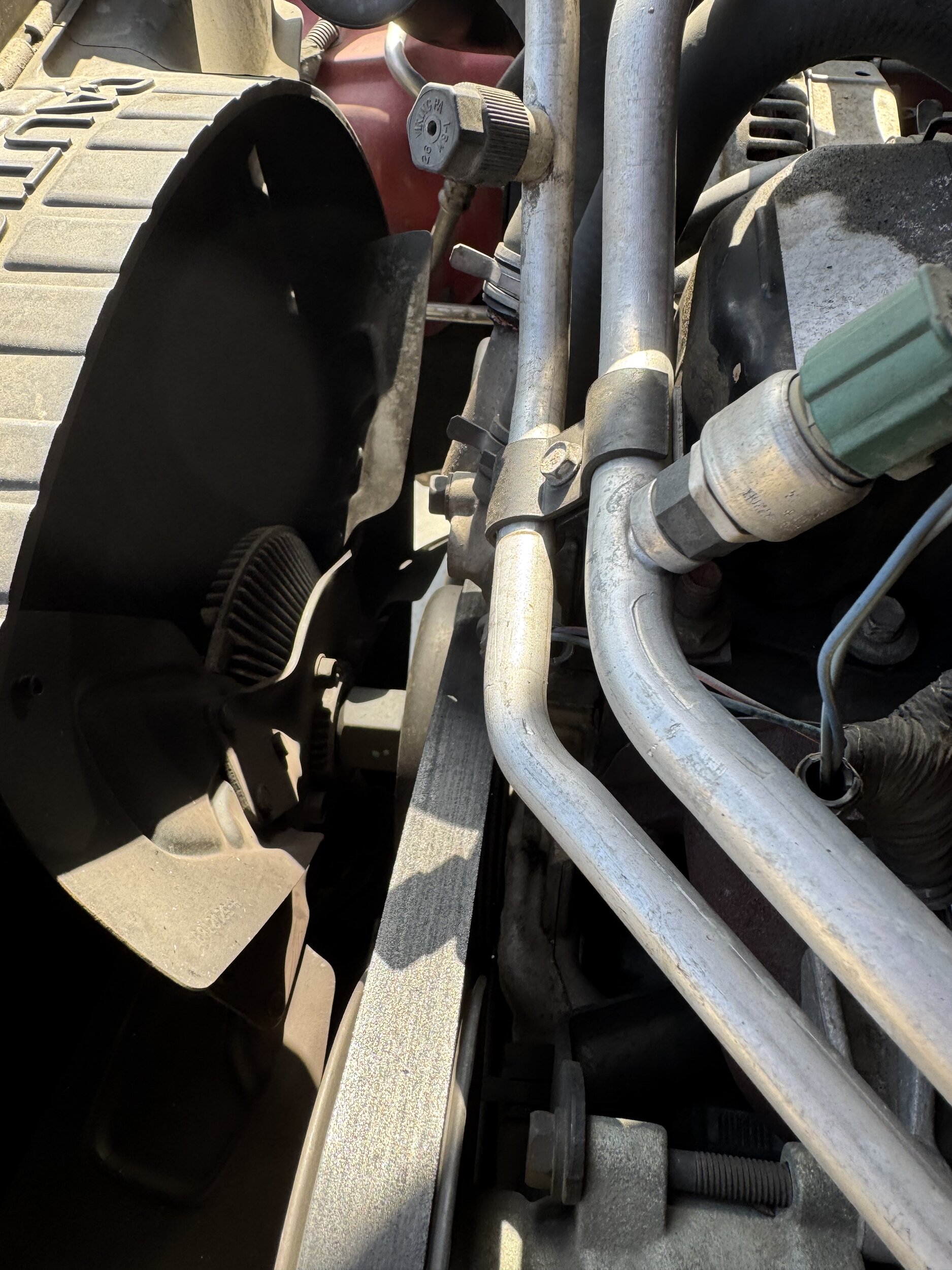

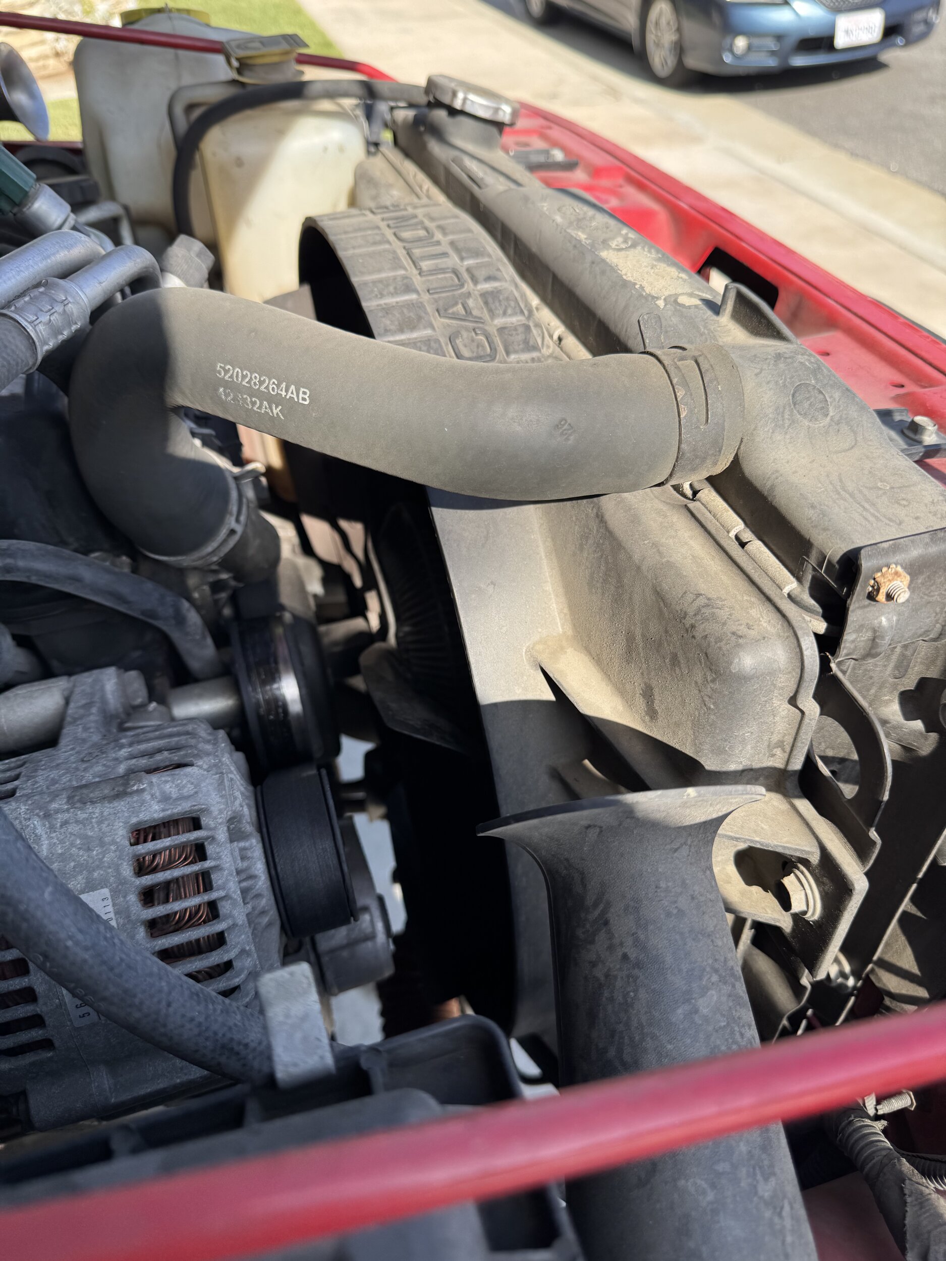

Have you confirmed that your fan is pulling air from the radiator rather than pushing towards it? Send us a photo of your fan orientation if you aren't sure which way it should point.

You are fine when you have airflow driving, so we already knew your water pump was fine. You need a good fan clutch to have the fan pull air through the radiator when you are idling (again, I'd confirm the fan's orientation is correct as well).
What fan clutch are you running?

Don't assume a fan clutch works well just because it's new. And spinning it in idle isn't very helpful because that doesn't tell you how much it's potentially slipping when things get hot (I know this all too well).
