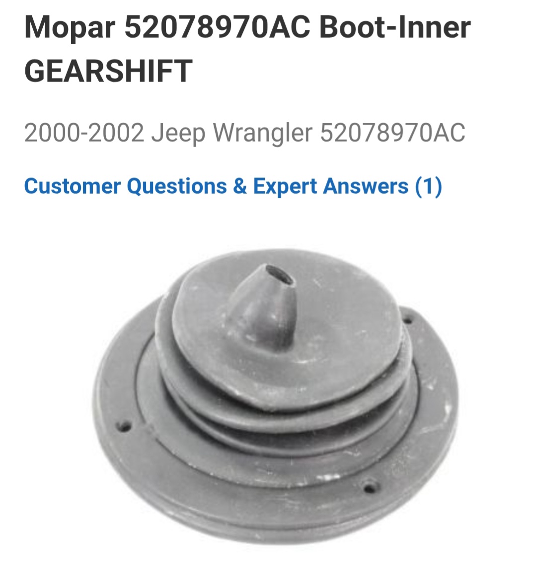

You don’t need a temp gauge and sensor on a manual transmission. If you remove the console and look at the lower shift boot it may be torn. That’s the number one way excess heat enters from that area. Replace the boot and add any additional heat blocking insulation and it will lower the in cab temps.
So when we lift the body soon to swap the motor, this boot will be right there?
It’s on the inside of the tub under the console just under your shifter in front of the cup holder.

sometimes a torn/ disintegrated inner boot can let heat in
Having said that the transmission tunnel gets hot to the touch even when everything is up to par. Additionally you can check/change the fluid
Having said that the transmission tunnel gets hot to the touch even when everything is up to par. Additionally you can check/change the fluid.
I checked this today and it looked pretty destroyed lol
