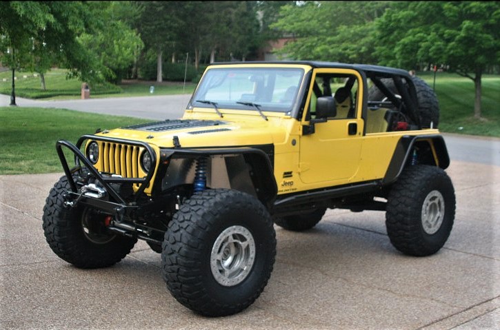

@NashvilleTJ can hook you up with tips on getting rid of your engine, transmission, and suspension issues. My lifetime savings wouldn't buy me one of his tires/wheels. 🇺🇸
p.s. Ignore the yellow color. He told me that was the only good color Jeep ever produced. 🥳
