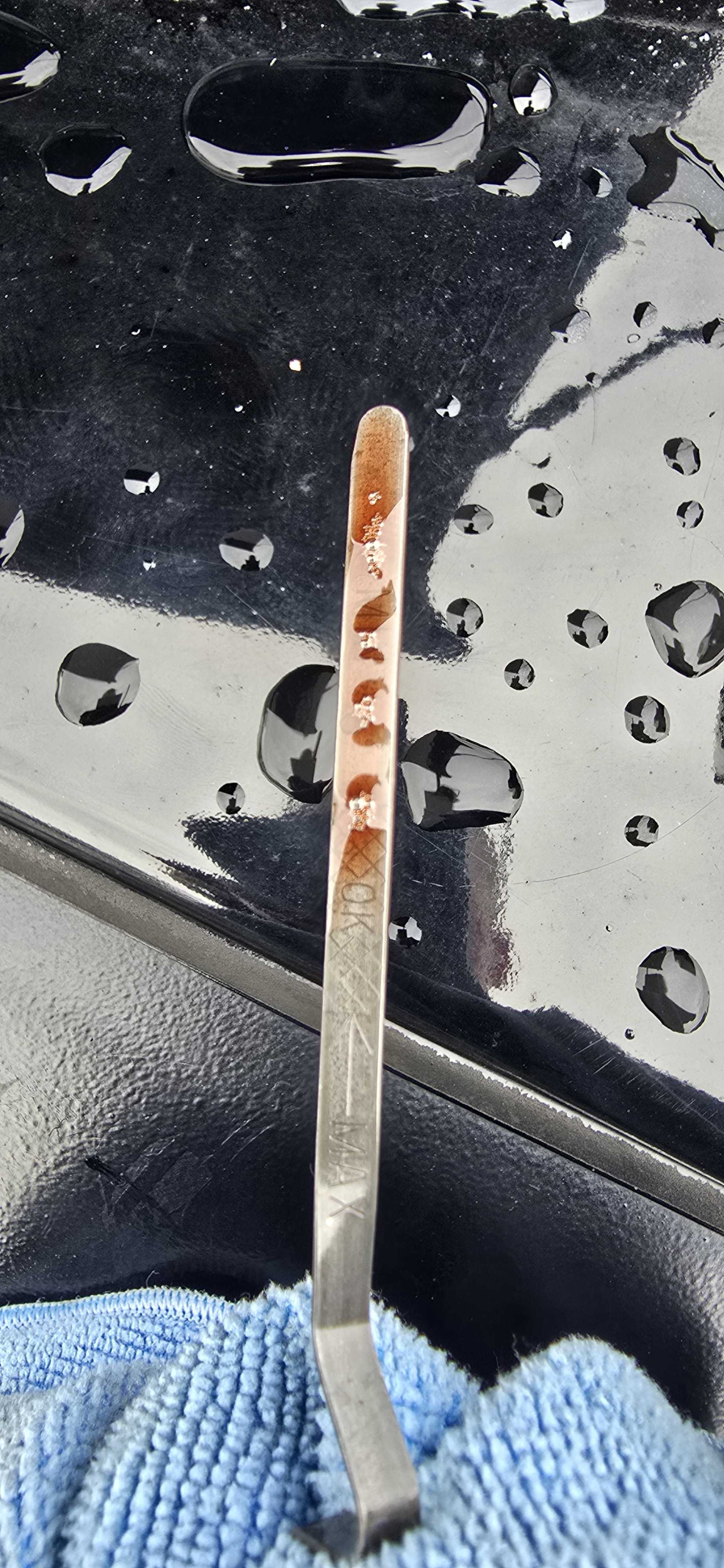

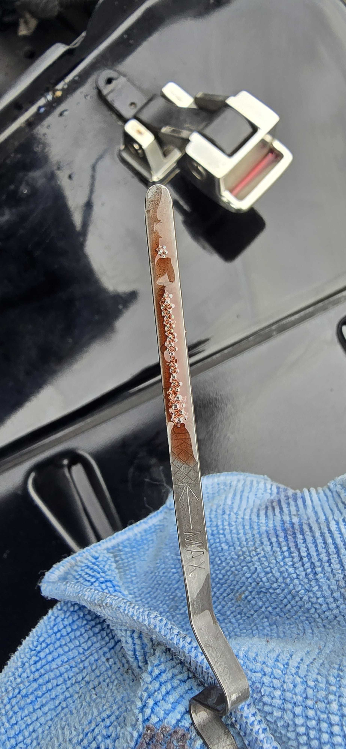

no, that's a problem too. I would add more till it registers.......maybe first post a picture of the end of your dipstick, just to make sure. But if you put too much in it will just puke it up to get to the right level.

I'm a little concerned that you said "pink"....pink sometimes indicates the presence of water. Brand new its more of a cherry red, but I don't mean to split hairs on color. Older fluid tends to get darker and darker, never more towards the pink unless you get water in there. Truly pink pretty much means you need a rebuild, because water breaks down the friction materials on the clutches & bands.
Assuming that's a false alarm, you can just dump new ATF+4 down the dipstick tube until it reads full. Don't use any sort of universal transmission fluid, especially if you're already having trouble. Any brand of ATF+4 is fine, I use the stuff from Walmart regularly.
Alright so update for everyone, with photos. The fluid was in fact closer to a maroon, and i put a whole bunch of ATF-4 in it. And took her for a spin. I am sorry to say i am probably retarded since it no longer shifts hard from first to second.
