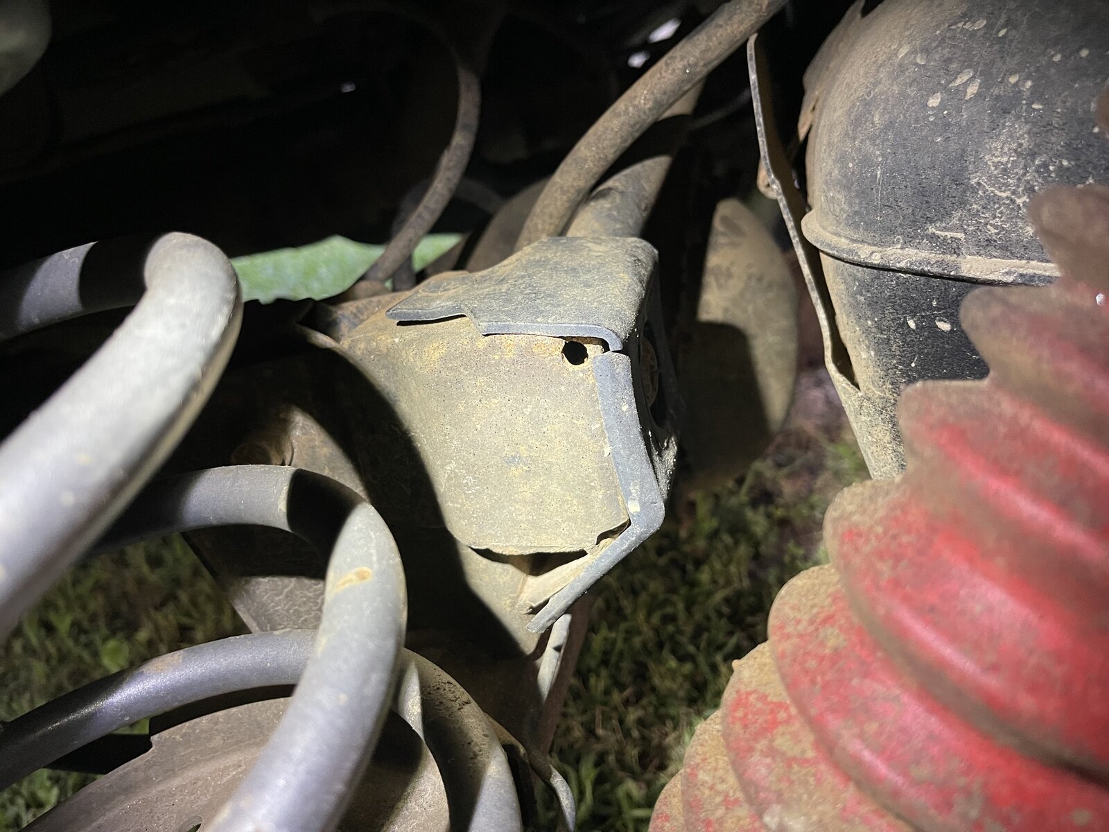

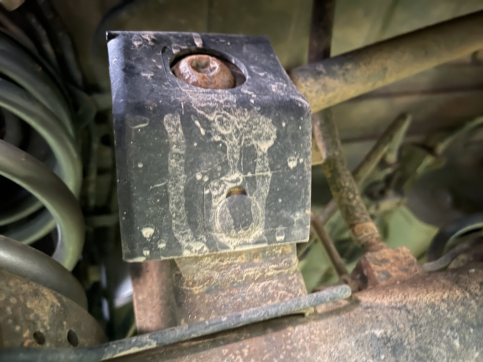

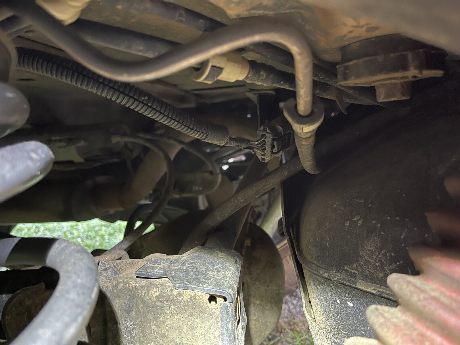

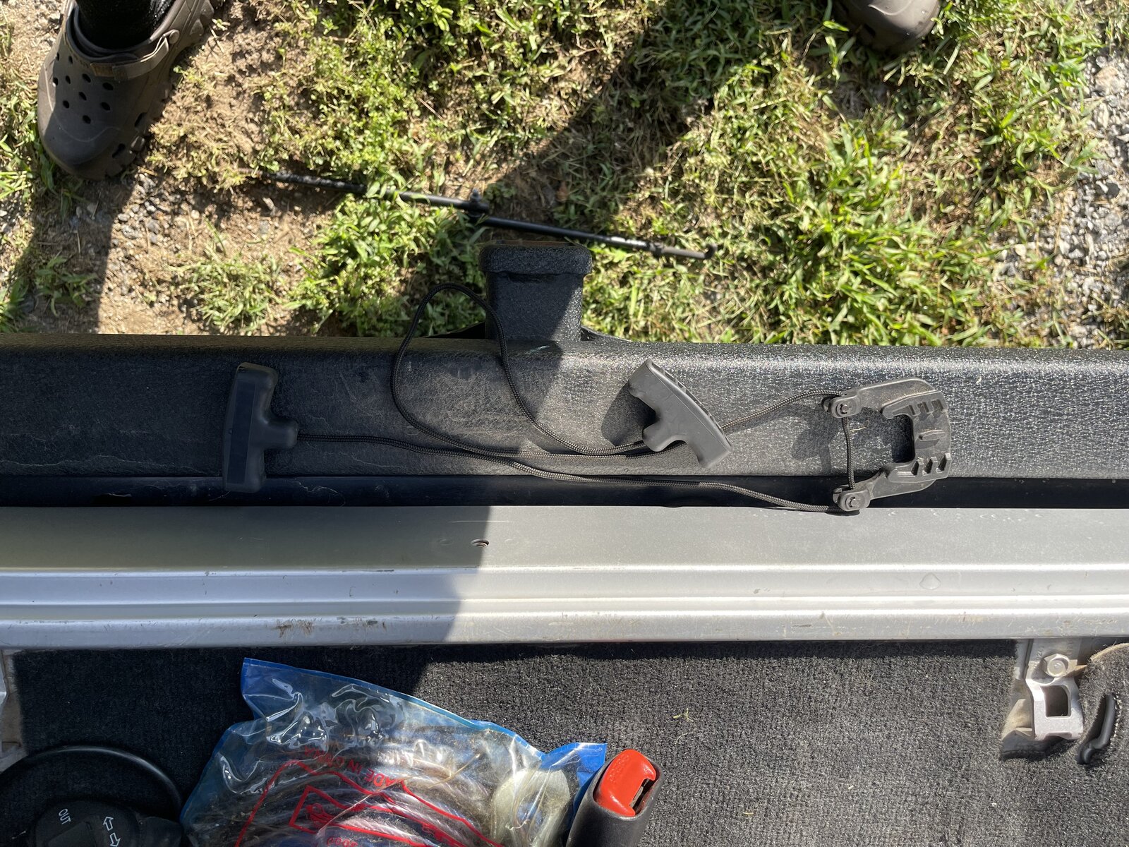

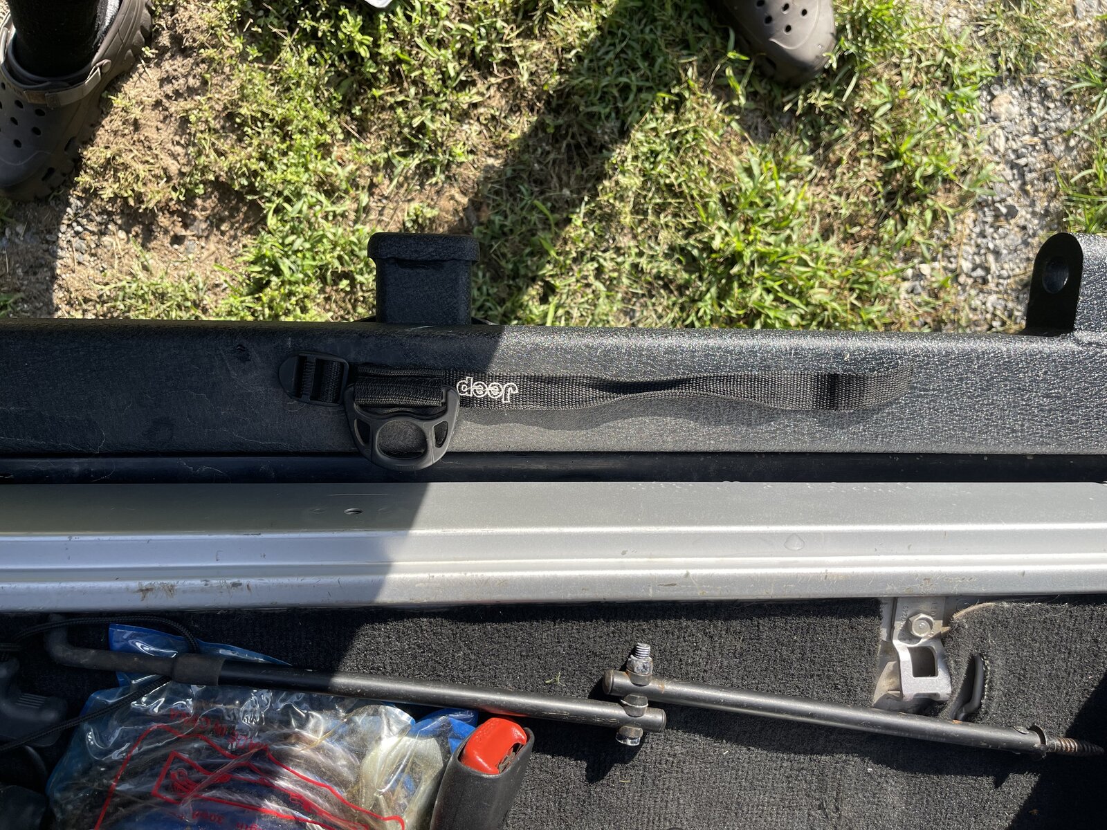

Can anyone enlighten me on what these are? Came in the back of the Jeep…
(Pieces on bumper)
