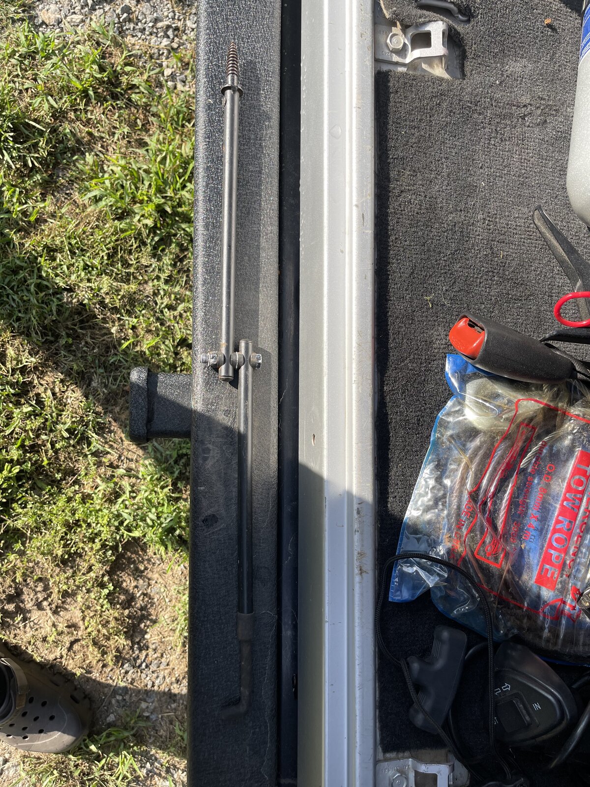

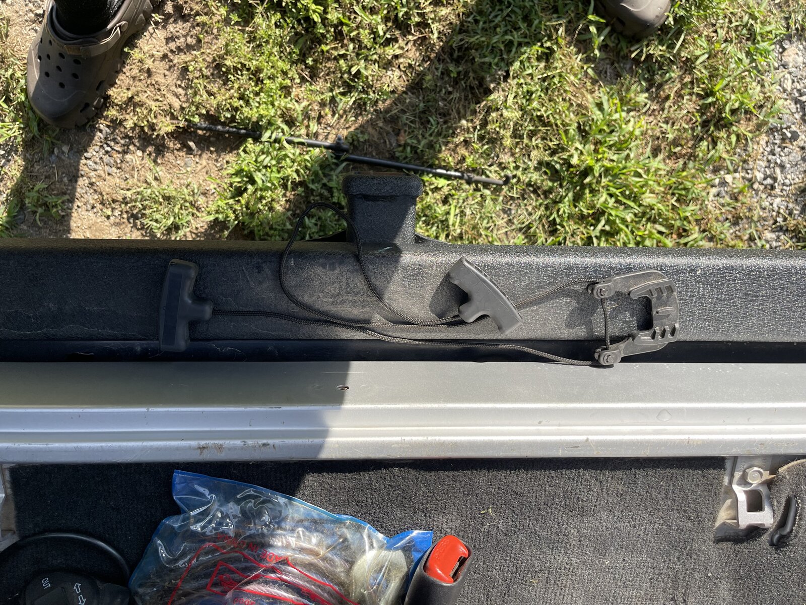

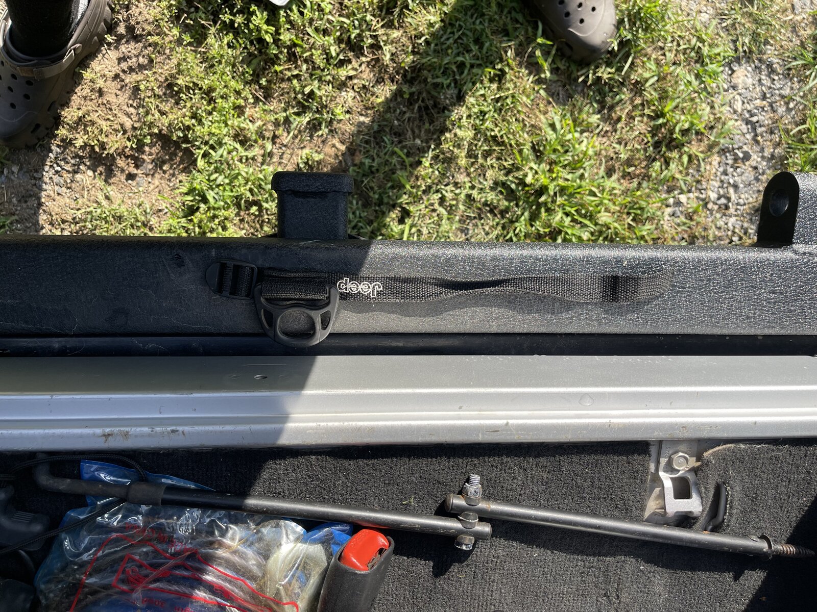

That looks like a crossbow cocking rope and a screw-in bow hanger! (Not the Jeep strap; the other 2 things)

I'll be dang. After googling both of those I believe you are right! Never really got into bow hunting...

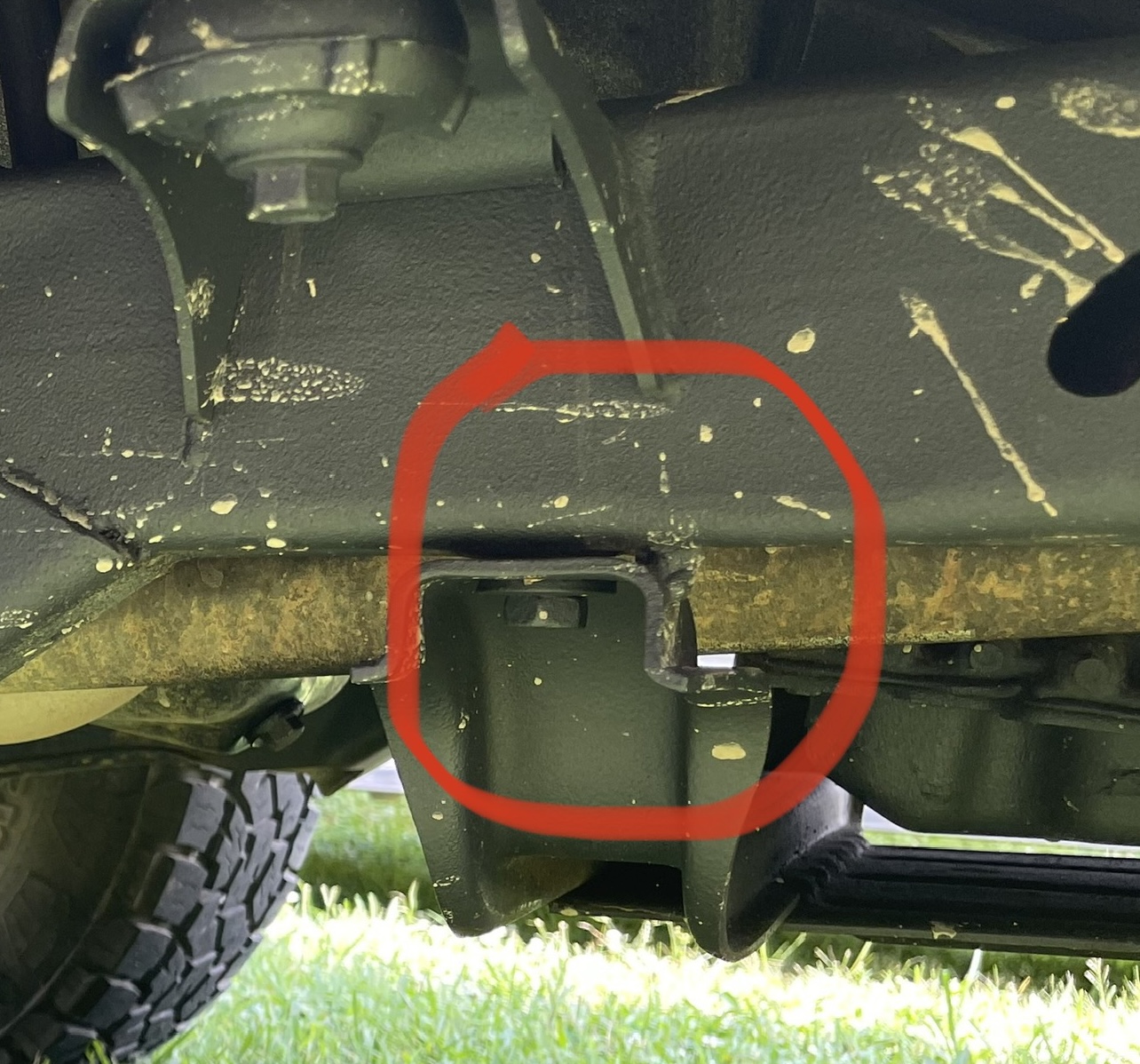

Also noticed that on the driver side the cross member forward of the transmission is spot welded. Is this normal?? Or should I expect a problem dropping this?
Maybe the bolt kept spinning and they wanted some insurance.

That's what I'm afraid of. After looking around more on the forum, seems like a common issue. I guess I can cut the tack and see what's going on. This is just a cross member for the small skid plate right? So if I don't get it back on this weekend no biggie?
