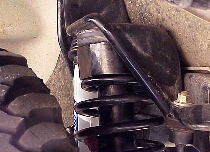

1. Best I can tell from measuring the springs (from the chart here on the forums...this place is so helpful!) I have a 2" suspension lift. No body lift. There is a puck on top of the front spring. Maybe an inch thick at most (might be factory???...I know I should have took a picture lol. I'll try to get some this evening). I like the height and level and it has brand stinkin new 31s so I plan to keep it as is at least until these tires are showing some serious wear. With this setup, should the transfer case be dropped any? I have a little bit of vibration when starting off. Nothing major.

BB lift spacer and stock rubber spring isolator pic for reference. We need pics of underneath (shocks, springs, sway bar links, etc) to diagnose clunk issue. If you have 2" lift springs with stock length shocks or sway bar end links, that would do it. Temp at 210 or slightly higher is normal.
1. With a 2" suspension lift and no body lift a transfer case drop wouldn't normally be needed.
I'm betting mine is just the stock isolator. I'll get some pics and update. Thanks!
