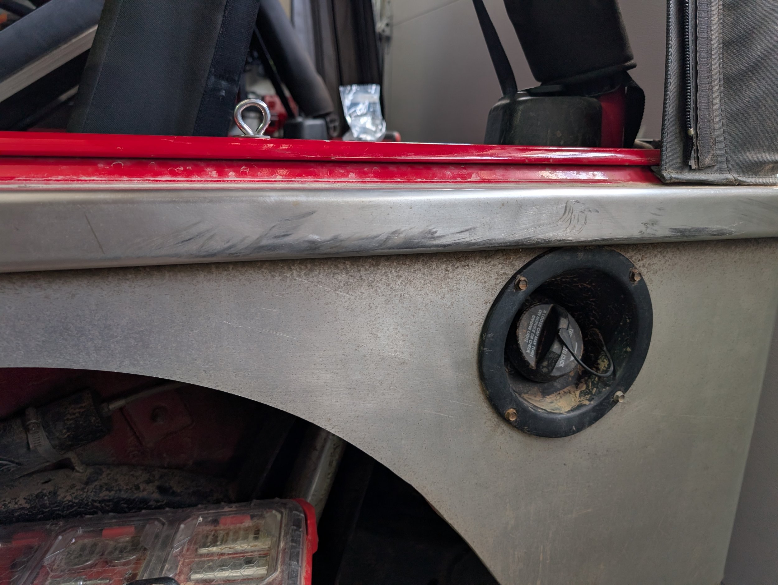

The padding is now mostly gone from mine. If the scratches bother me enough, I can paint those.
