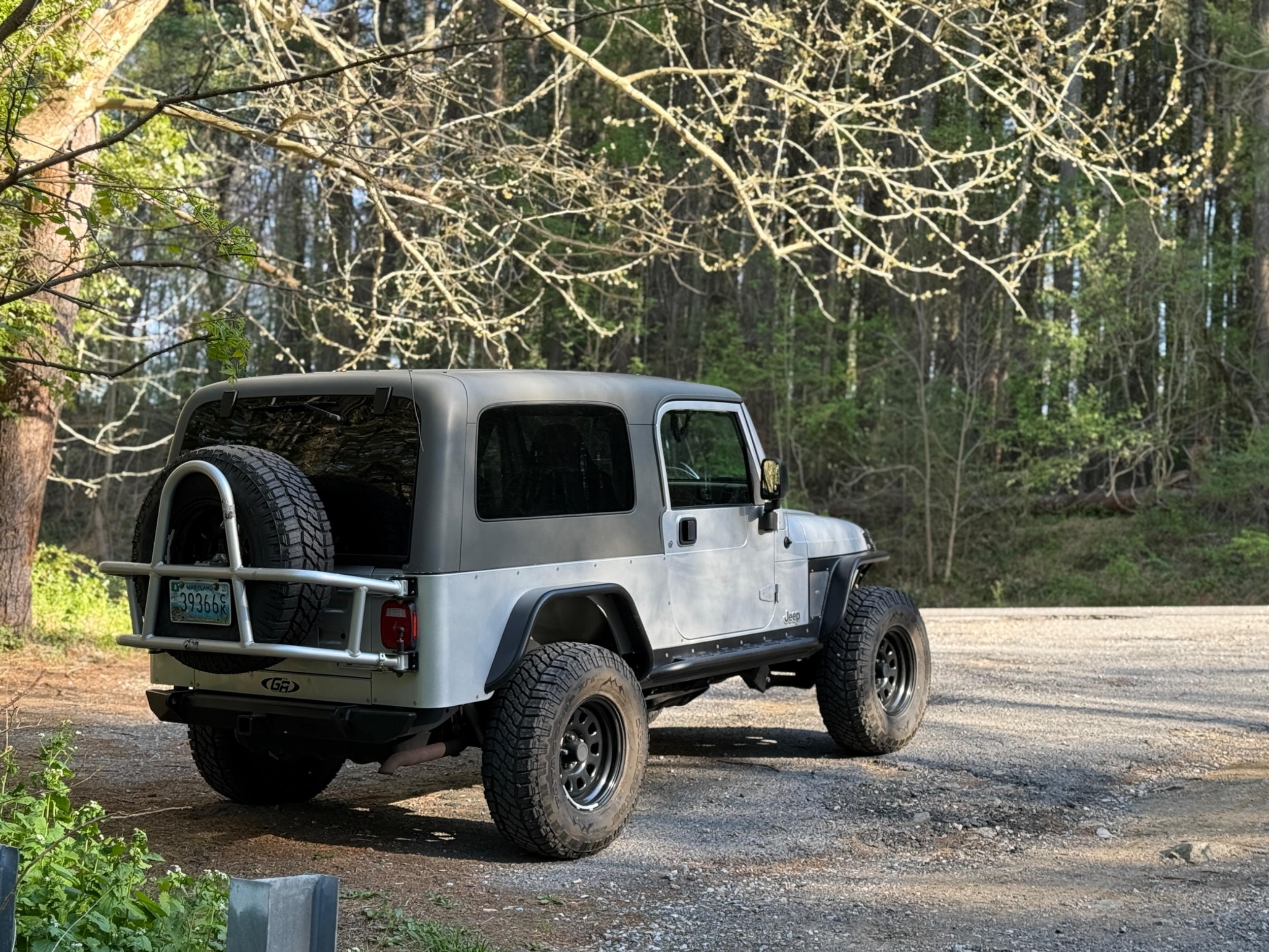

Today, just about ready to finish installing the last two links on the rear double triangulated 4 link, and it will sit on some JKS 3" Lift Springs, coming down an inch or so with a 1.25" body lift and 1" Motor Mount Lift. I still have some work to do on removing the factory welds and parts of the upper control arm mounts on the frame.
I had planned to go with a nice dream set of Hutchinson Double Beadlocks, but they are 8-10+ weeks before they ship so I grabbed a cheap used set of wheels to use for now.
This is where I stand right now, still need to finish up the suspension install and hopefully work out the exhaust sometime this week.

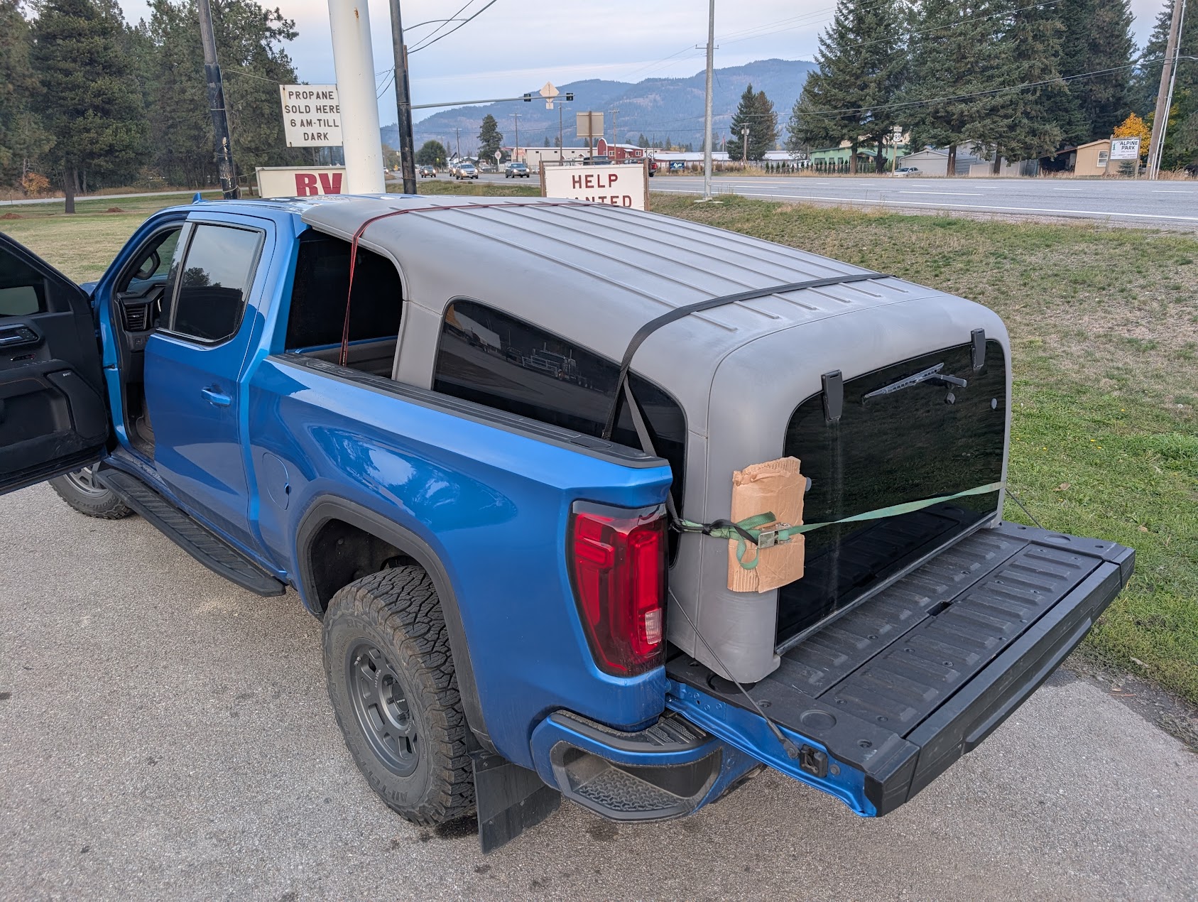

Yesterday, I drove 10 hours to score a deal on a factory grey hardtop for this build, I've never personally seen one outside of photos online so I didn't really believe it was anything other than a faded black top, but it sure is the grey top. It'll go on the Jeep today for winter months, and snow wheeling.
Nice - curious what it wound up costing you??
I paid $2,200 for it, everything about it is in pristine condition, seals, wiper motor, inside is absolutely perfect and clean.
That's a fair price for a mint one. I've paid $1500 and $1800 for both of mine. FIrst one was dropped and damaged in storage. The one I found to replace it had a few knicks in the fiberglass, but was the nice gray color instead of black. You're gonna love the two-tone look on the silver.
The real question is how FAR did you have to drive to get it! - edit: I can't read. You said 10 hrs, that's a good drive. Mine was 4 hrs. Then there was one on marketplace an hour away the next week!

It was 5 hours each way to drive, total of 10 hours for the day.
This build is really coming together, just a few things left to finish and I can get out on the trails.
