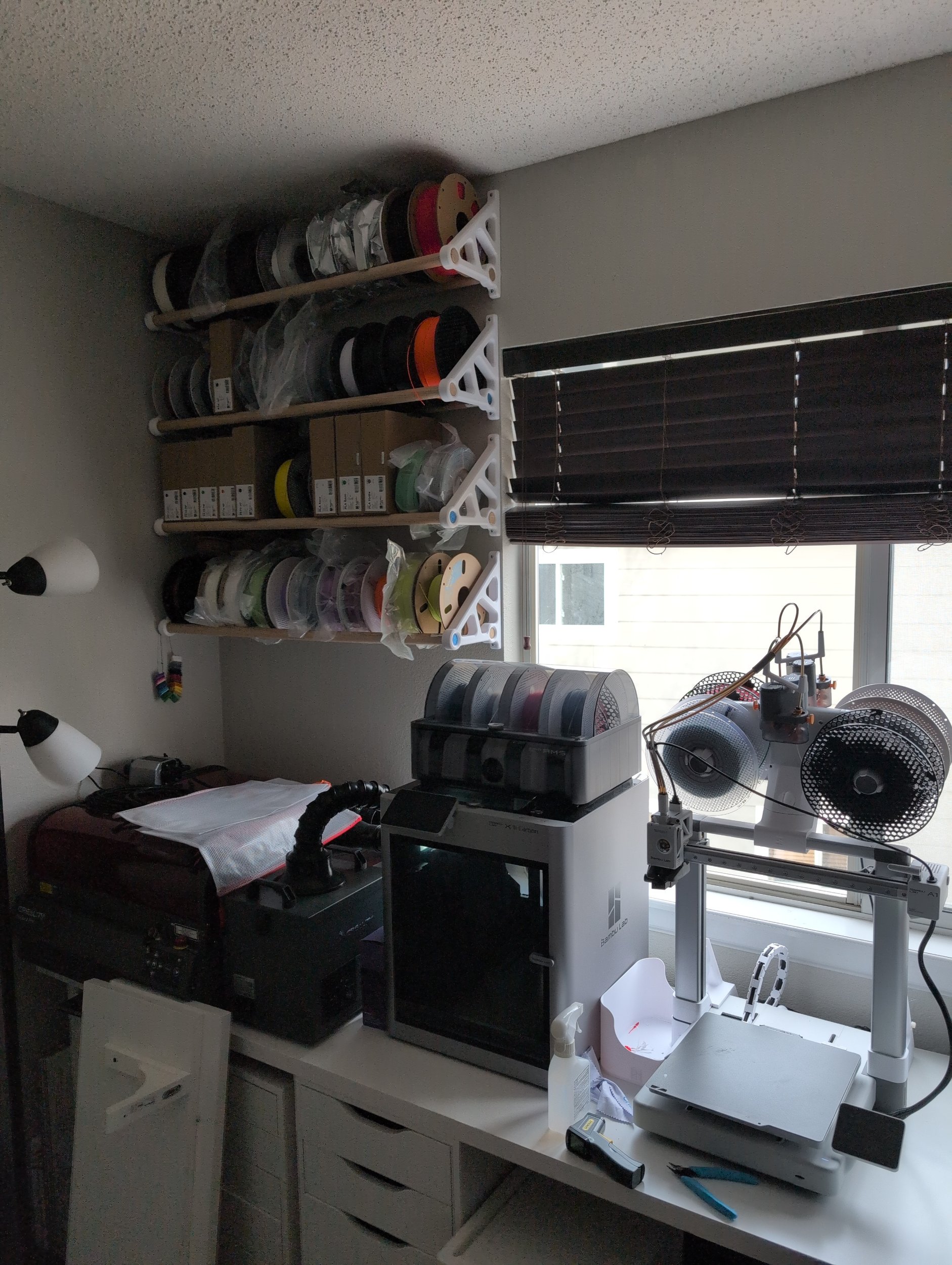

You have a link for your spool racks?
Is PLA adequate for the seat bushings?
No, PLA isn't going to work for this. It's too soft and would eventually just deform on a moderately warm day. I have some more exotic filaments I'd use.
Here's the rack I used, it's fine for what it is. I think I used PETG.
I've not needed them yet, but I'll check my seats. But I'd probably just consider them a wear item
I ask as someone was selling these printed in some form of nylon (I think), but I don't believe they lasted long once installed based on reviews. No personal experience with them, I just went with the Summit kit for the price.
I ask as someone was selling these printed in some form of nylon (I think), but I don't believe they lasted long once installed base on reviews. No personal experience with them, I just went with the Summit kit for the price.
I don’t know that I need them but figured if I did it’d be nice to know what to print them with.
I might make a later version of my tail light housings in PPA-CF (but it ain't cheap), also nylon but maybe better? https://us.store.bambulab.com/products/ppa-cf
I'd be interested to hear/see how you make out. I grabbed a roll of that when they were having their filament sale but haven't had any projects since that would make good use of it. It feels like a material I don't want to waste... 😀

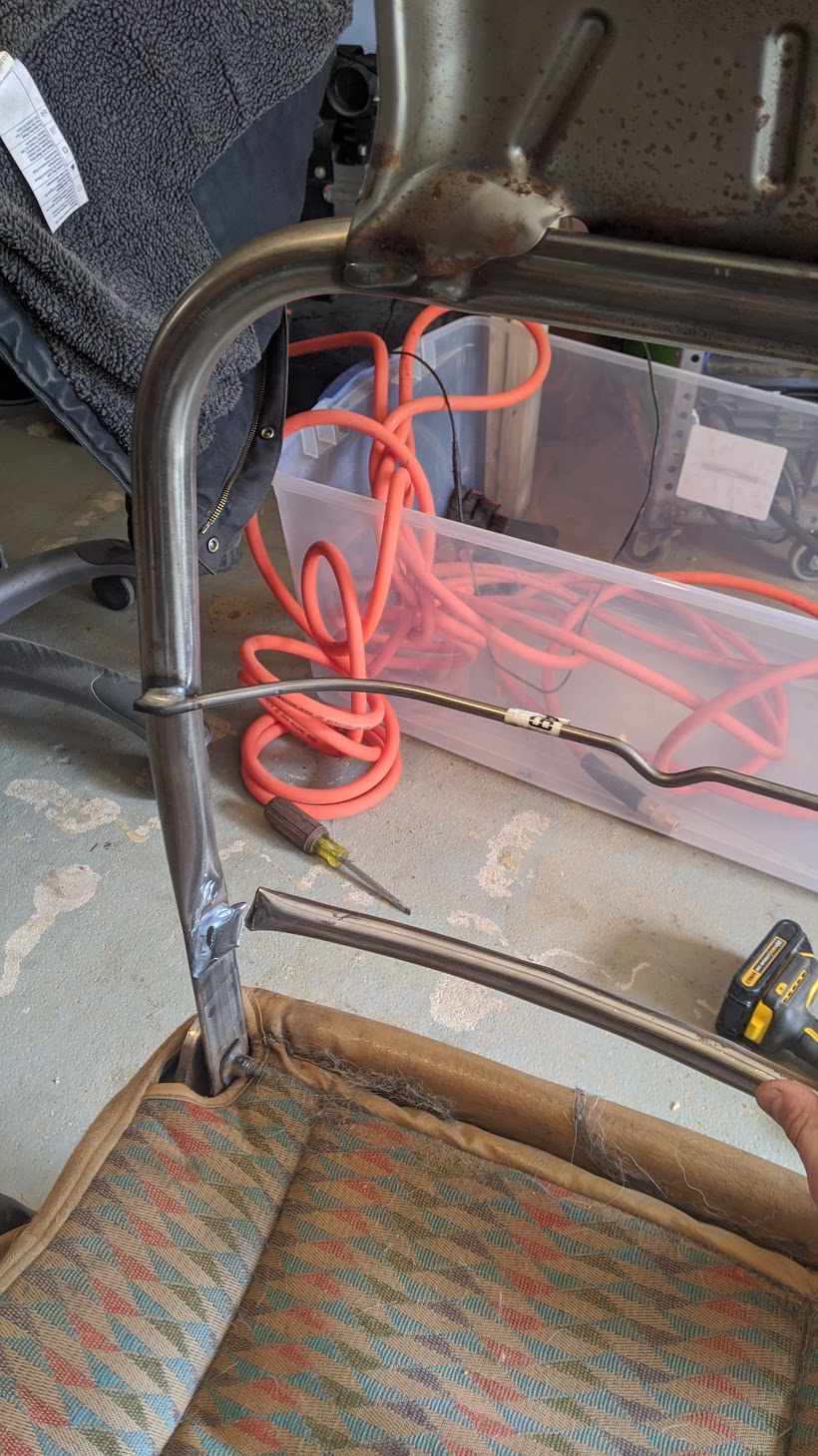

My fat butt definitely did a number on the bottom one. Torn, and all the old foam was noticeably more spongy and deteriorating as you touched it.
I think I also found out why the trip to Moab always ruins my back...

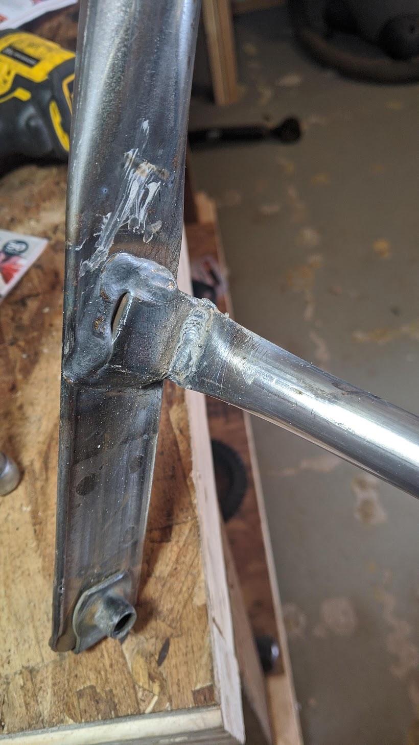

Got that puppy welded back up. Flux core welds are so ugly I really need to buy gas one of these days...

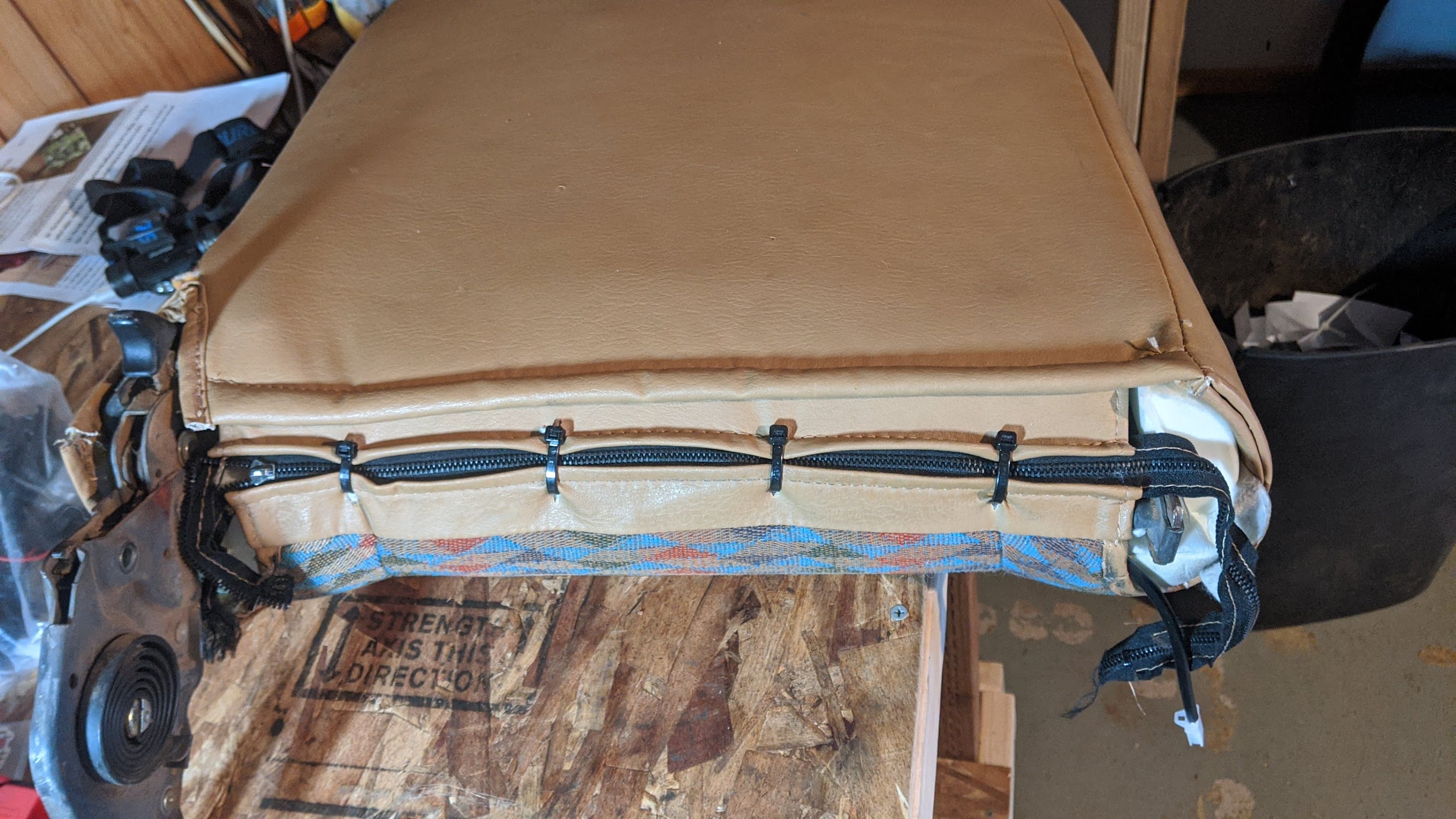

I was having trouble zipping the fabric on the back part of the seat and really didn't want to tear the zipper, so I stitched it together with zip-ties first to put less pressure on the 25yo zipper.
You can't see them with it put back together so they'll just stay there.
