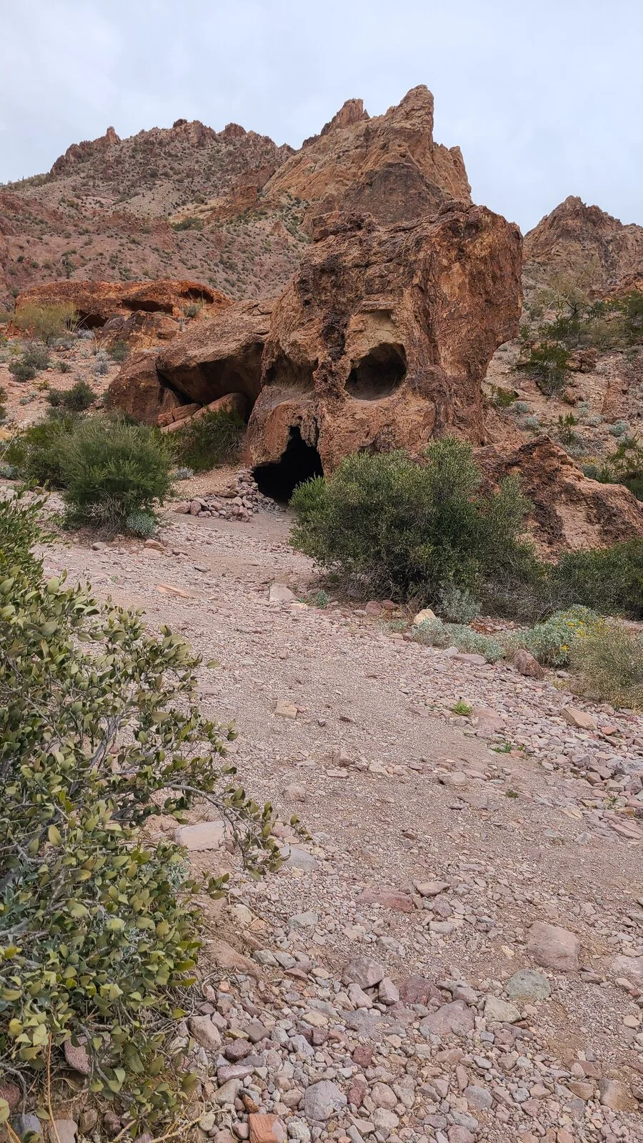

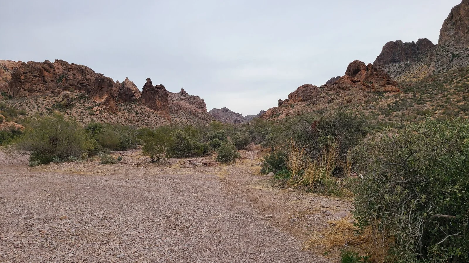

So I air'd down to 20 psi, and went down a very rocky road to Skull Rock ( Google it )
I had a blast bouncing down the trail.

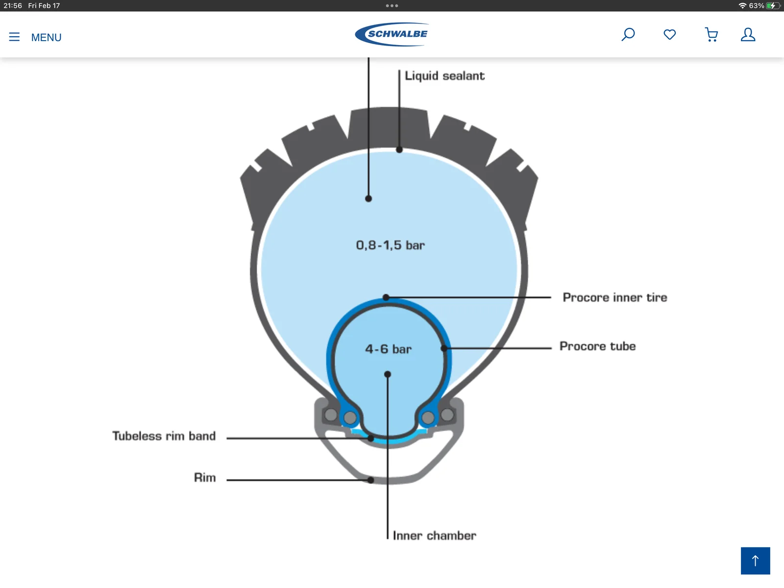

They don’t put bead lock on mountain bikes?
Actually, you can. Same idea as Coyote inflatable bead locks you can get for a Jeep wheel. Mostly used for downhill bikes. Here’s a cross section of one (Schwalbe pro core, in this case):
I Figured my dirt bike has bead locks on it. I figured a mountain bike would. I can definitely see it on a downhill bike.
