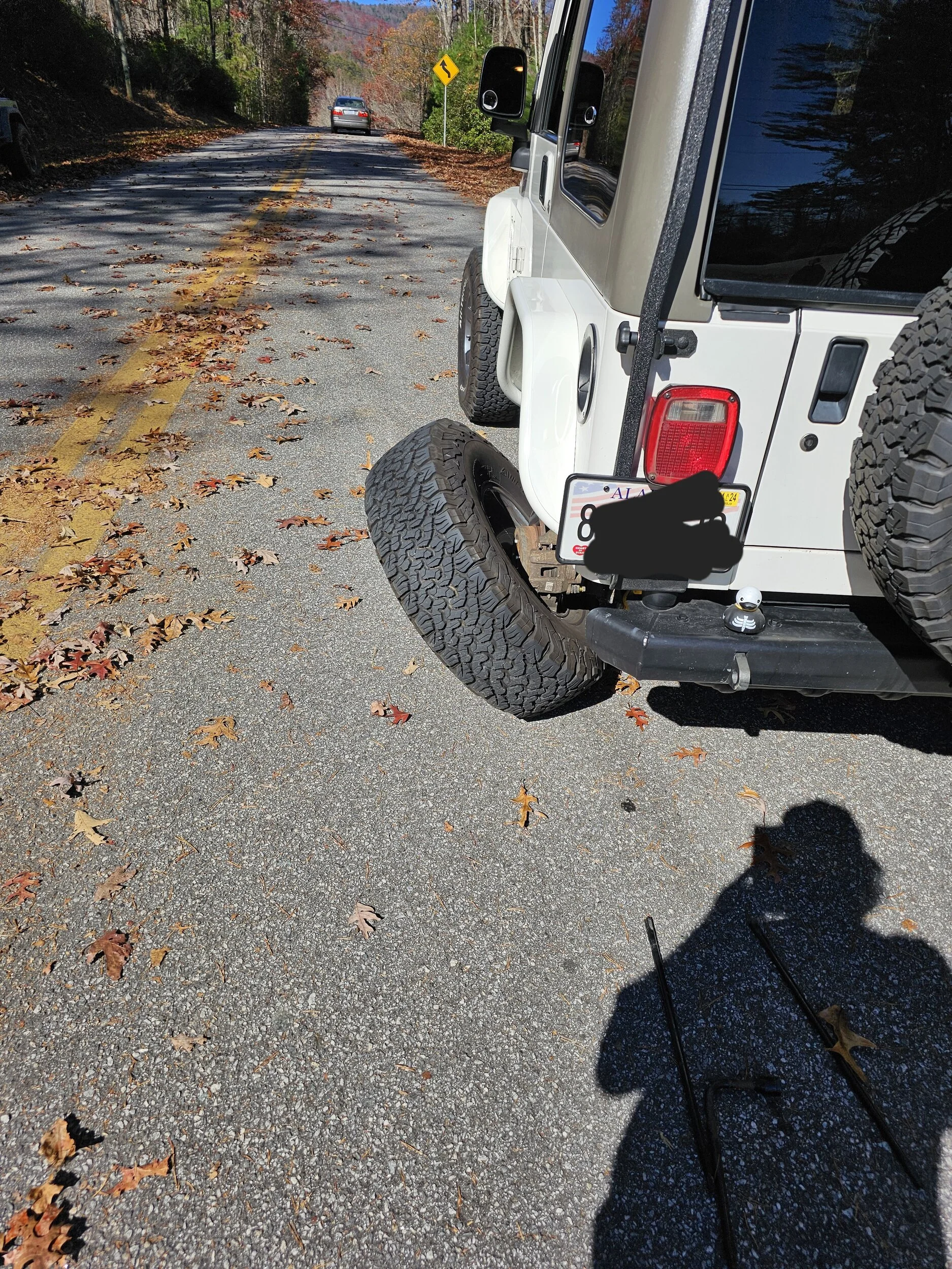

About 10 PSI here and I lost a bead twice in one day...

Okay, simply air up to reseat the bead. I assume you have to raise it?
I haven’t done lots of tire work, but I have had some really stubborn beads to seat, and that’s with them on a tire machine. I’m not being skeptical of what you guys are saying, but just want to hear more.
Edit: Let me add for reference during discussion, that I am running 35 12.50-15. Mickey Thompson Baja MTZ p3’s on what I think are 8” wheels, but they might be 10”.
Raise the tire off the ground.
Wipe any debris off the bead.
Attach the air hose and turn on the compressor.
Sit on the ground
Reach behind the tire with your hands and feet.
Pull outward to seat the bead.
Once seated and any air gaps are closed, the tire will inflate enough to let go.
Keep inflating until the bead pops into place.
We have done this a dozen times across multiple vehicles and it always works.
