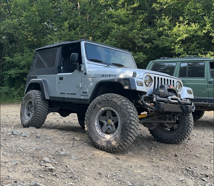

Hello and thank you for the help!
I'm looking to get some new wheels and tires for my LJ. 2006 Jeep LJ Rubicon, 4" procomp lift? I put a question mark there because that's my guess, i run 33's currently and it clears them with plenty of extra room.
Plan is to add a 1" body lift, then upgrade to 35" tires. Yes I plan to re-gear...but I'm not in a hurry and want to put on the new shoes first.
I'm looking at Fuel Anza beadlocks (simulated). I'd like to run a 35x12.5 mud terrain.
What backspacing should I be looking for?
Aside from needing to re-gear, anything else I'm not considering?
Thank you!

Running 35’s is no joke.
https://wranglertjforum.com/threads/so-you-want-to-run-35-tires-on-your-tj.2428/post-29070
You’d want a 17x8” wheel with 3.75-4” BS.

Ok, PSRivats and other contributors. Thank you all!
Looking at Black Rhino Primm wheels in a 17x9, with a -18MM offset and 4.75" of backspacing. I would run these with a BFG Mud Terrain in 35x12.5.
I don't want them to stick out like crazy?
Am I going to cause myself steering issues with Scrub radius? i don't want to have to run a hydro assist.
Thank you!

I ran 17x9 -18mm and 4.75" backspacing Method Race Wheels for a long time.
I ran 12.5" 33 BFGs with factory fenders and didn’t rub.
I then ran the same wheels and 35" 12.5-wide BFGs with highlines and only rubbed on my front sway bar.
I had a 2" lift on both setups.
The scrub radius was fine, and the steering was fine, but definitely check for premature wear periodically. I'm not quite positive about 35s with factory fenders and also don't know how much lift you have. Hopefully this helped but I'm sure someone with that exact set up can comment
