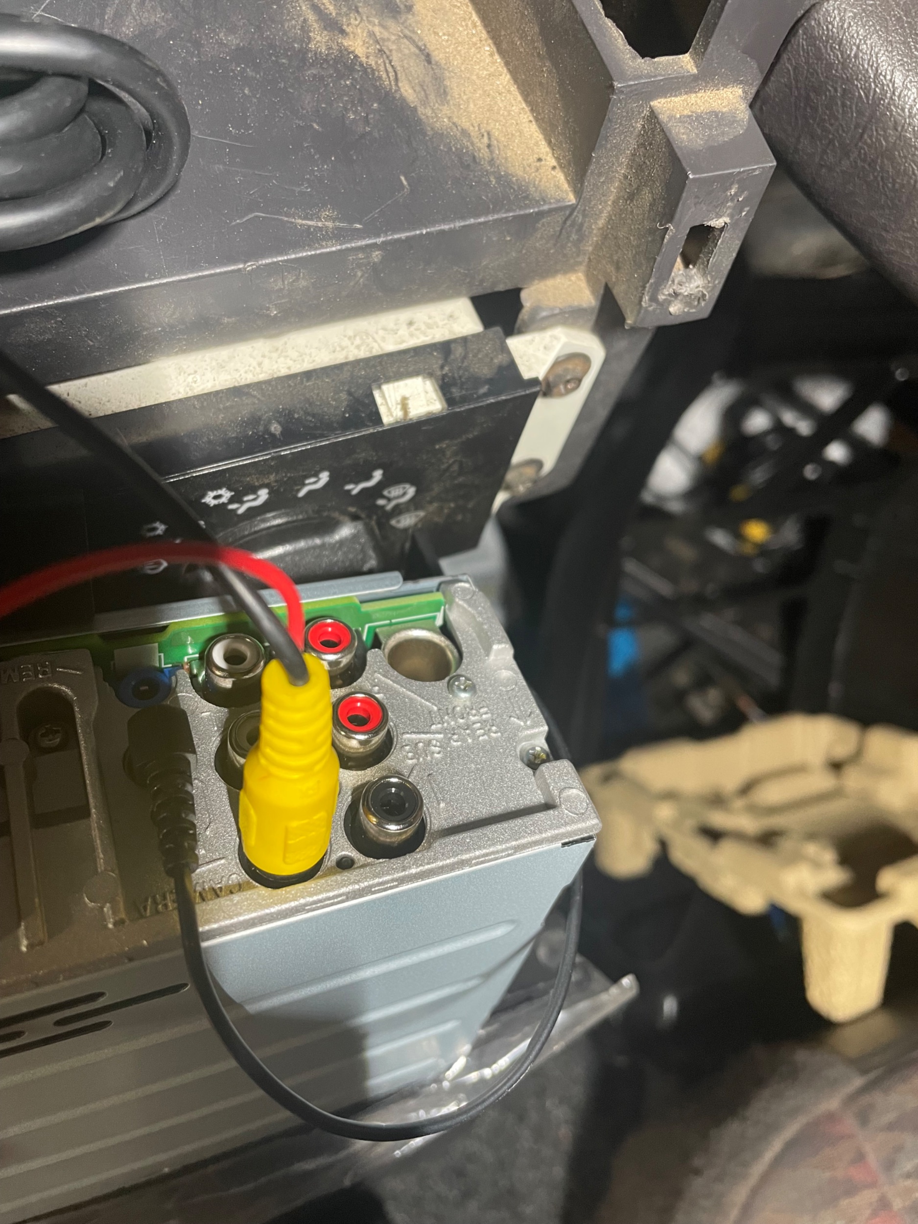

So I’ve been trying to get this thing right for the last day and a half. I’ve read and watched way too much for this thing not to work. The wiring harness for the camera has 3 total red (+) trigger wires and a (-).
The one closest to the radio, I went ahead and married it to the reverse in wire and plugged the yellow into the camera input. Easy.
The other 2 (+) wires, I have tried to wire just 1 to the reverse trigger wire 12v+ directly to the backup wire (purple/black) and left the middle one capped. DIDNT WORK. I then tied both (+) wires together and spliced them into the reverse trigger wire(purple/black).
The ground wire, hooked it behind the a bolt that holds the tailgate housing to body, fastened with a nut. Blew the fuse. Replaced and put the ground to an easy access spot in a license plate bolt. In doing so, I was able to atleast get the radio to shut off when putting in reverse but still no picture and when put back in P, radio comes back on.

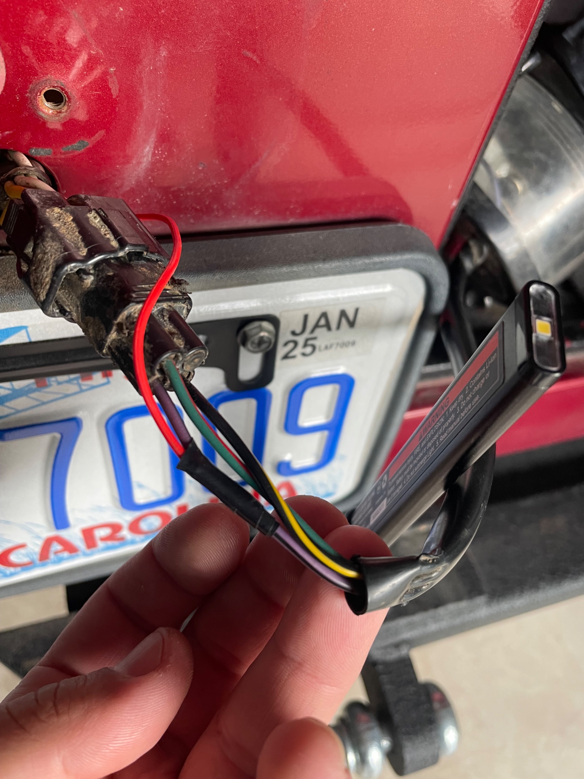

When I remove the one red 12v(+) coming from the yellow in the 2nd picture, Nothing happens. When I reattach it, the screen goes black in R. I feel it’s almost there but still unsure what the hell is going on. Maybe it’s a faulty camera…

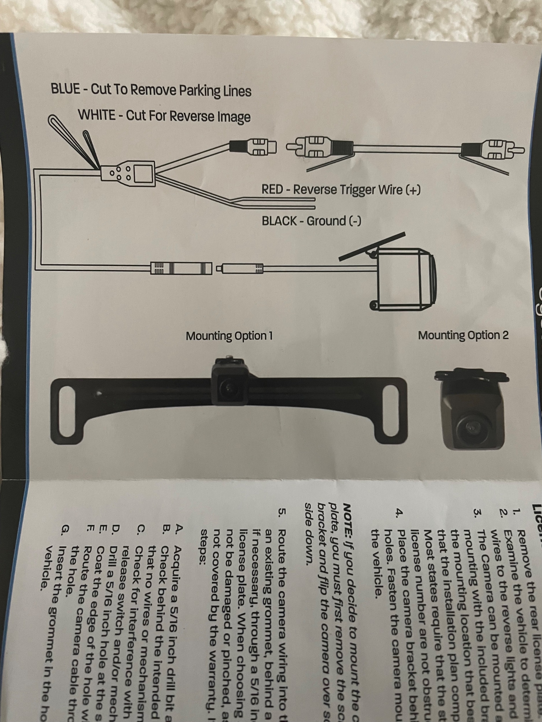

The diagram you posted doesn't show where the reds go...but it does show where one of them goes - backup switch. The other look like they are unused.
White wire- says to cut it to see image...you did not cut it. It is still a loop in your picture.
Blue wire - cut iti f you do not want to see the guide lines
Red wires- the one closet to the radio is not the one to use for the reverse trigger. Use the furthest.
Take a break and follow the drawing in the manual.

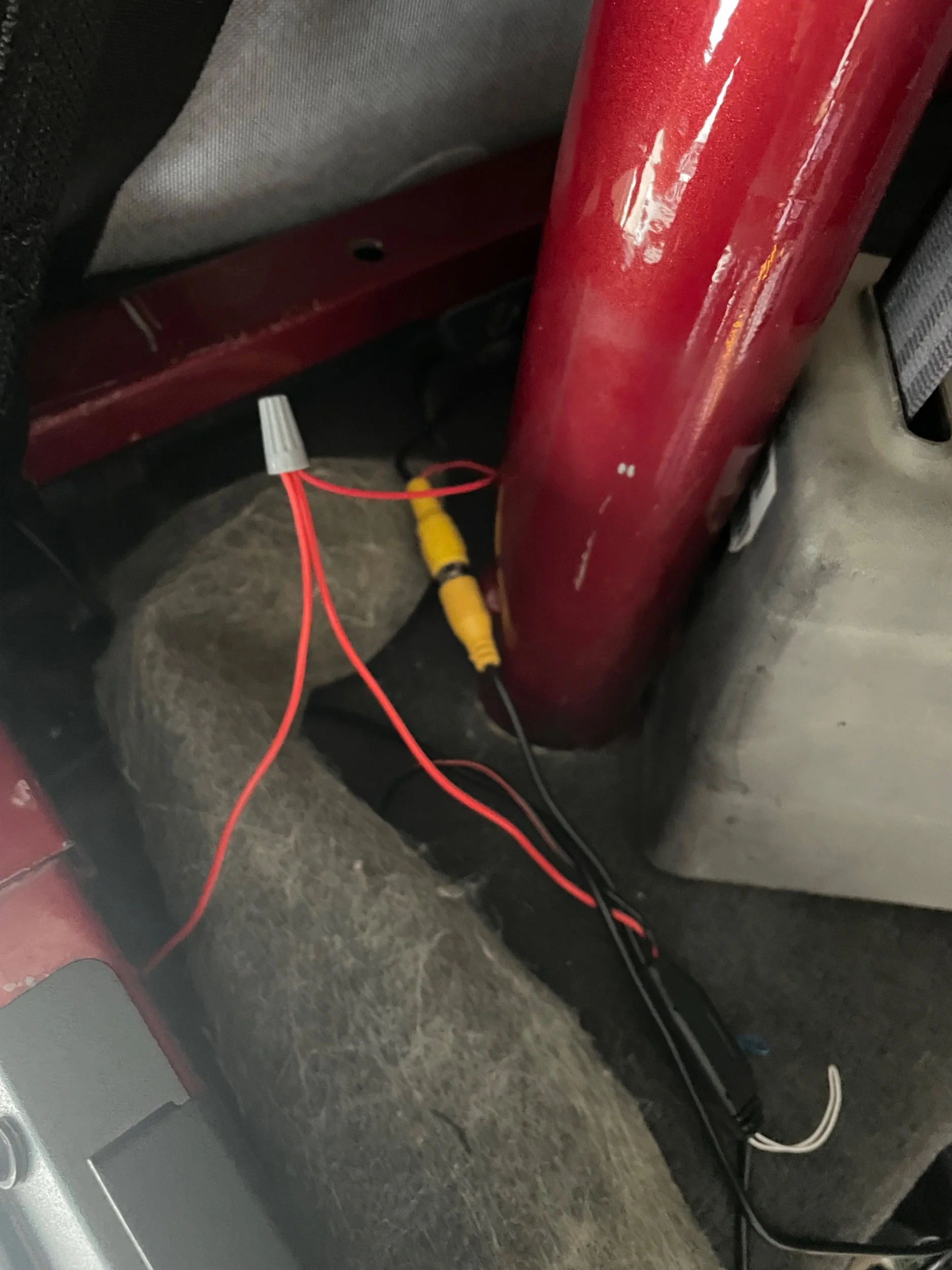

In your pic right above the one with the manual...you have 3 red wires nutted together...that is not what is shown in the manual diagram. Only the one red wire coming from the black plastic blob where the white wire is is used.

So I ended up cutting the red wire in half that would have led to the backup trigger wire, and just butted them together with a nut. So essentially it’s 2, the red coming from the yellow and the one I cut in half.
Disconnect the one from the yellow and connect the one from the blob to reverse
Is your black grounded? The black wire adjacent to the red wire from the blob. Are you sure you have good ground?

Got some good news. Decided to get another camera (meta) from the local Best Buy, I had no more patience to wait for another Amazon package lol. Anyway, it works. It only has 2 trigger wires, one for the back of the radio and one for the reverse light. Tied both this in just like I had the old one, and it worked. Need to get the other one back to the Amazon seller. Thanks again for reading and helping me out gents.
