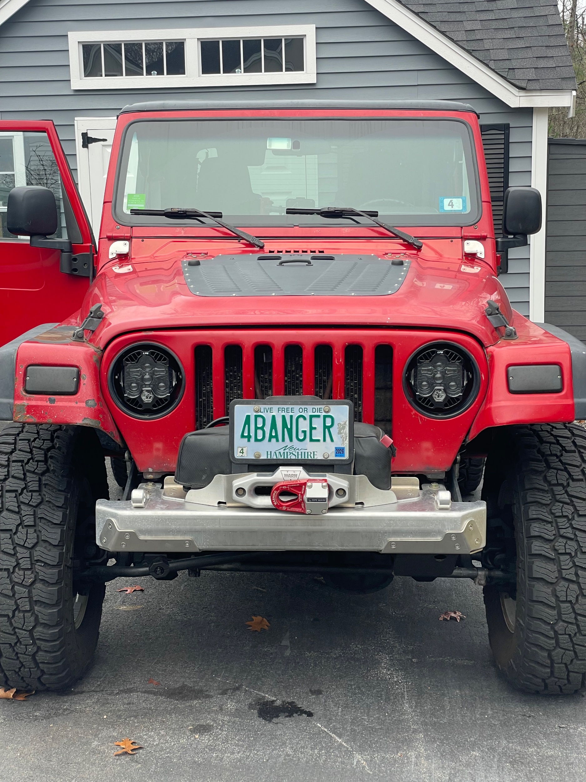

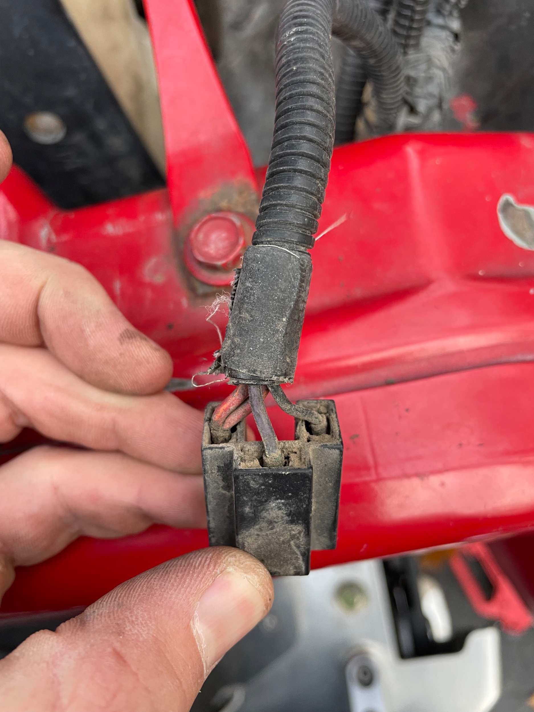

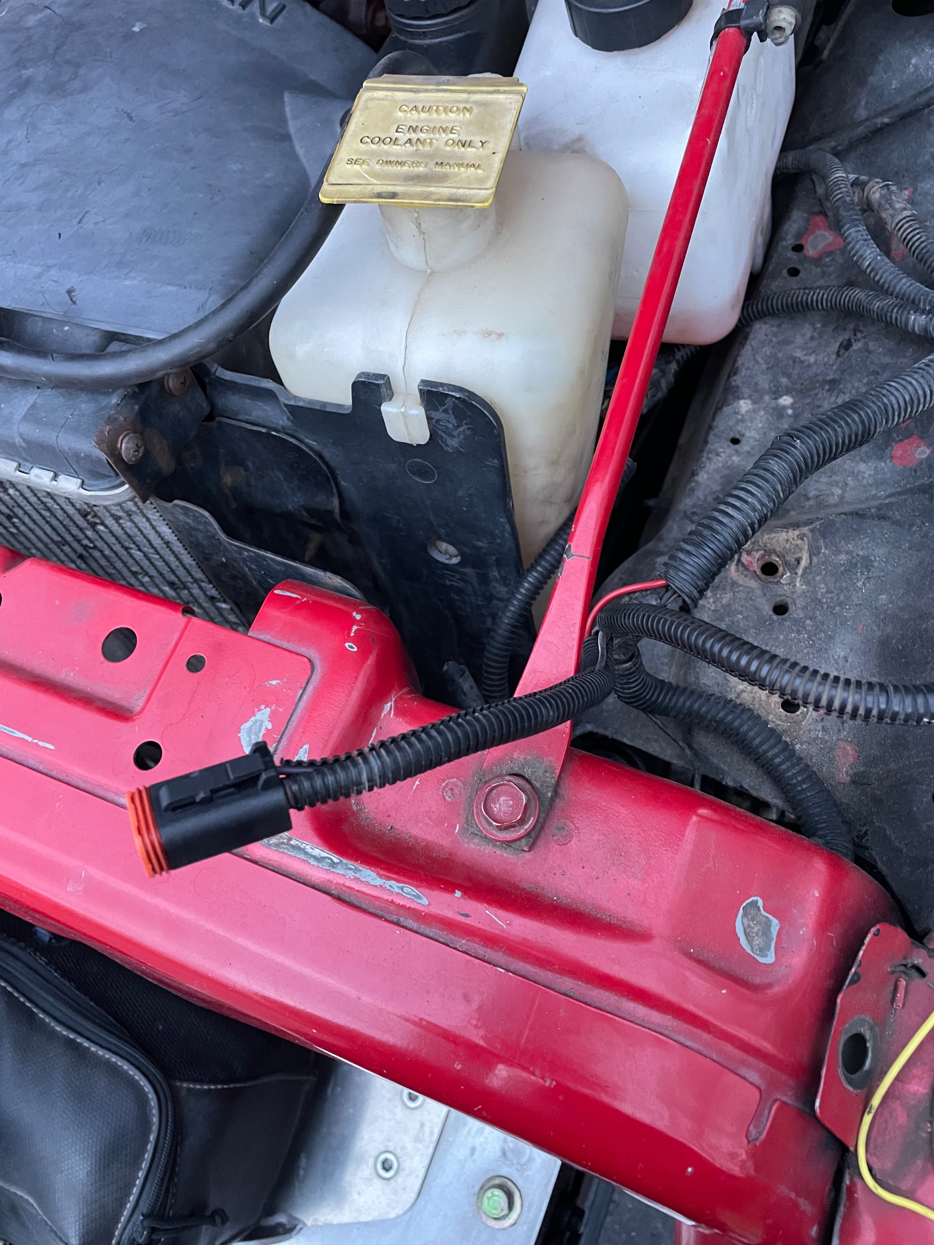

My high beams were green/white to red, low beams were white/green to white, and ground was black to black. (this was before I cut the old plug off).
My running lights were white/yellow in the harness on the inner fender that feeds to the running lights on the fender/flare. I remembered that from doing the led conversion.

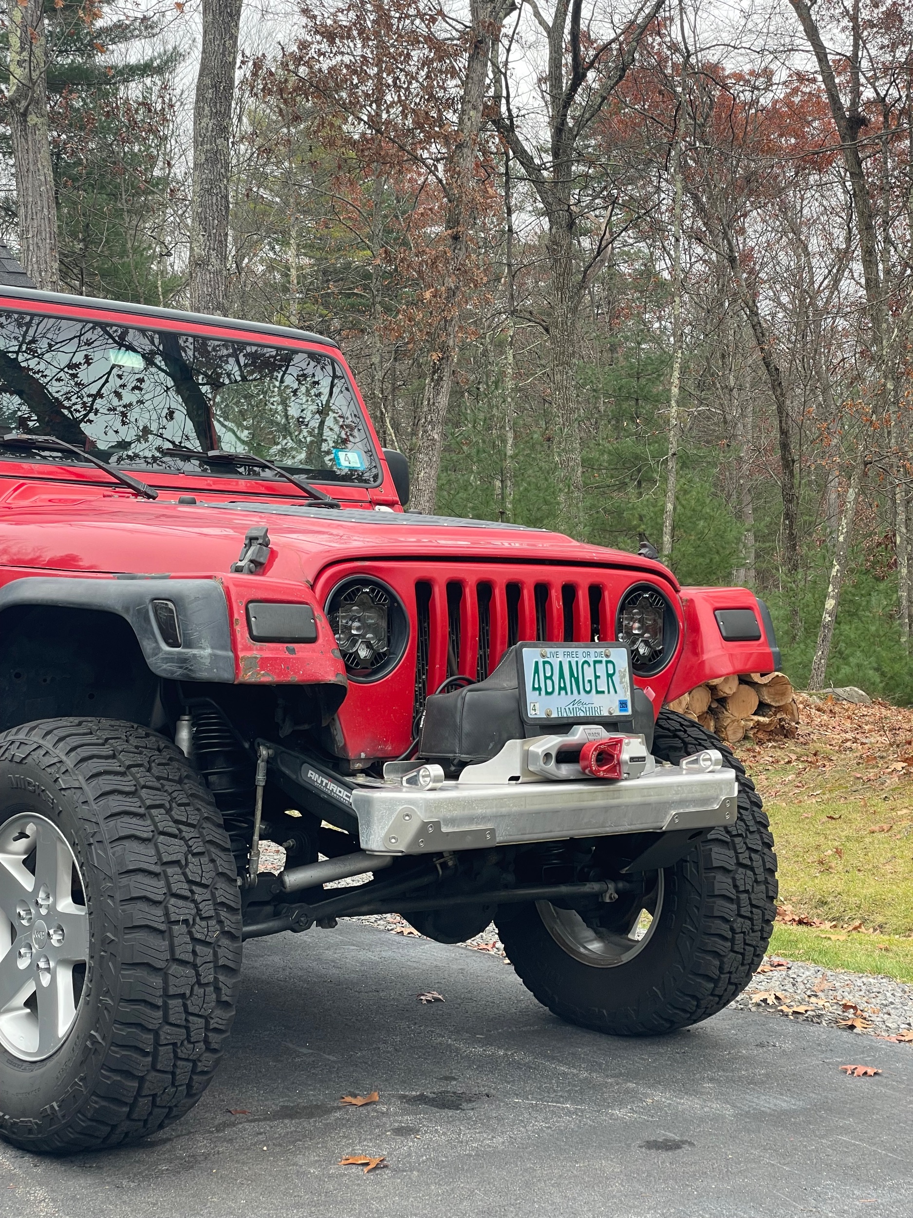

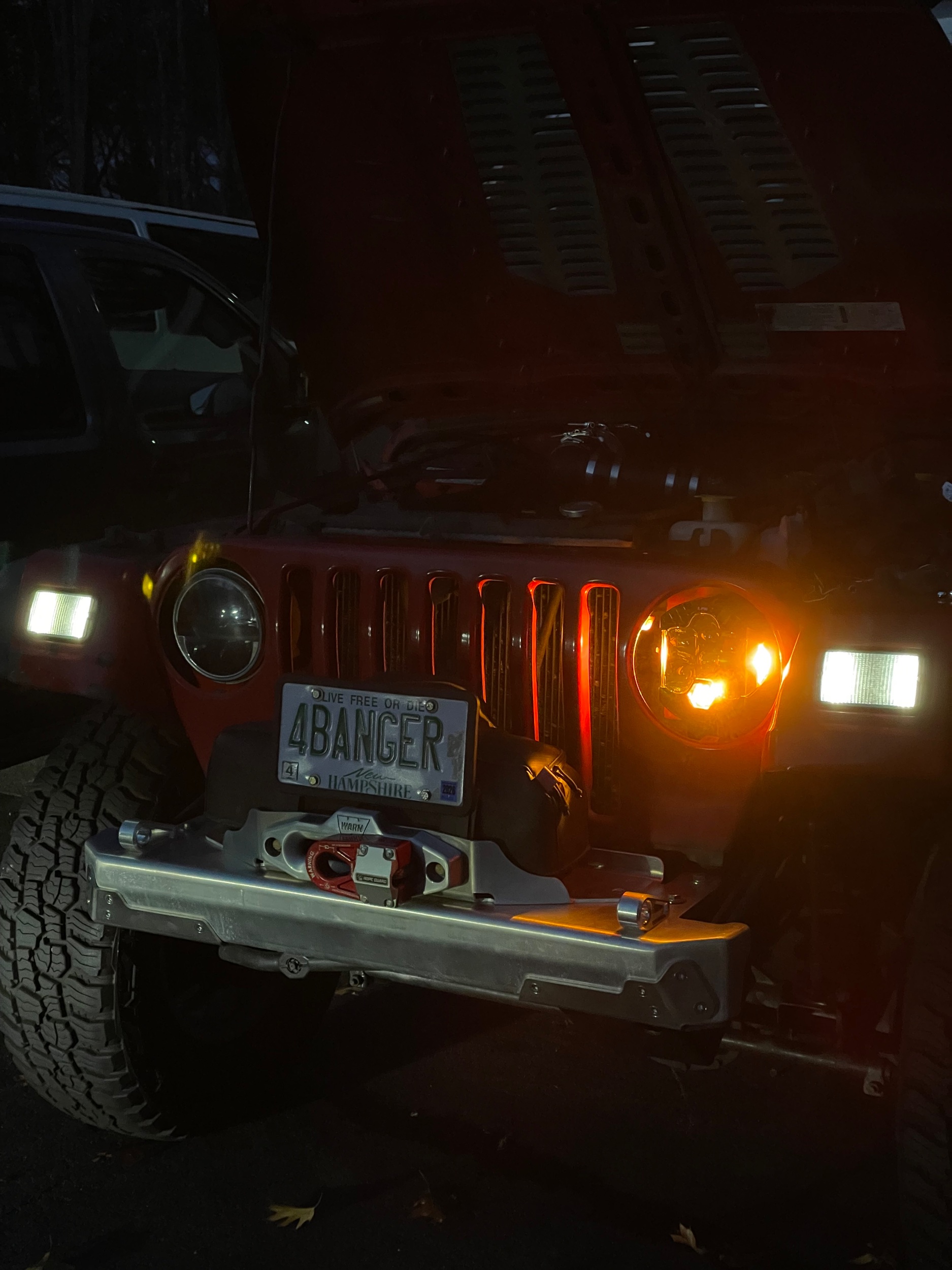

All buttoned up on the driver side.
I needed to drill out multiple holes but it wasn’t a big deal.

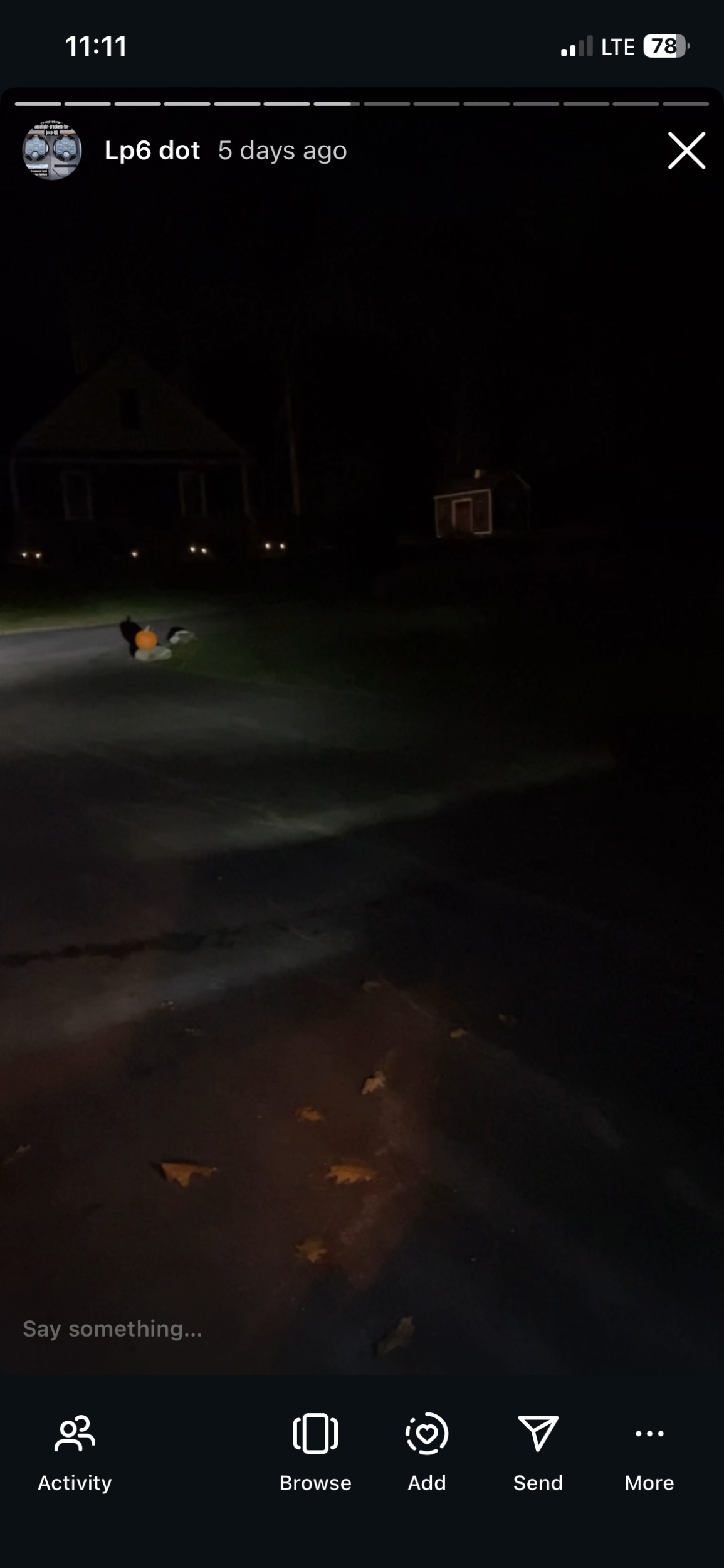

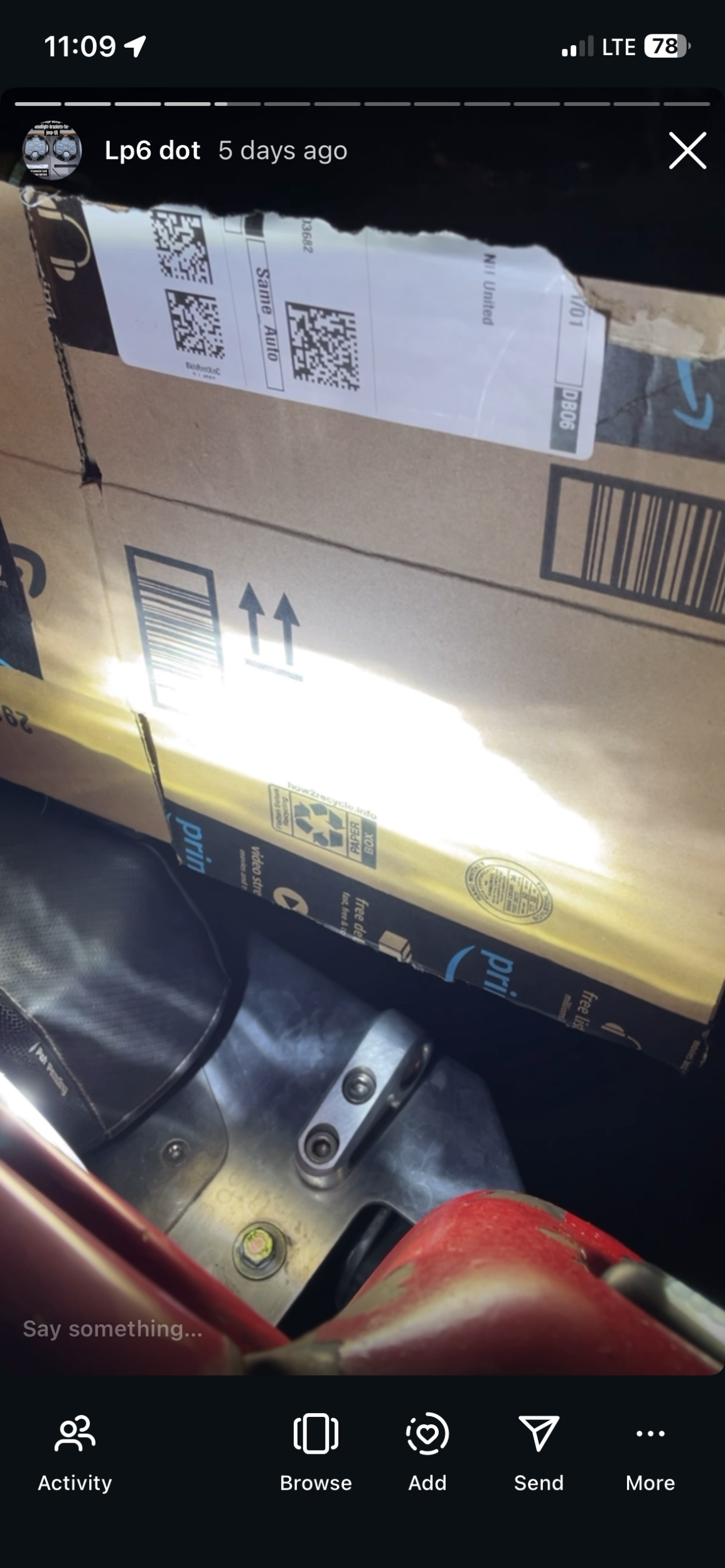

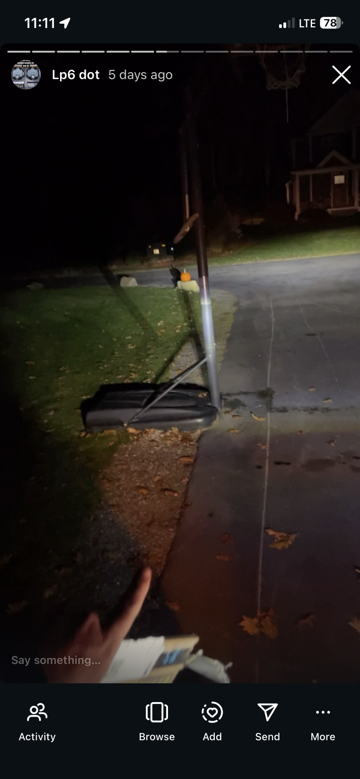

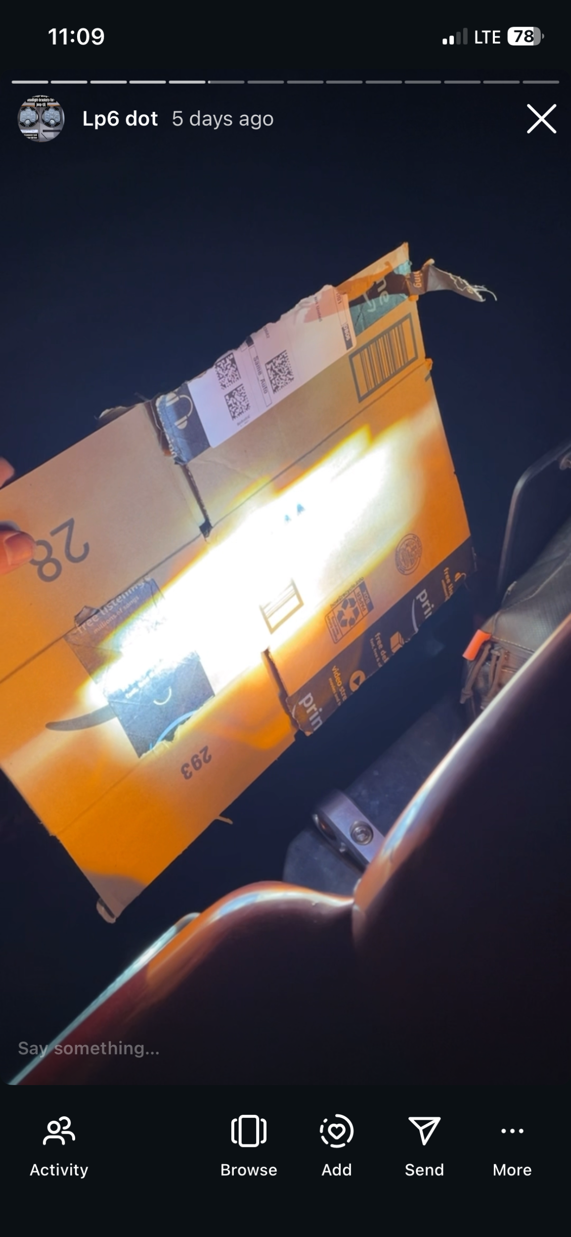

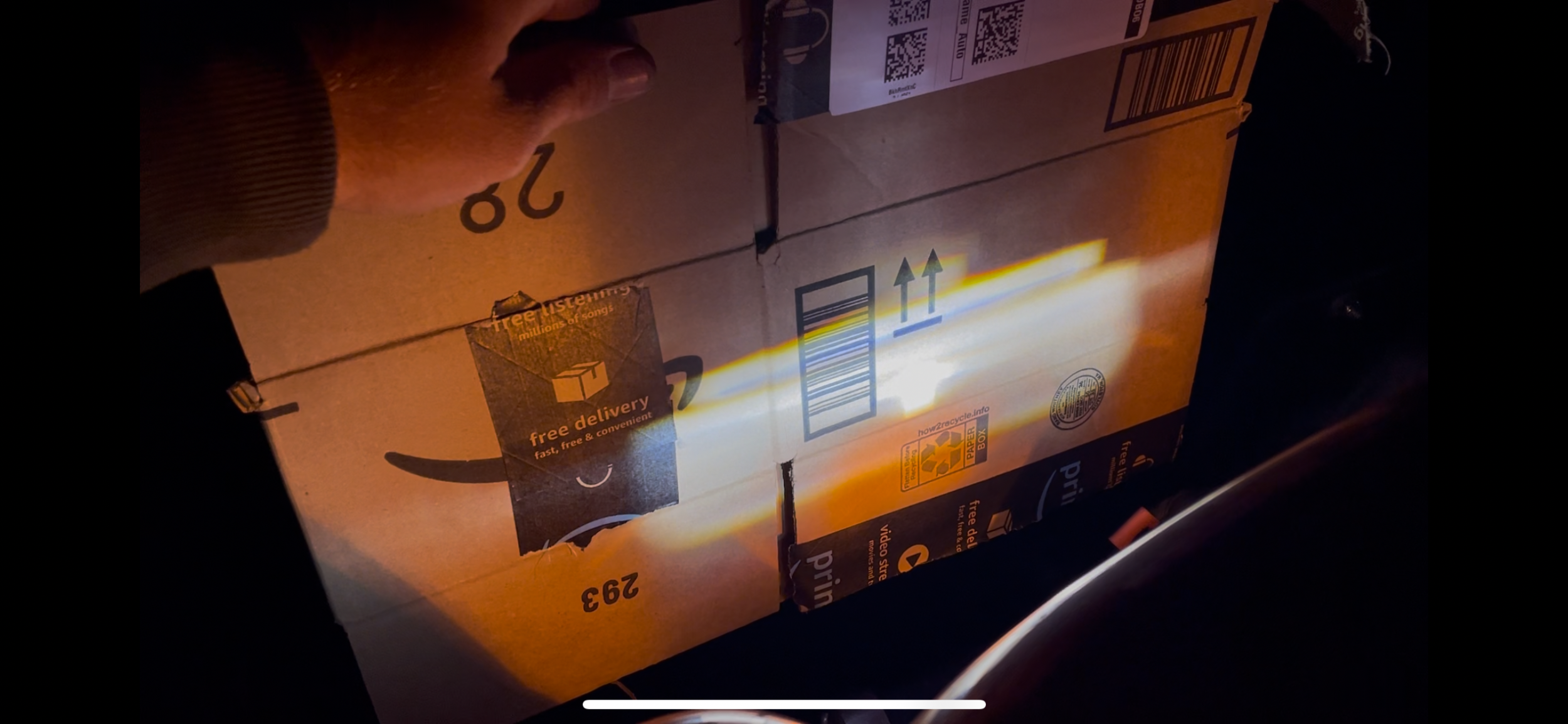

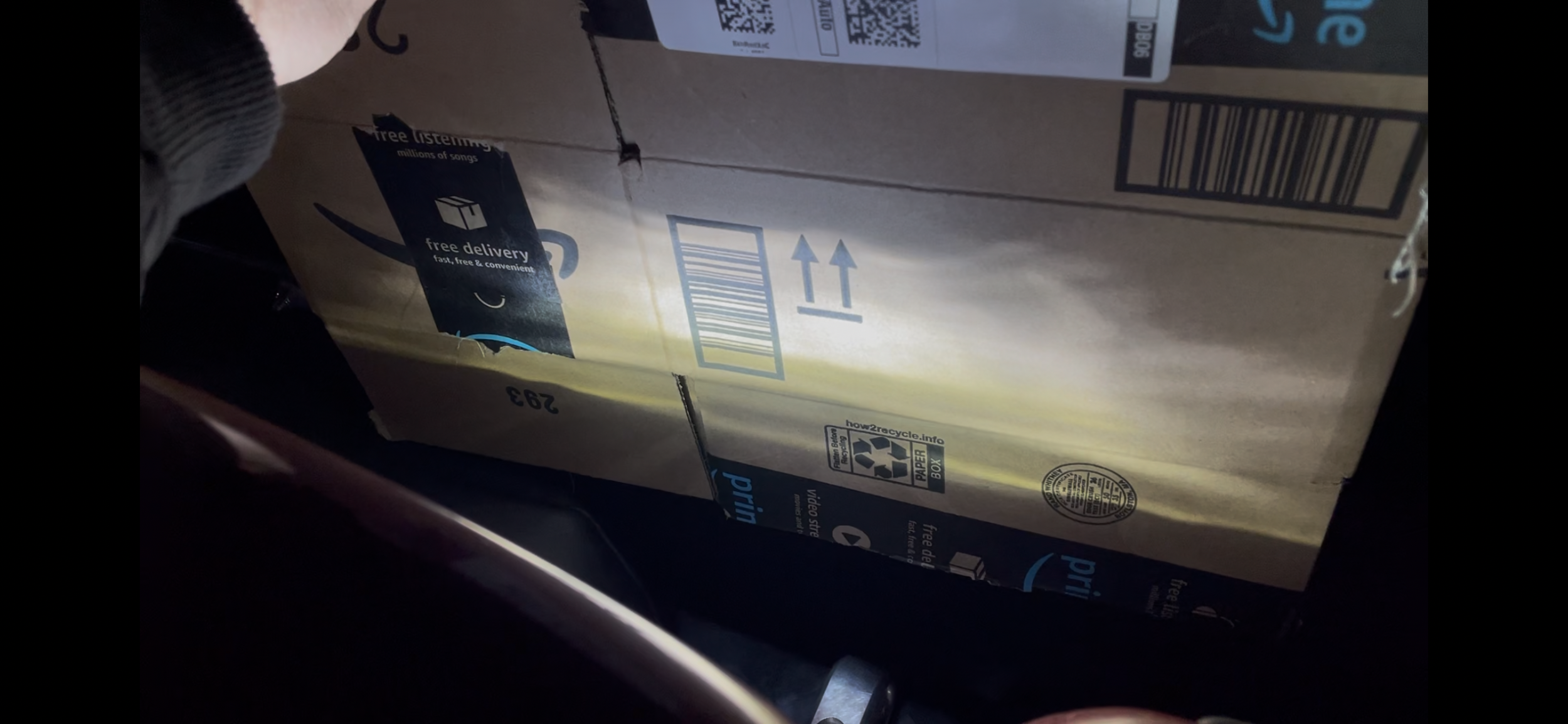

I’ll need to dial in the beam height tonight and then re-install the bezels.

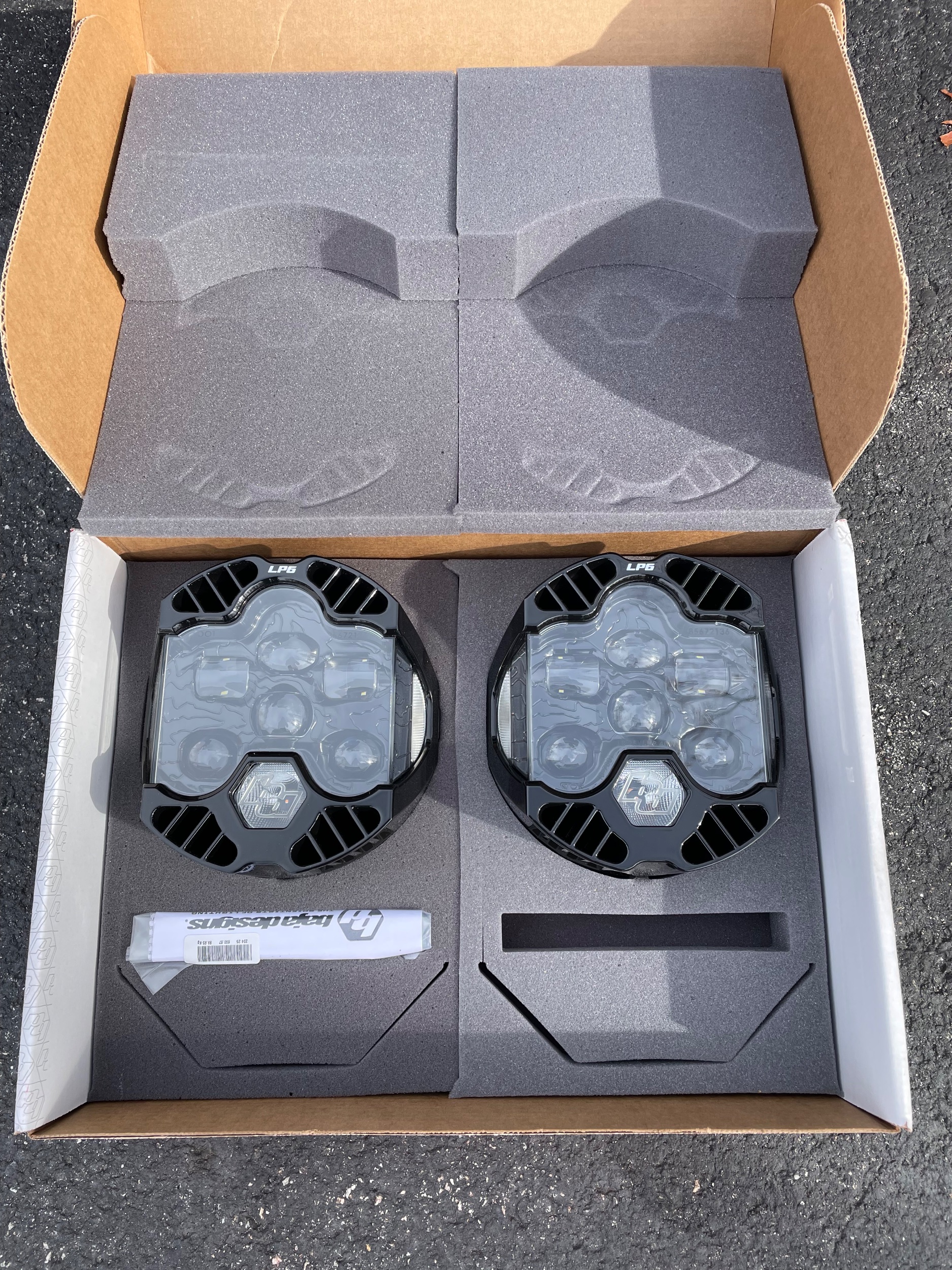

I’ve been needing better lighting and only want a black housing, so I appreciate @The4bangertj for sharing his install and fielding my questions about his purchase and install.
Below are some additional photos.
